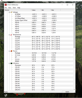

also, since i've still gotta do homework on this slow-a*s thing, i figured id see what gaming is like now:-
fans are dead quiet and cpu wont push any powerand i'm getting what looks like 5 fps. this has happened on a few occasions mid-game and went away by itself, (i'm plugged in rn) but now it's become the norm.
i have two, 2, drives. one per laptop.
i dont have any screwdrivers so a switch is not possible, what in God's green earth is a data drive?

You could use nvidia shadowplay.
When it goes slow again and you're recording it, have taskmanager open sorted by CPU and also have hwmonitor open showing temps and performance tab.
