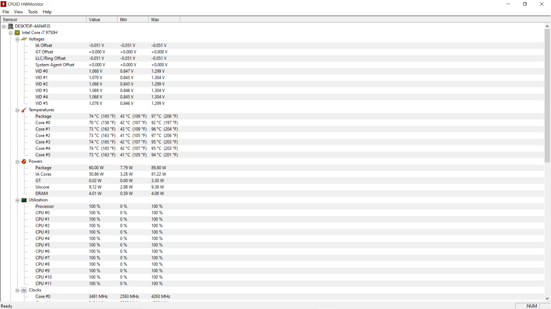

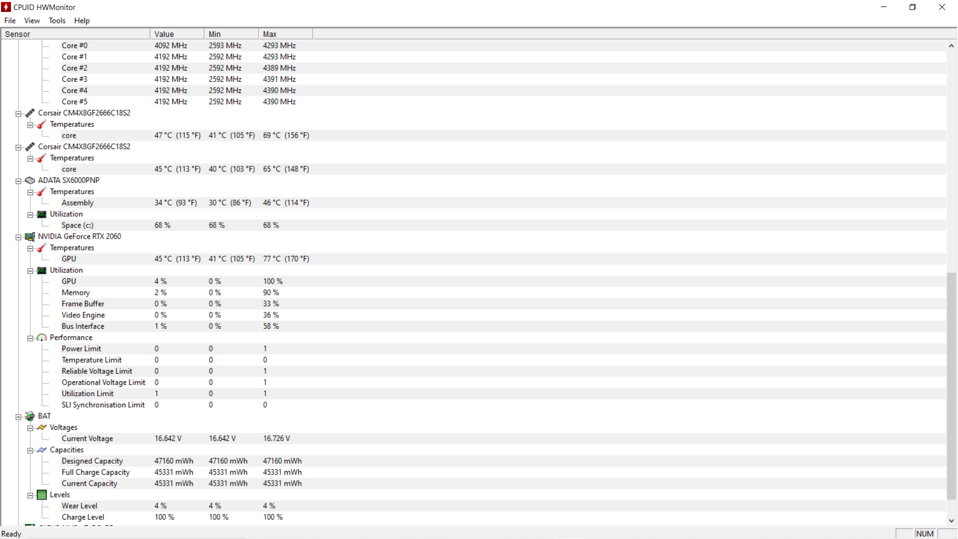

We need a full screenshot of HWMonitor readings during prime 95, don't have chrome open, just prime 95
It will of course be non responsive, it's a torture test on the CPU, there's no available CPU for anything else.

ah i see. how do i get full readings?
Deleted member 94250
it did this instead
eedit: i'll just post two screenshots, the lower half and upper half:-
So that all looks ok.

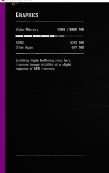

another thing, when i use RTSS and MSI Afterburner when gaming for an OSD performance display, it gives me total nonsense the left side of the screen starts flickering instead of giving me OSD. here is a screenshot:-
There’s nothing wrong with the laptop, your windows is borked, many many things wrong. I would suggest a full malware
