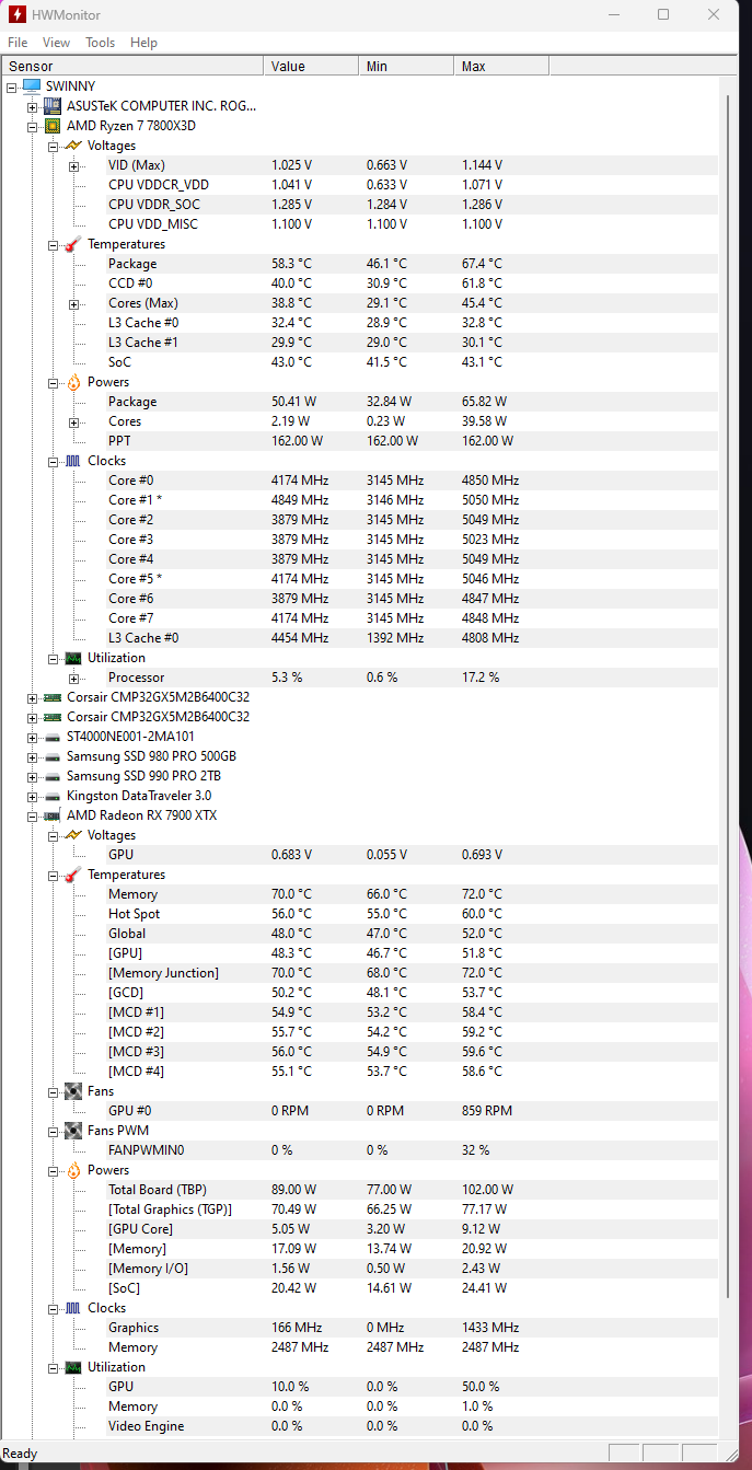

Open HWMonitor and have it off to the side and take a screenshot with the CPU and GPU temps expanded. That gives us our idle temps
Then run furmark for 10 minutes and before you end it, take another screenshot of HWMonitor.
End the test and post screenshots of HWMonitor

Are these settings correct before i run it?
Just realised the seconds are MS so amended to 600k just waiting to see if all this is right prior to setting it off as never used this
No crashes?
Temps look good on cpu and gpu, don’t be put off on the gpu memory temp, that is expected.
So that’s a full 100% load GPU stress so suggests there’s nothing wrong with the gpu.

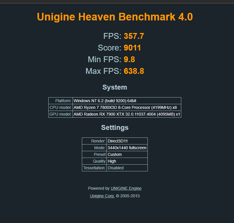

Any particular settings?
Ok ran it on the above settings for around 10 mins then benchmarked it no crashes or anything @SpyderTracks

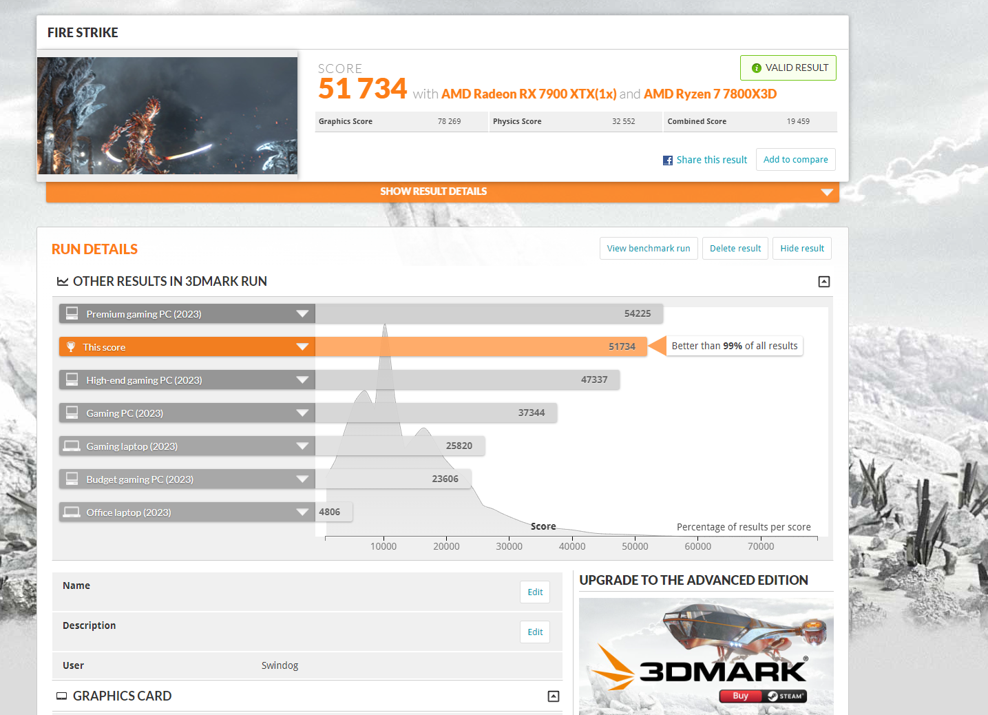

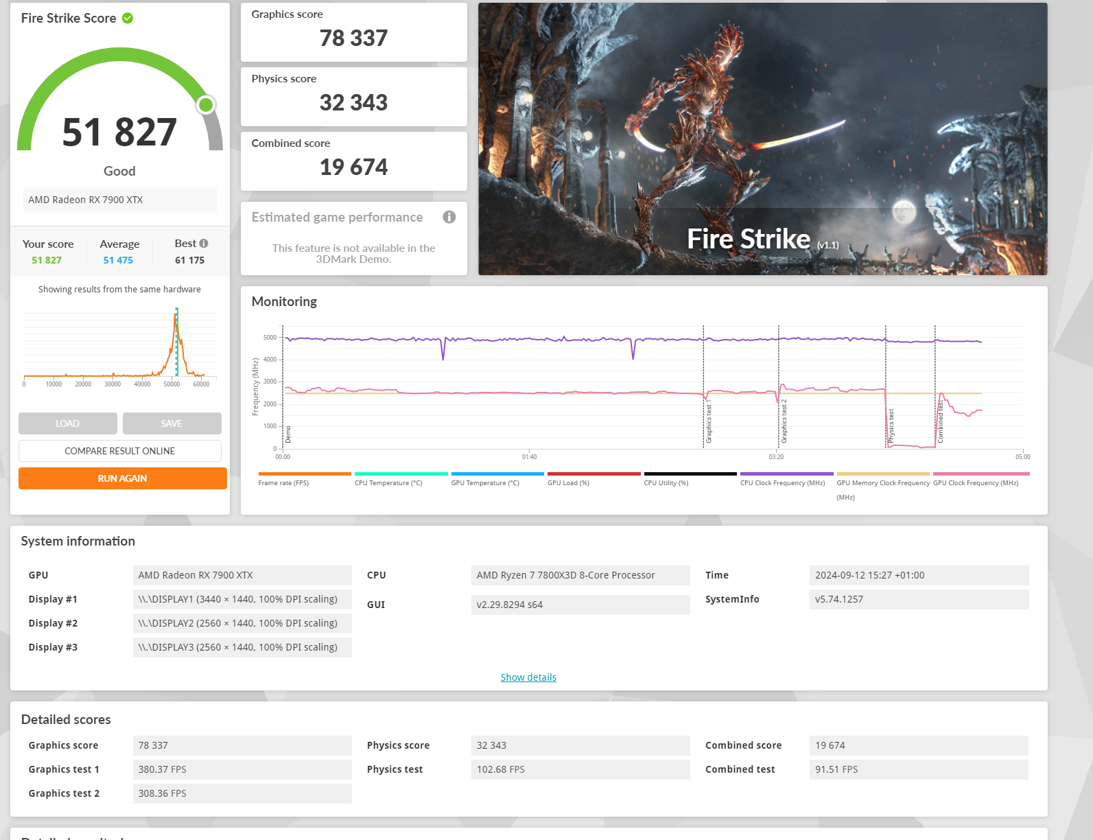

You can also try running Firestrike as a last test
Download 3DMark demo here: https://store.steampowered.com/app/223850/3DMark/
Then install the firestrike benchmark:
Those test combined should give you quite a concise range of gaming scenarios

No worries at all appreciate all of the support
@Scott will be able to decipher this for you, we may be able to improve performance.
