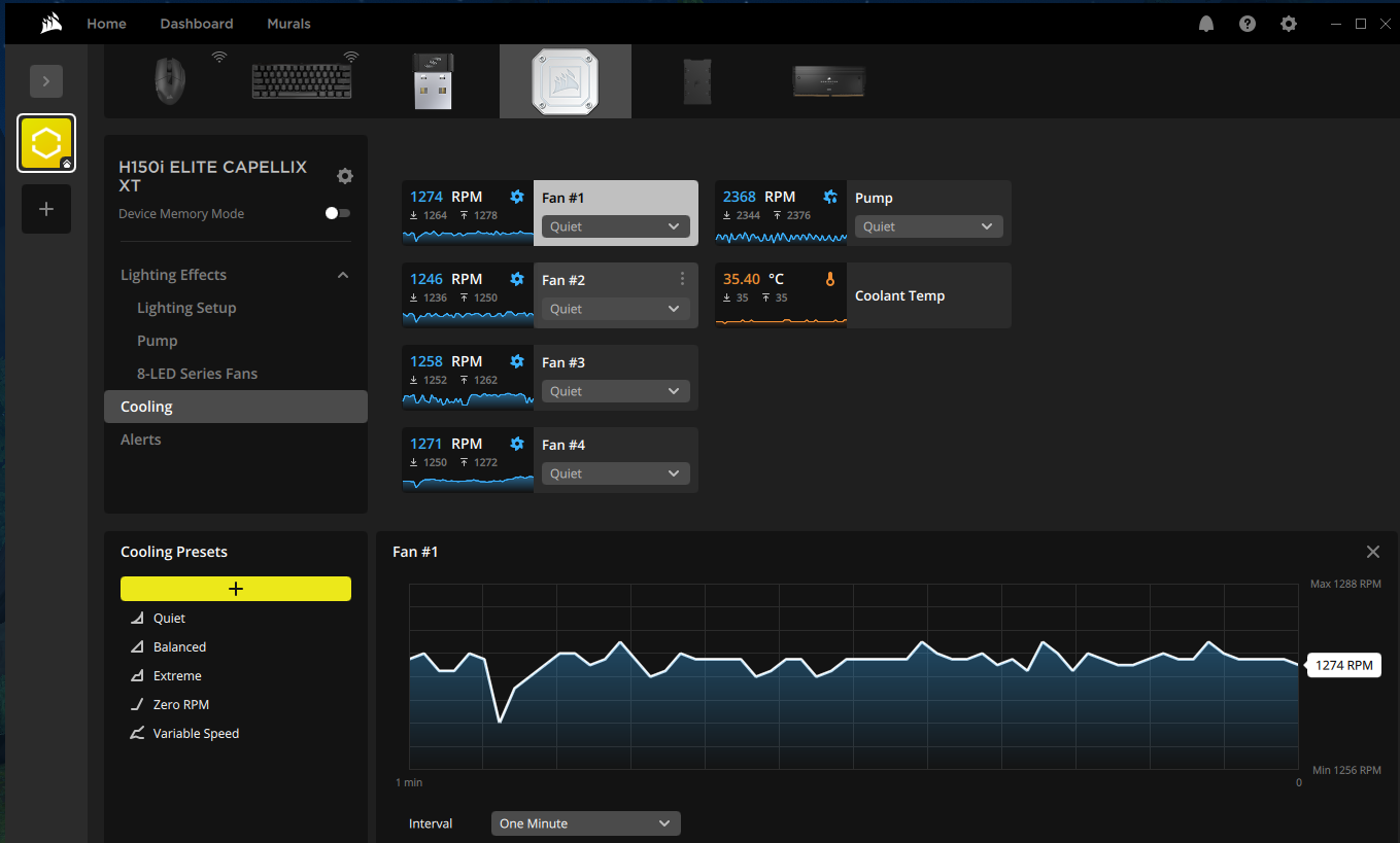

Have you had a look at any of the cooler settings in iCue? I'm wondering if it's maybe running on a silent profile.
It's performing well, don't get me wrong, but I think there's a little bit of average CPU frequency on the table that's temperature related. The 7800X3D is very temperature sensitive so when pushing it with benchmarks etc it's worthwhile giving the cooling the beans.

And this is ICUE
Should this be changed to balanced?

And this is ICUE
I would put it on extreme for a couple of benchmarks, just so that you can see the difference. Day to day I would go with Balanced but I would tend to do my own, as the standard profiles can be a bit choppy with their on/off nature.
Man she loud on extreme lol

Curiously there isn't much change in the temps. There is a little bit, but not the sort of delta I would have expected with the difference in the fans. Balanced is definitely the way to go (or custom) :D
You can see a slight increase in frequency with the fans on extreme, that's what's giving the extra points. Notice that the peak went quite high on one of the runs (5.3Ghz, that's how sensitive the chip is to temps).

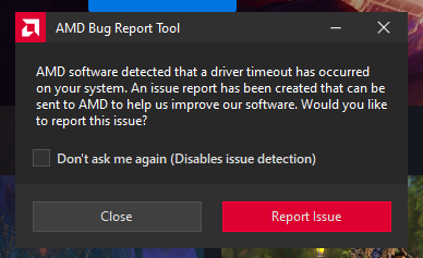

Family friendly forum so I've edited your post, please keep in mind :)
I had a quick google with that there. Apparently there's a "Replay" feature in the Adrenaline software. If you switch that off it may solve the issue. If it doesn't, XMP needs dropped to 6000 IMO.
Swinny
2 hours into wow this morning
apologies I’m just so frustrated which I’m sure you can understand,

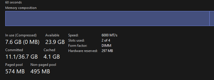

How do I change ram?
Instant replay has always been off
Your RAM is now sitting at 6400Mhz. Not sure why it would be different to the previous runs. That would suggest the issue to me. The CPU still appears to be performing well, the temps spiked a bit more but the avg frequency was still pretty good.
When rebooting the PC if you hit Del it should take you into the BIOS. The initial splash will tell you which button to press but I'm sure it's Del.
Once in there it's typically F7 to enter the more advanced screen. Go to AI tweaker and then set the Memory Frequency to 6000. Save that and come out.
