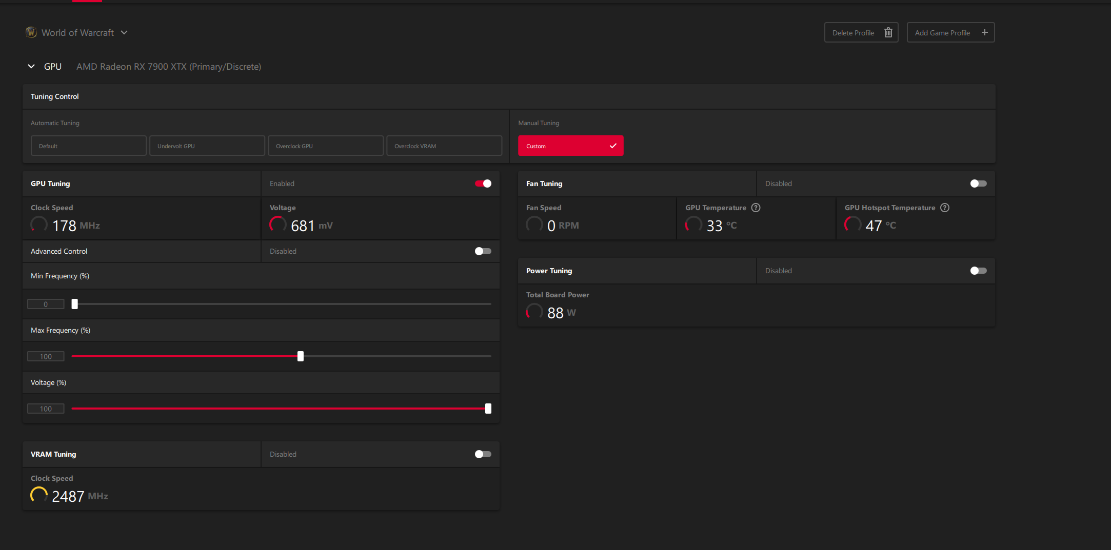

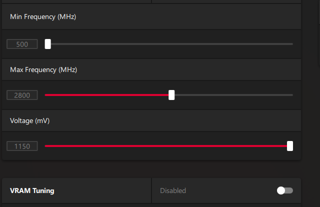

I have also specifically set the max MHz Frequency again of the GPU to 2800 as seen below
Oh, hold on, had you manually maxxed out the frequency and voltage on the AMD driver? That voltage and frequency are far too high for this card, no wonder it's not stable!
You didn't mention you'd manually overclocked it, or was it set like after you'd clean installed adrenalin?
GPU Tuning needs to be disabled for testing, and I'd suggest fully if you're not familiar with how to reach an overclock.

Never touched the settings manually mate wouldn’t know what to begin
These are the standard settings
They're not standard, if you've enabled that section, that's applying an overclock way outside of the graphics cards capabilities. If you set that voltage on the outset there's a very possible chance you've fried the card, there's no guarantee your chip would be capable of that voltage

You’re not following, that is the overclocking section, it’s disabled by default. You haven’t reduced max clocks to 2800, you’ve put a flat out increase from the already overlocked 2615mhz.

As when I went in there to reduce it to 2800 it was at 2975 so what do I need to do please
Swinny
Ok as ix
As already said, that section needs to be left disabled
