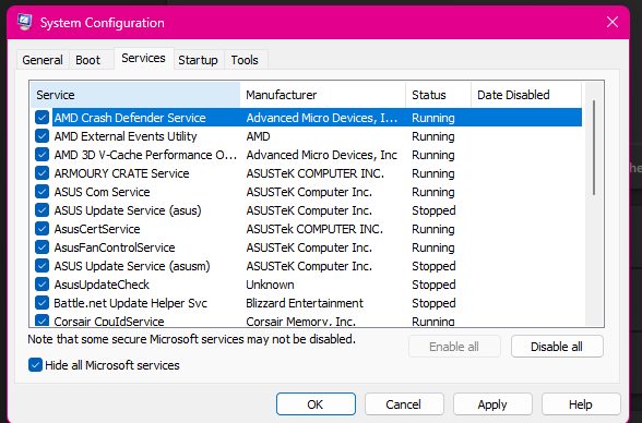

I never used to but when I started having these issues I used DDU to clean wipe and start again
IMHO, the crash defender is not the issue, the issue is why it's crashing, as it works absolutely fine throughout 99% of systems. There will be something conflicting with it causing the driver timeouts.
You know more about this stuff than I, but the 'it works on other systems' is true for just about every driver failure I've ever seen. The dumps all very strongly point at amdfendr.sys and it would be most wise to remove the AMD Crash Detection System from the equation, by disabling it, and then see what happens. Once we've confirmed that it is the crash detection system causing the failures we can move on to look at why.
The dumps show clearly what happened, though I didn't post this detail earlier. The failure happened at amdfenr+0x534D8...

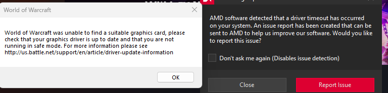

Hi all.
I bought a custom build pc from here a couple months back and alls been great.
However lately when playing FF14 out of the blue my pc screens go black - after about 30 seconds I get the error message
AMD Software detected that a driver timeout has occurred.
I’ve uninstalled and reinstalled the drivers I’ve cleared cache and sometime that will stop it for a day or so but then it just comes back and happens again.
Any ideas how to resolve this please.

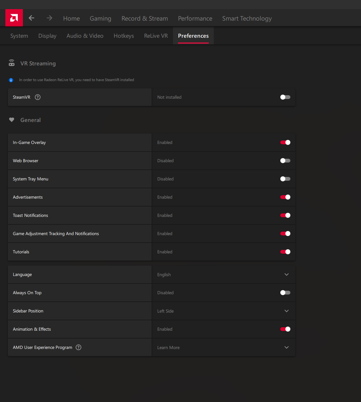

Just posting this as is an easy thing to try although is from about a year ago, so may be related to outdated drivers
"I know this is an older topic now, but I was struggling with this same issue with constant crashes.
I tried a lot of tips that people have put in here, and I wanted to try to work out exactly what was causing the crash for me in the Adrenalin software over the standard driver.
For me, it actually turned out to be the Instant Replay function. I can reliably and repeatably replicate the crash with that function on/off. If it is on, I crash in games after 2-10 minutes. With the function off I have never had a driver or GPU crash.
I have spent days trying to work this out, so hopefully for some other people struggling with the 7900 XT(X) cards, this can help you if you still want to keep other functionality of the cards beyond just the base driver install."
There's various things to try in that reddit thread.
Swinny
Thank you. However its always been disabled :)

Hi all - Really need some help with this - Starting to think something is wrong with the actual PC.
So today - The above happened again - However when i restarted my PC it wouldn't but and i had to load it into Safe mode however it then worked after another reboot - Really starting to become quite concerned especially given how much this cost and how new it is .......
@ubuysa @SpyderTracks
And then it done it again within 5 minutes of reloading it.
