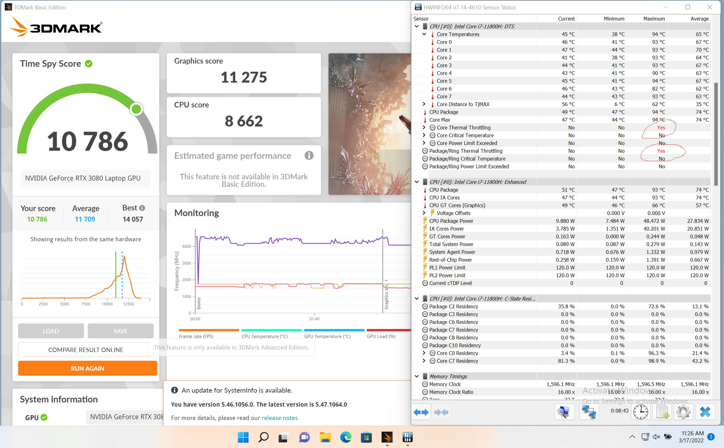

UPDATE: my notebook is on UK tech offices by 3 weeks and they are working on it.
The main issue detected was temps too high and the fan options were not doing anything to change it, and the system was also throttling when it was doing this.
So they replaced the motherboard, the CPU, the RAM and repasted with special thermal compound, and retested in a variety of ways and given the laptop a complete clean and tune up.
The latest update of yesterday says that they have not seen the temperature rise above 90°C. There is no thermal throttling, and there is no issue with the temperatures or the CPU.
Then they send me a 3dmark benchmark to check, i.e. https://www.3dmark.com/3dm/72916346.
As you can see, the GPU AVERAGE temp is 82° and CPU AVERAGE temp is 89° (!).
Maybe I'm wrong, but...the temperatures do not seem to me to have improved at all, quite the contrary :(
In all the 3dmark bench I ran previously the RMA I had never reached an average CPU temp of 89°, as well as 83 ° of the GPU. I think it is safe to assume that if the average CPU temperature is 89 °, the maximum temperature has reached peaks of more than 95 °.
And, maybe I'm wrong again...but I do not think that an average temp of 89° for a CPU is so healty.
I'm really confused...What do you think about it?

@SpyderTracks sorry if I bother you, but...this is the last TimeSpy 3DMark bench of my Recoil, from RMA department, with system to standard settings: if CPU 89° average is nowhere near throttling, why HWInfo monitor clearly indicates that THERE IS throttling?
(see attached file)
(see attached file)
Cos HWIngo incorrectly marks 90c as throttling on that CPU.
The actual throttle limit is 100c
90 is where it won't be able to peak boost but that's a marketing gimmick by intel that isn't achievable anyway at stock settings.

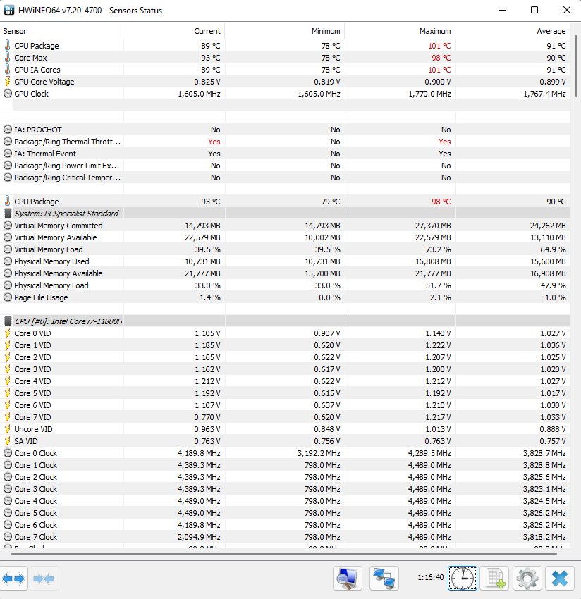

hi @barlew @SpyderTracks: these are the temps of my Recoil, after RMA, during 30 minutes of playing on Call of Duty Warzone.
All drivers updated, CC on Gaming Mode. Do you still think those temps are normal? :unsure:

wwwmagnottait
No, that's clearly thermal throttling. It needs repasting.
mhhh, I got the notebook from RMA just 2 weeks ago, it is almost brand new (they bring my HDDs on a brand new Recoil) and it already needs repasting?!
So a thermaltake kryonaut (the one that the PcSpecialist Technician applied), only lasts 2 weeks? I'm puzzled...
No, obviously not, it just means it's a bad paste job, perfectly normal, there's no way of verifying a paste job is done correctly until it's in use.
"Thermaltake" and "Kyronaut" are 2 separate things. One is a manufacturer, the other is a paste model by another manufacturer. We would always suggest using Thermal Grizzly Kryonaut

However I expected something like this ... as written above, when the notebook was still in RMA, that 89 ° average value on TimeSpy worried me, even if the technicians assured me that in their benches it had never exceeded 93 °. And indeed...
