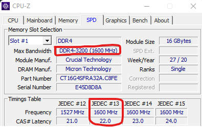

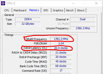

As promised, my CPU-Z:
SPD tab, showing my original RAM size and speed of each module: 16Gb 3200 CL22 (2 x 1600Mhz)
Memory tab, with real values: 32Gb (2 x 16Gb) ~3600 CL20 (2 x ~1800Mhz)
And the reason why my real frequency is higher than the default is because I'm doing RAM overclock using AMD's Ryzen Master. But that doesn't matter, it's just to show you that the memory tab is indeed the real frequency. And another thing that proves this point is that @wwwmagnottait 's 3Dmark is also showing 1333Mhz, while mine shows the full 3600Mhz (or something very close to that).

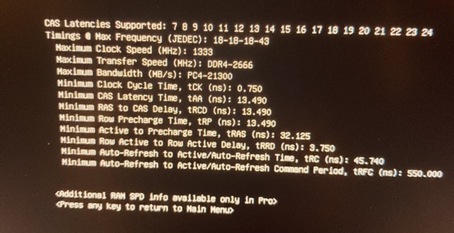

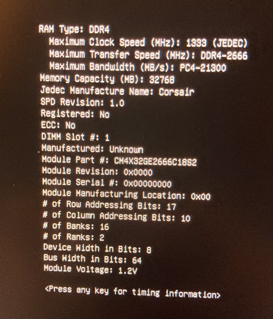

You'll probably have to run it over night to let all the iterations of all the tests run, then post the results here, @ubuysa is the man to let you know what they mean
wwwmagnottait
Hi all!
@Martinr36 @FerrariVie I left the laptop all night, but in 6.4 hours it was able to complete 2 full passes only (on 4): here some reports of the test (passed, but I didn't find a way to save it on html).
  • mt86Bench-20211126-083816.txt
FerrariVie
Super Star
I do not trust memtest86's frequencies, even though it's a great tool to find faulty RAM (regarding wrong calculations and allocation). To me, what it's showing is the maximum rate, which could have been extracted from the RAM specs (just like CPU-Z SPD tab). The only sources of real RAM frequencies that I use are CPU-Z Memory tab and 3DMark (which shows the average frequency of the whole benchmark run).
But that is just my personal opinion and preference. 🤓
Same way as typing the below in cmd (command prompt) will give you the same RAM specs data, not the real one:
wmic memorychip get devicelocator, speed, capacity, partnumber, manufacturer
I've never used Hwinfo to check RAM, but will give it a quick go later today just to check if the below field is supposed to show real or specs frequency. It's easy for me to check since I have overclocked my RAM, so if it shows spec value it's not real.
1) RAM: n first and foremost, as I was pointed out in the forum by @FerrariVie @SpyderTracks, my RAM ( 64GB RAM DDR4 SODIMM Corsair 2666 MH ), both from the results of 3dMark and from HWinfo (see attachment) it goes at 1333 mhz, that is the EXACT HALF of 2.666! How is it possible? Did they fail or is there some BIOS or settings problem?

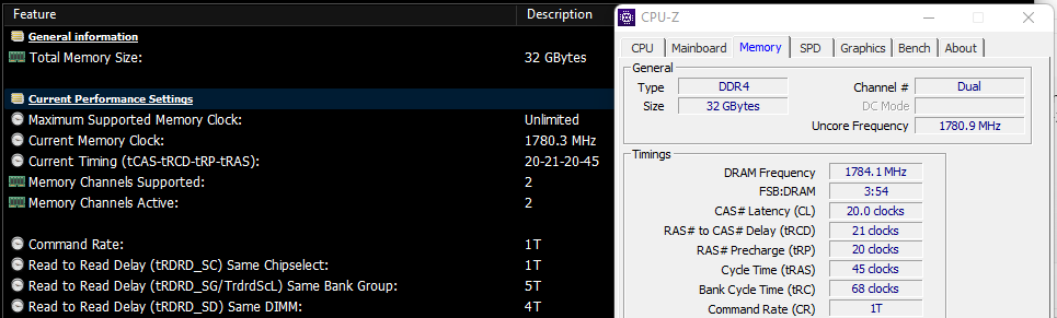

Now I'm puzzled... in my case, both CPU-Z and HWinfo report the same frequencies (real ones):
But it's weird that Hwinfo is reporting one frequency, while CPU-Z and 3DMark another. Doesn't make any sense.
Which CPU-Z version are you using, @wwwmagnottait ?
