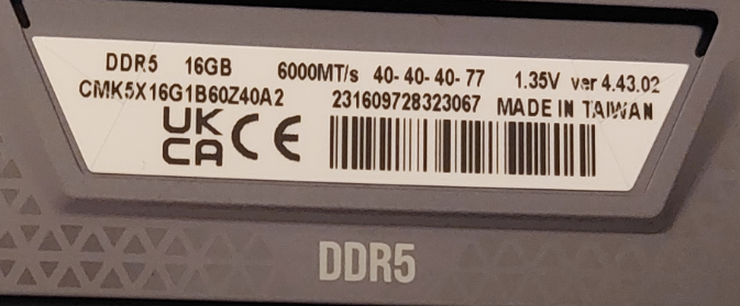

I can't even find my RAM online (going by the sticker on the back): CMK5X16G1B60Z40A2
Very weird, although maybe not the exact part number you would think a web search would bring up something.
It's an OEM model number, wont be listed on the web
I've said to you multiple times, you need to use the package code.... not the individual stick number :confused:
I've listed this for you a couple of times to aid in your search. However, it's very easy to figure out which one it is as ASUS list the timings and spec of the RAM they have tested.

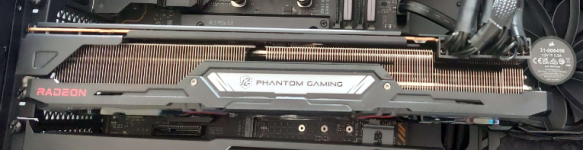

So I'm going to be sending back my GPU for a replacement. Being overly cautious here in taking it out but the latch at the end of the PCIe slot you just push down on the release the GPU and then gently pull it out? I assume this is very straightforward but pulling something this big out of the motherboard I really don't want to cause damage!
Yeah that's it, you can actually feel it release a little when you push the latch down
Assuming you've unscrewed it from the case?

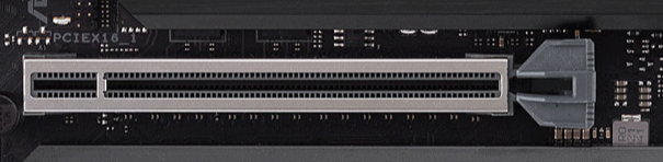

Haven't attempted yet, still in the office so going to have a look when I get home. Unscrewing it and removing power cables should the easy part. Per a pic of the case I have, it's the size of the card and accessing the latch I'm concerned with since I can't even see the latch.
You should be able to access it from the top of the card, if you have something small you can use than to push the latch as well, I'd recommend something not metal, Like a piece of plastic would be best
I just use a long screwdriver to push down on the latch, works fine.
Was that a picture of your board? A number of the boards have remote release buttons now. Just in case you run down a rabbit hole looking for the latch :)
LeeB
Pretty sure it's a latch going by pics of the board online with nothing installed.
I'll be home shortly and will have a look. They offered to do this or take the whole system back so if I can't get into it easily may just take that route. And could ask them to update the BIOS at the same time.
