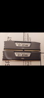

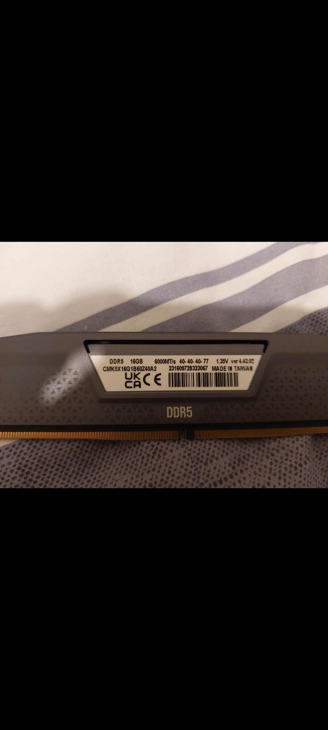

That's the RAM in my system I received. It's not listed as being supported on my motherboard.

This is the pair, both the same. Still not listed as being supported on my motherboard.
Like I said, the part number for the pair is always going to be different. It wont be on the individual sticks. The information I listed is what you should check for the compatibility of your board.

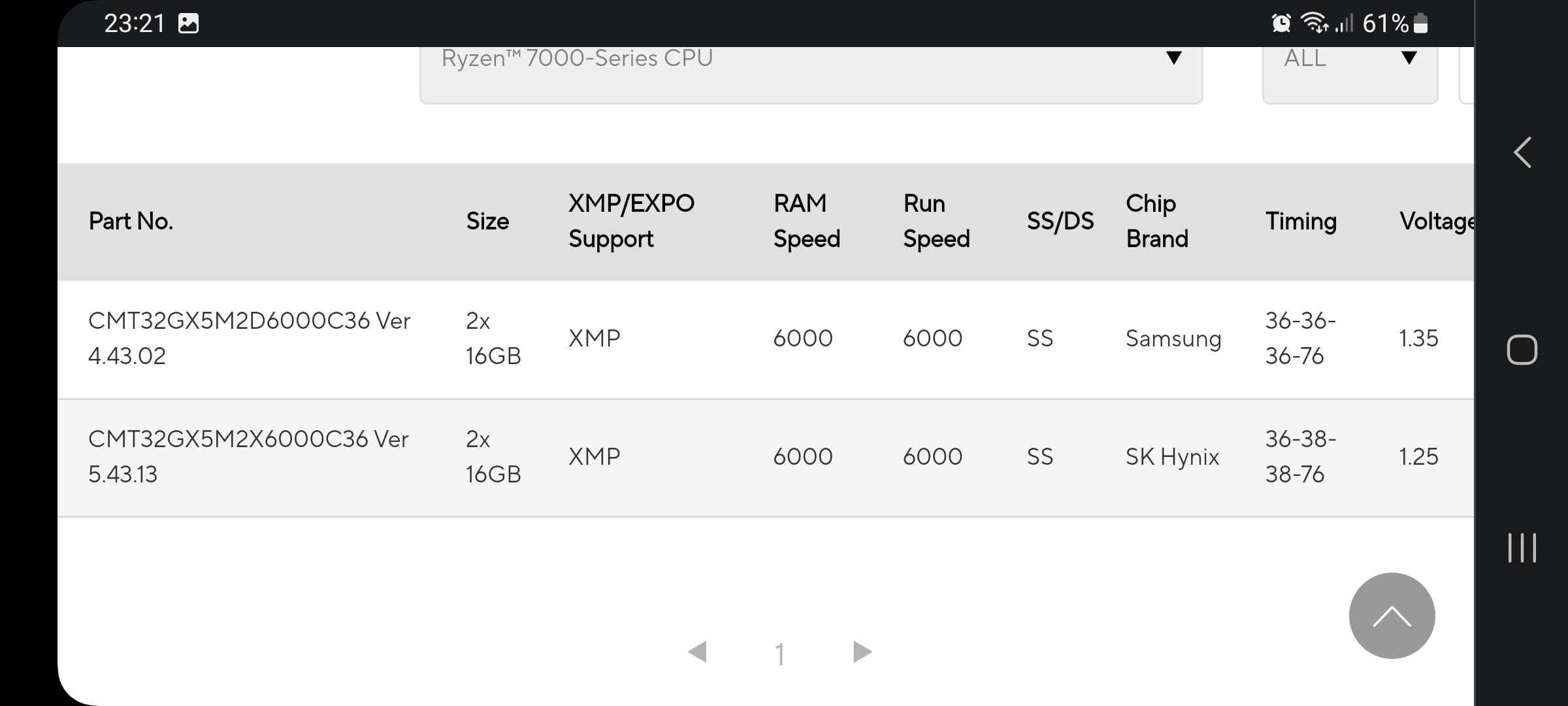

Attached is the QLV Corsair 6000mhz RAM for my motherboard, one I got in my system isn't listed.

This is fairly standard. Not every RAM kit will be listed as compatible. Not being on the list doesn't mean it's not compatible, it just means it's not been confirmed yet. The fact that it's compatible with the other boards suggests they just haven't gotten around to adding it yet.
The timings & frequency are much looser without the XMP/EXPO switched on, so it would be even more likely to be stable and compatible. The only RAM considerations I would have would be if the RAM was faulty or was of a slightly lesser quality and needed more voltage to run stable.... which wasn't being provided by the stock, non XMP setting.
PCS would typically only make compatible RAM available, they typically test all the variations before offering them so I doubt it's anything to do with compatibility or lists.
