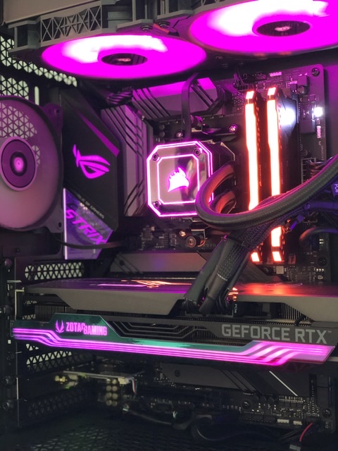

There was 4, stuck together like and weren’t any give in them to suggest even slightly loose. The pic I’ve got is too big to upload to show but definitely 4 wether it’s two split off in to 2.
Are all connections plugged as same in the pic? I have pretty much exact same build so thought I would show you the connections on my GPU

Are all connections plugged as same in the pic? I have pretty much exact same build so thought I would show you the connections on my GPUView attachment 29536
Haha for a second then I was like how's he got a picture of my comp as it wouldn't upload yesterday! Yes literally the same bar the rgb colours. As a side note how did you change the GPU colours? What software did you use? I tried the Spectra stuff but kept saying unable to detect card (which in hindsight makes sense but I just brushed it off as software looked flimsy).

I uploaded the pic just so you could see the connections in place on the GPU, just in case yours looked different. PCS are brilliant though with RMA so doubt you will be waiting long mate
