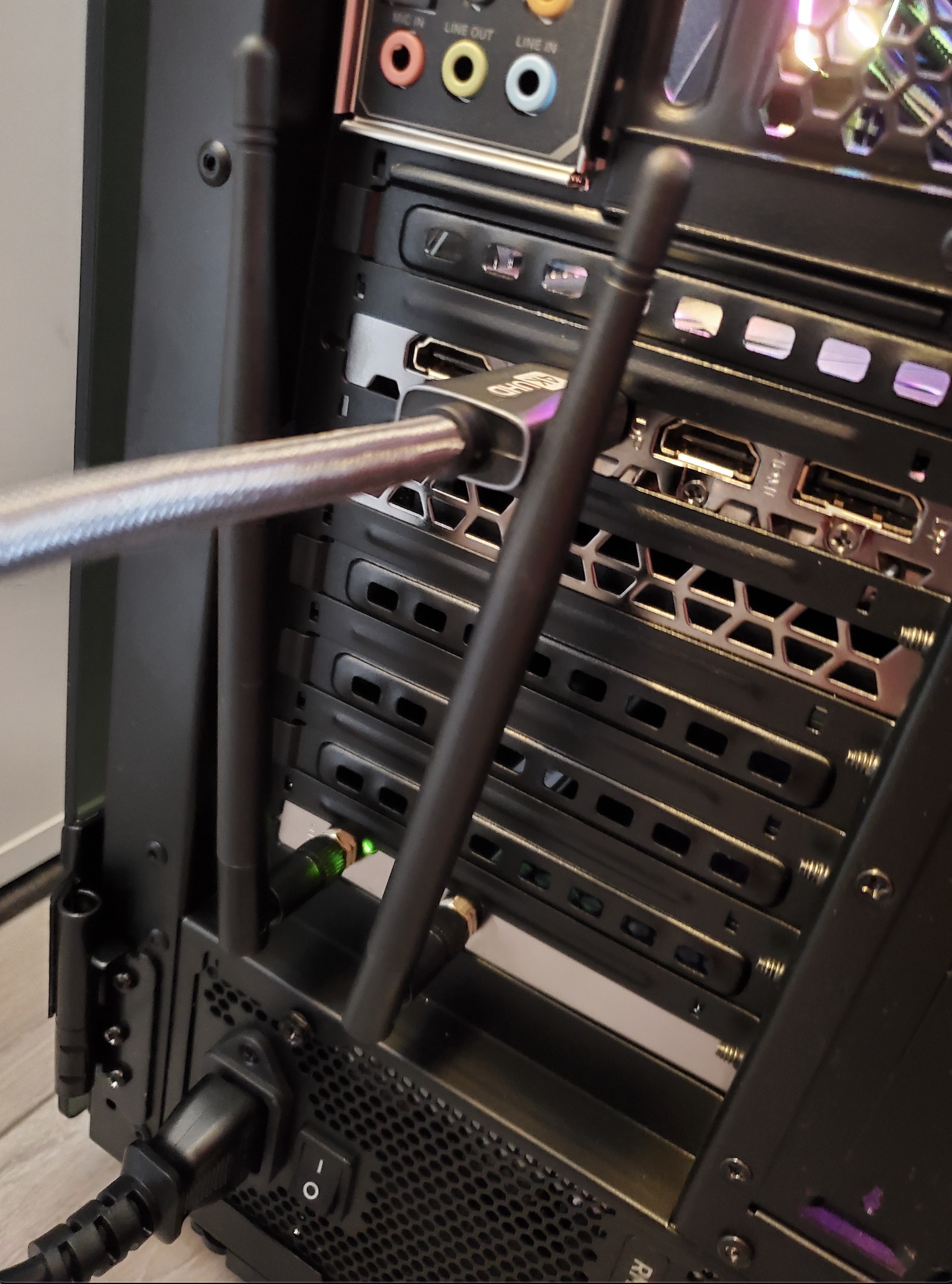

I just checked if my antennae if they were probably connected and screwed on and they are probably connected so I don't think it's the antennae, but I will try and take they off. I think I might do a network restart first, see if that fixes the problem.

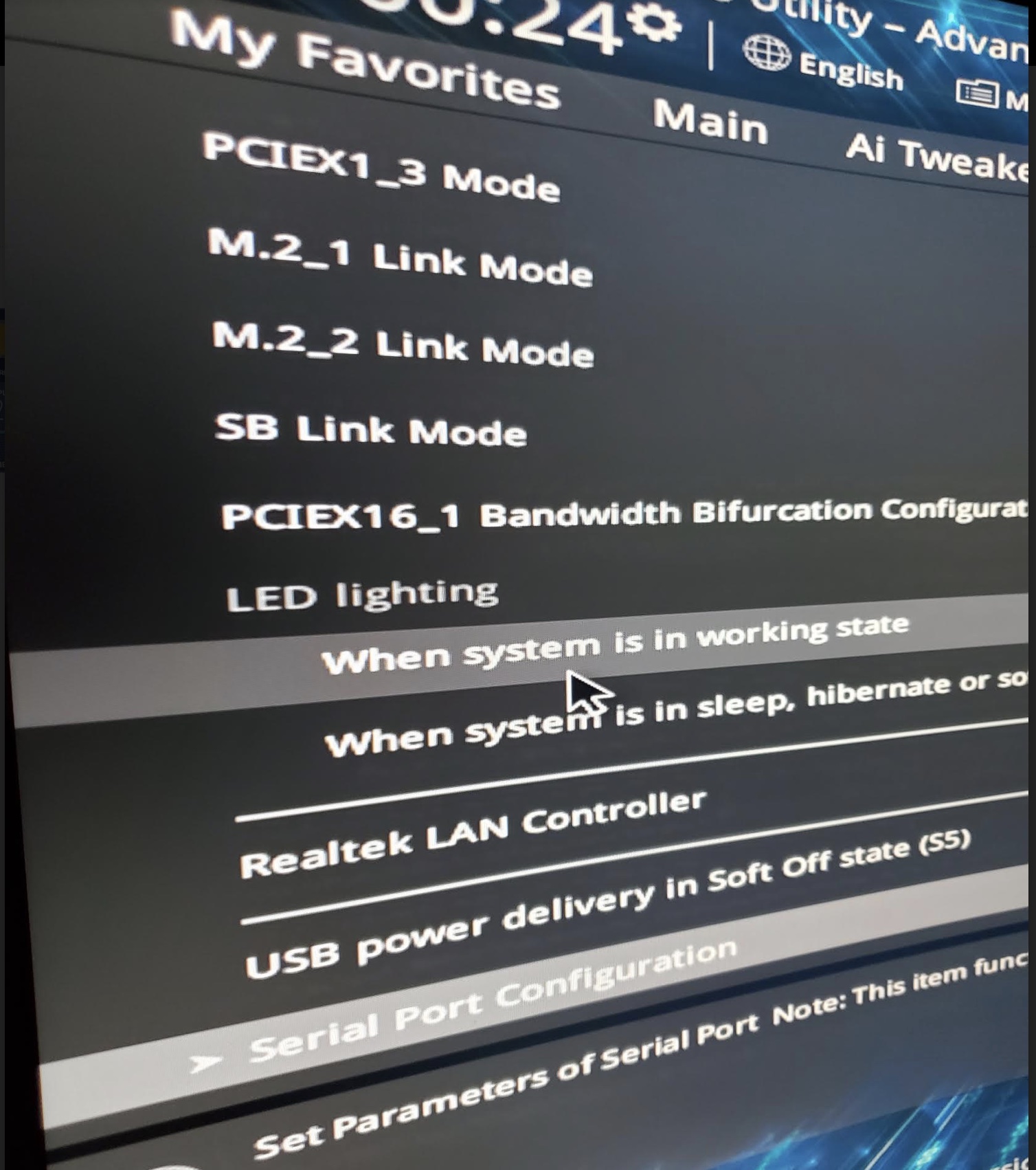

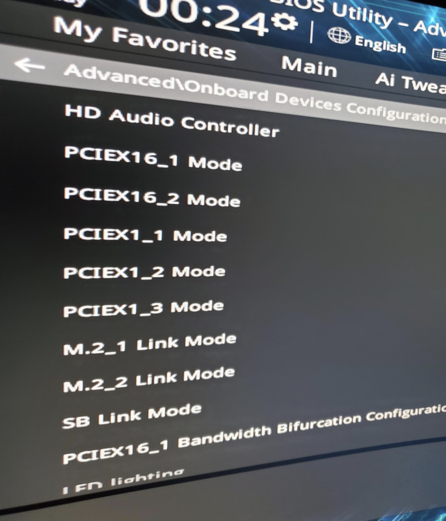

- Remove the card and checked the bios > advanced > onboard devices, but I couldn't find an indication of what could be the motherboard wifi card to enable it.
- Antennas are connected

Brought the PC back to the room and the speed was capped by a great margin. I don't see any other solution then finding a better location for the PC perhaps, but I feel that the quality/reception of my antennas aren't great.

Can you take the antennae off and test the speed. Yours sound like a bit more of an issue, if you are getting 3mbps from a possible 900

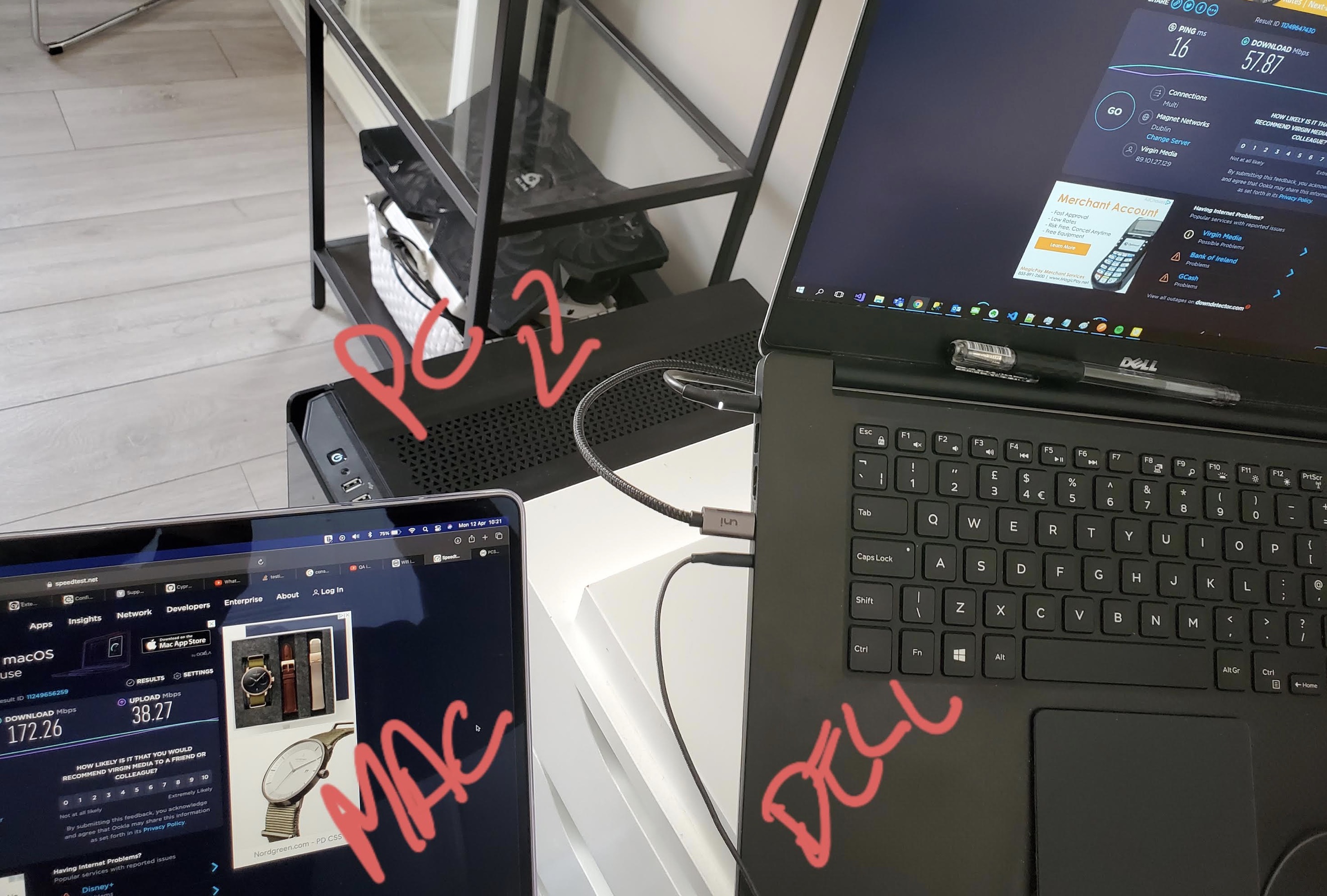

The order since the beginning (more or less) was
- Getting 3mb
- Removed and connected the antennas.
- Re-installed the driver and re-connected the card (not necessarily in this order)
- Could connect to the 2Ghz network, but 5Ghz network wasn't stable (either not connecting or having latency issues)
- This morning, to have more info before posting here, I brought to the living room to check the wifi there and also cabled to see if the problem was with the signal or with the card/antenna. Which I know now the signal is great while I'm there.
- I then brought the PC back to the room and it's holding a stable connection to the 5Ghz network so far...I get around 50 to 60mb.
Which to be fair, is the same speed I get on my Dell laptop (I get up to 150mb+ when checking on the MacBook though)
I'm aware of the fact that my walls are holding a lot of the signal but I'd have thought that the antennas were made exclusively to improve the signal.
