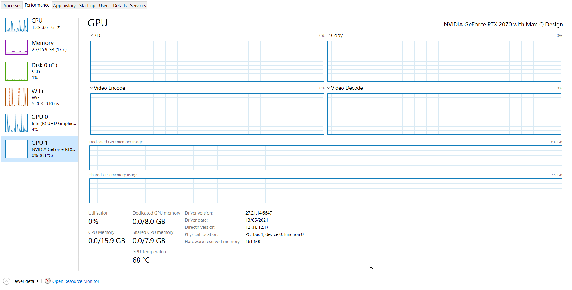

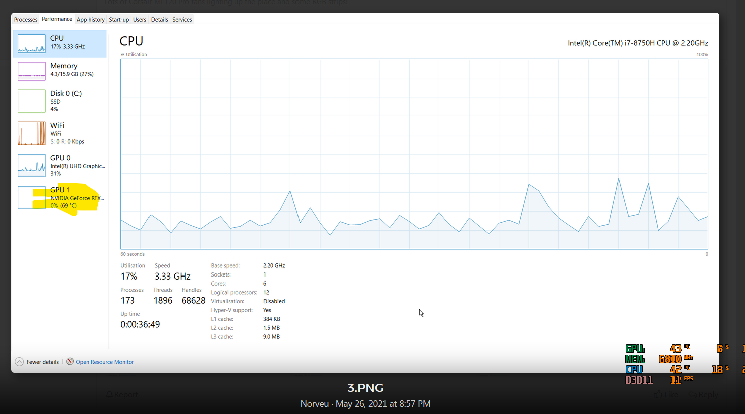

Ok, so there's a lot of background processes going on, when people say idle, they mean absolutely nothing open other than the temperature monitor, so no chrome, nothing else at all as they all take resources.
It's likely as well, there are some background processes resultant from new installation that are sorting out caching and indexing.
I'm not overly happy with the resting temps though, I wouldn't want them that high at all, to me that would be enough for a repaste.
I'd be expecting more mid 40's at the most really.
So do I need to take a check on thermal paste?
For chrome only this page and one youtube video is open.
Also I was expecting mid 40's as well. I'm not sure why temperatures are high like this.
GPU1 running at 69 with no load..........

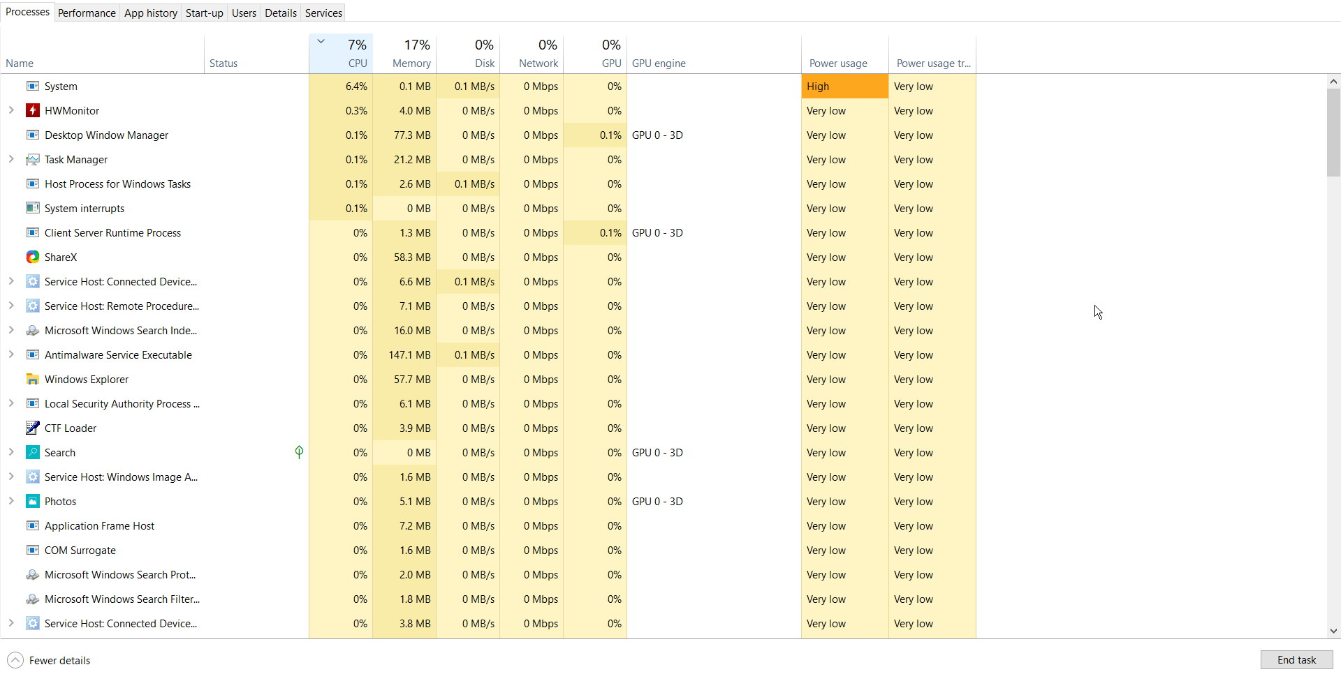

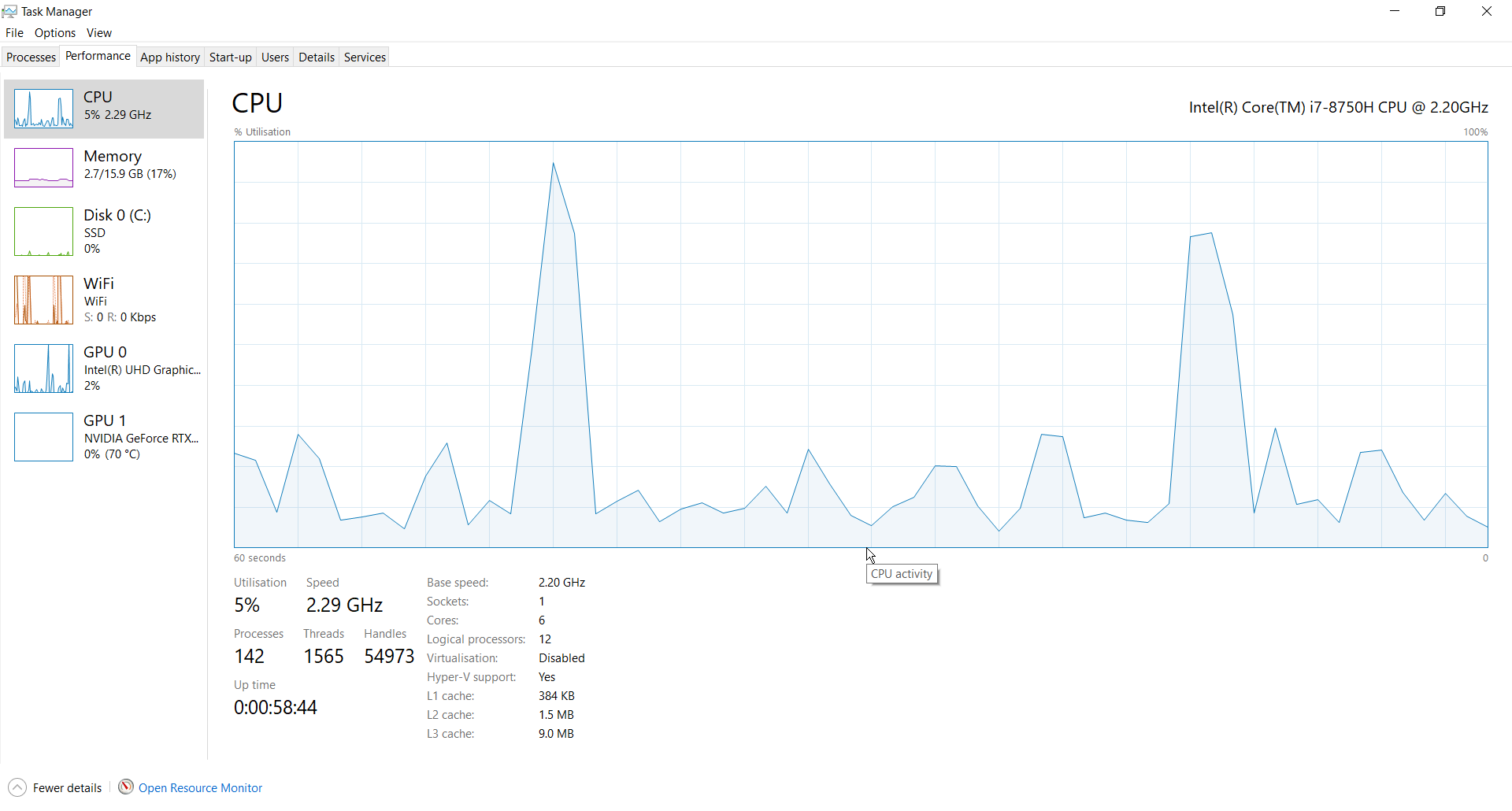

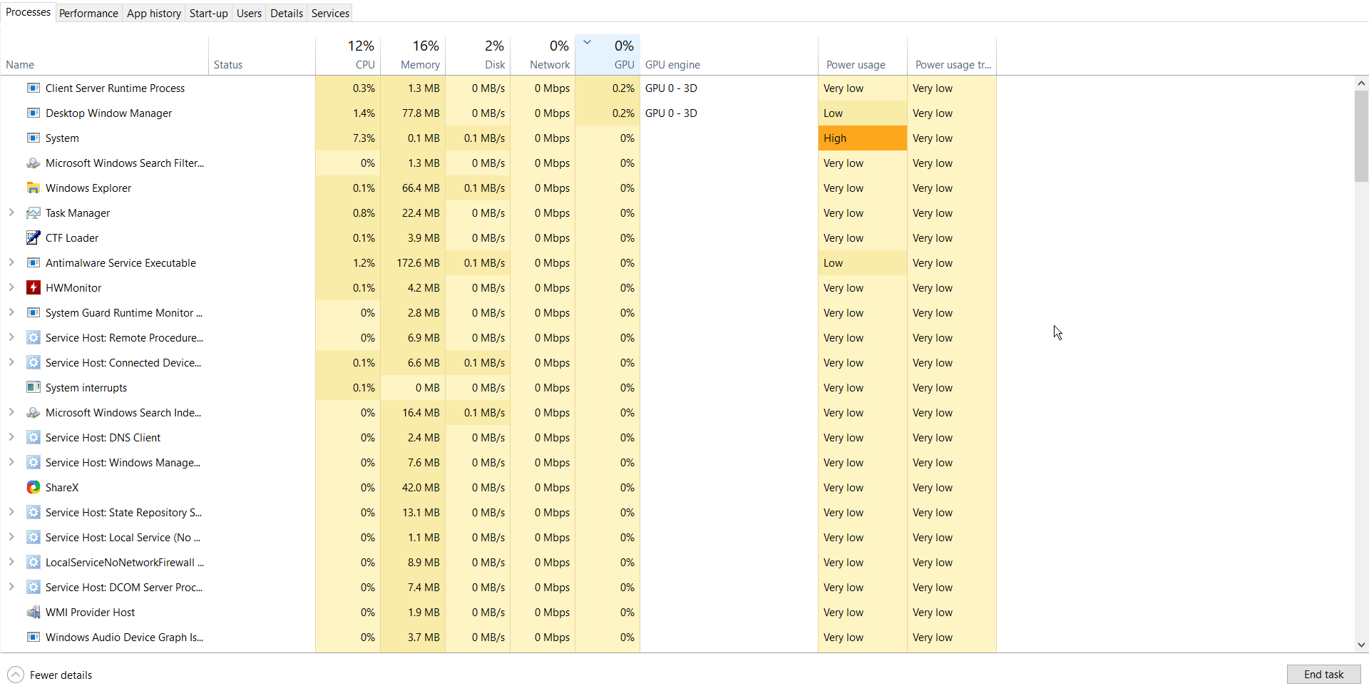

Because you’ve got programs open, it’s not on idle. As I said, you have nothing open apart from the monitoring software.
But even with a small load the temps are definitely too high.
Norveu
Okay, I have closed apps I know like chrome. I also tried to close my screenshot app but without it I couldn't take screenshot pressing print screen button so I had to use it. Well GPU temp didn't change at all.
