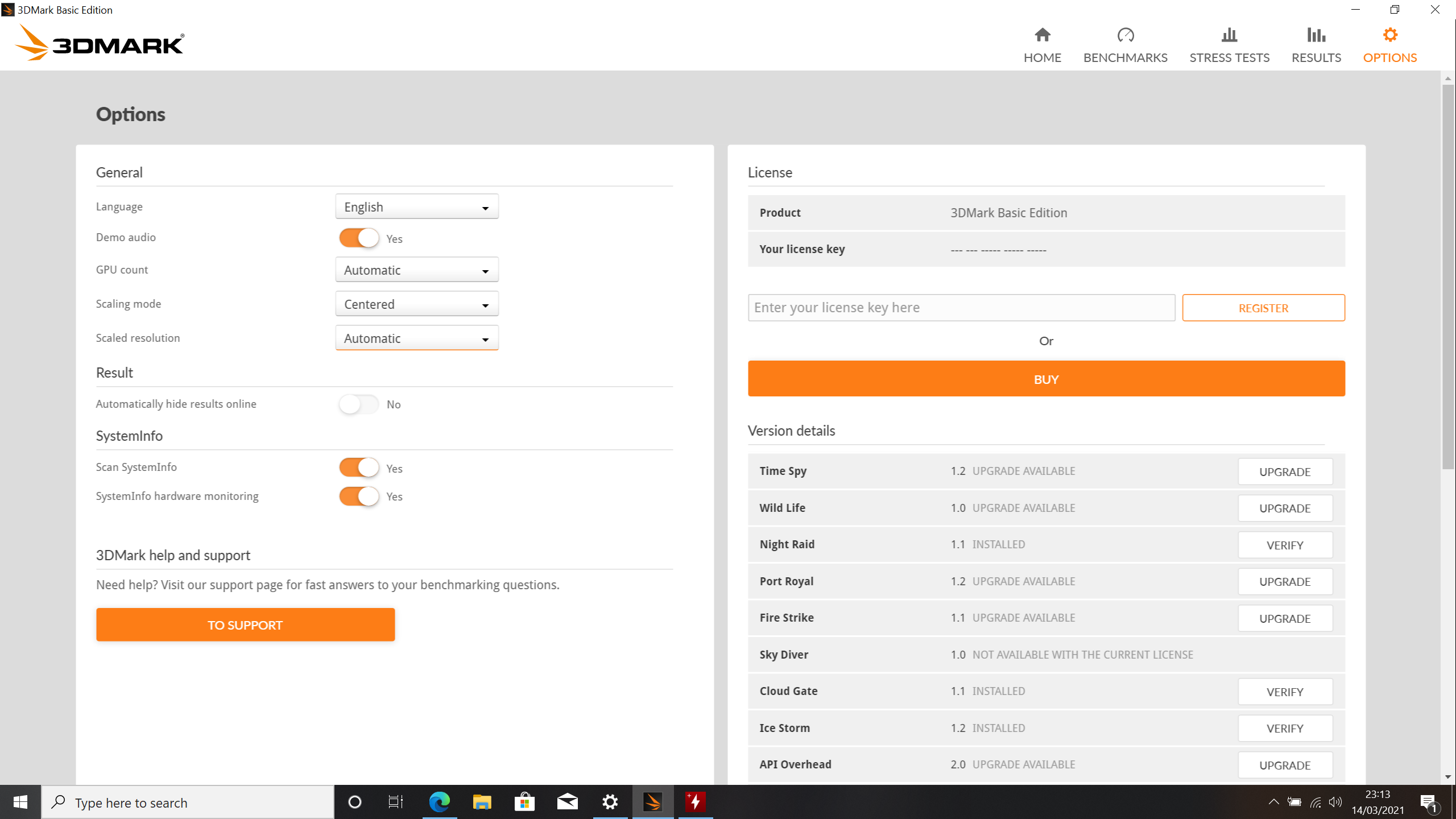

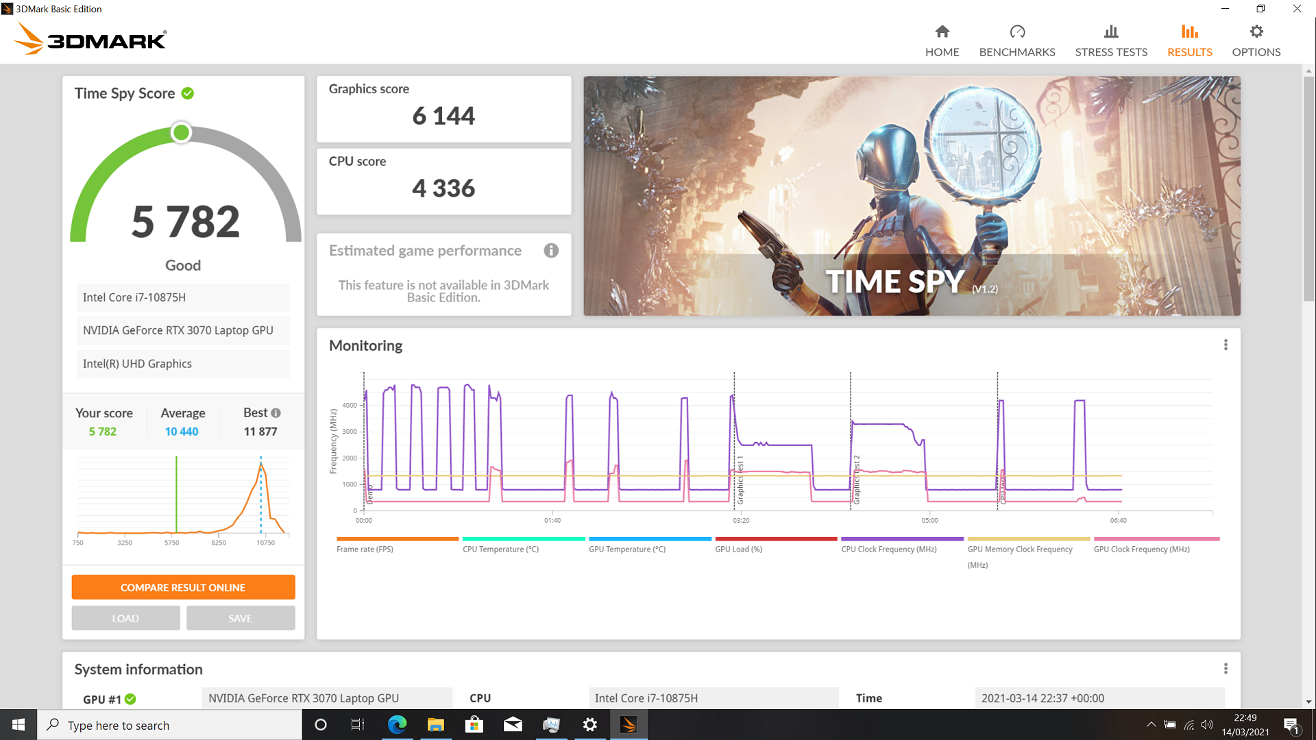

angelo994

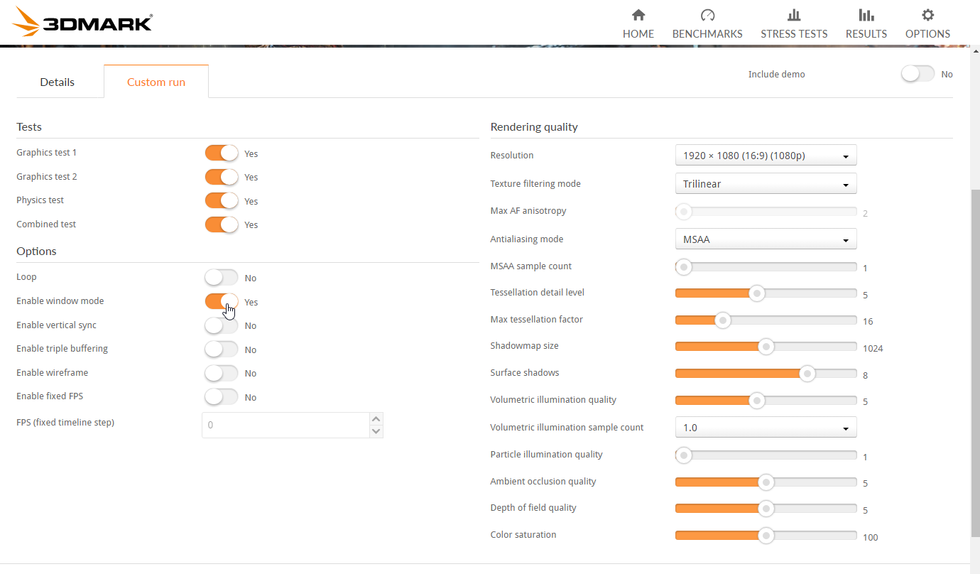

As said, we need firestrike, you just go into the options and select allow windowed mode:

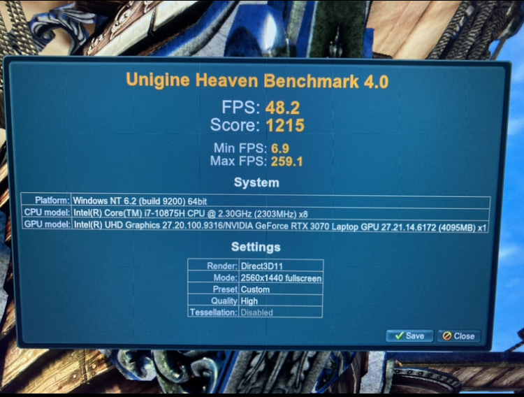

I'm sorry,. what is firestrike? Can you point me in the direction of download? I'll do another timespy just now with hwmonitor running at the same time.
I also ran a heaven benchmark.

On the benchmark options, not the program options, you need to select custom run as in the screenshot, it may not be available on the free option though, not sure.
Yes, does not appear to be part of the free version. And no offence, but I am not spending another penny on this laptop right now.
