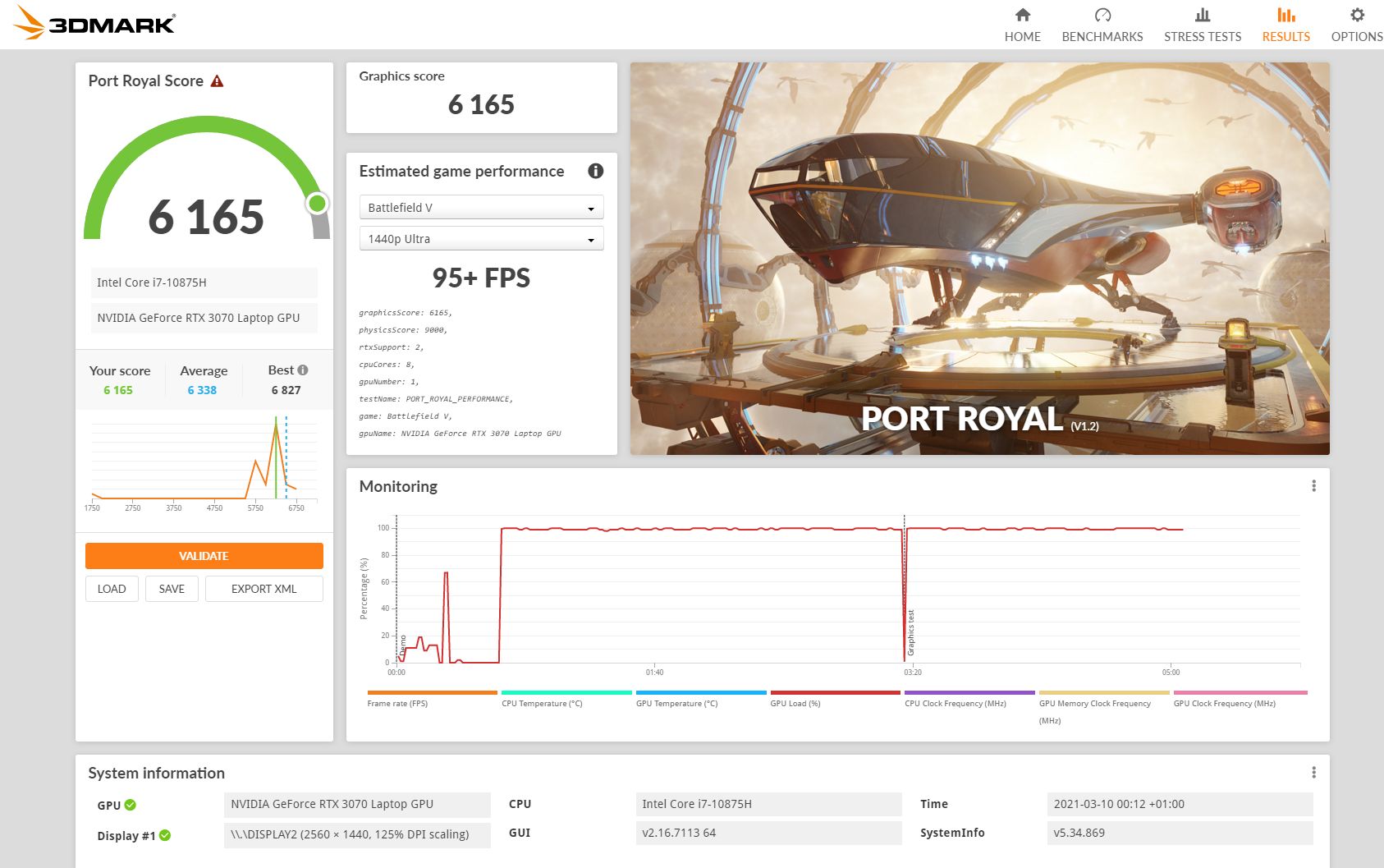

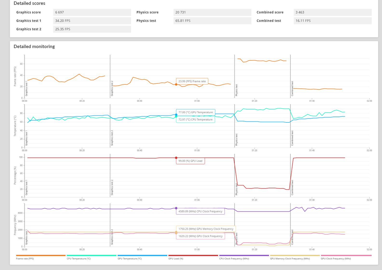

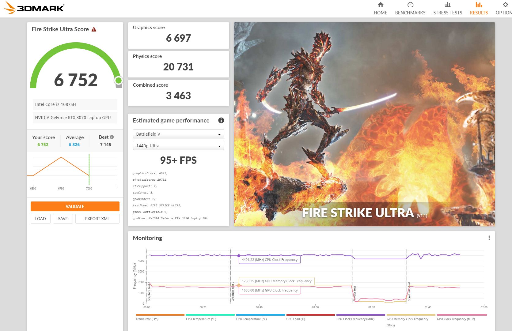

meanwhile I did a 3Dmark
Results are as I expected
CPU temp went up to 90 and GPU max temp 80 dropping to 60 within seconds when not sollicited
Macco26
Expert
Nice. If you send Fire Strike Extreme scores people might think those are the scores for the normal Fire Strike and think those are underwhelming, instead those are at a higher resolution. When you can, redo the Firestrike STOCK benchmark and post in the dedicated thread of the forum, if you like the results, please ;)

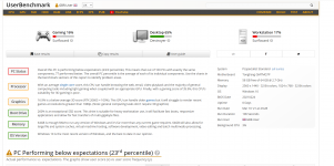

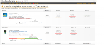

Hi there,
I've been having a lot of issues with my new Iconico 17" RTX 3070. I ran a benchmark on userbenchmark.com and extremely shocking results.
I do not understand what this means, is this an issue with my build. Or a serious software issue on my end?
