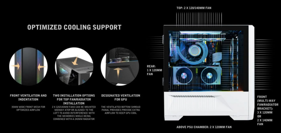

This will be going on the top of the case so I thought the 2x 140mm fan bit on the screenshot was implying this 😳 will look for a 2x 120mm!
NoddyPirate
Yeah I think it can take two 140mm fans up there but not a 280mm radiator. RAM clearance probably is the issue....?
Keep scrolling down that webpage till you get to the specifications at the bottom......
