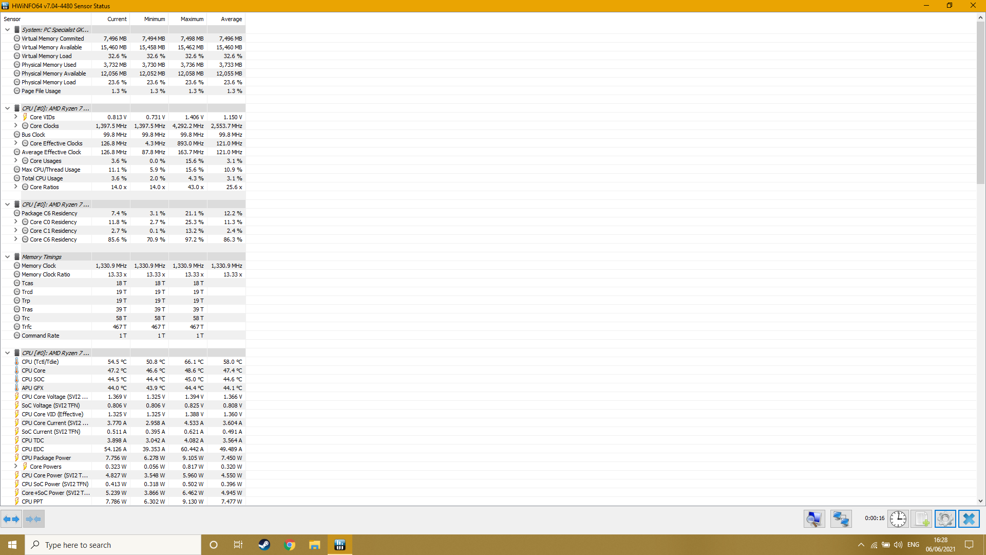

Can you give us some screen prints of the output from HWMonitor/Info please - running idle, running a game.

Here are some screenshots I took while running a game in the background and while idle. Hope this helps. If I did something wrong please tell, I am not very smart.
Bhuna50
I've not reached the 100 yet with mine but sometimes in the 90s on the CPU temp.
I can only suggest that if you are concerned that you raise it with PCS directly and ask for further advice / whether to RMA it for them to have a look. Especially if you are sure that GamingCenter / drivers / fans are all set up properly.
