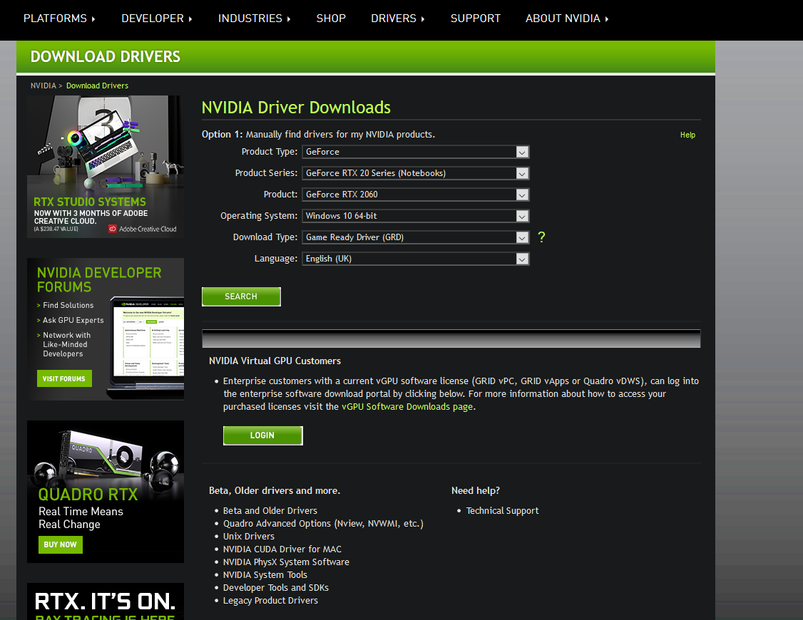

If you go to the nvidia driver page and then to the "beta and older drivers" section near the bottom of this image:
hezzlington
My bad, yes, you're right, don't see why they list it in the legacy drivers section, this is the previous:
