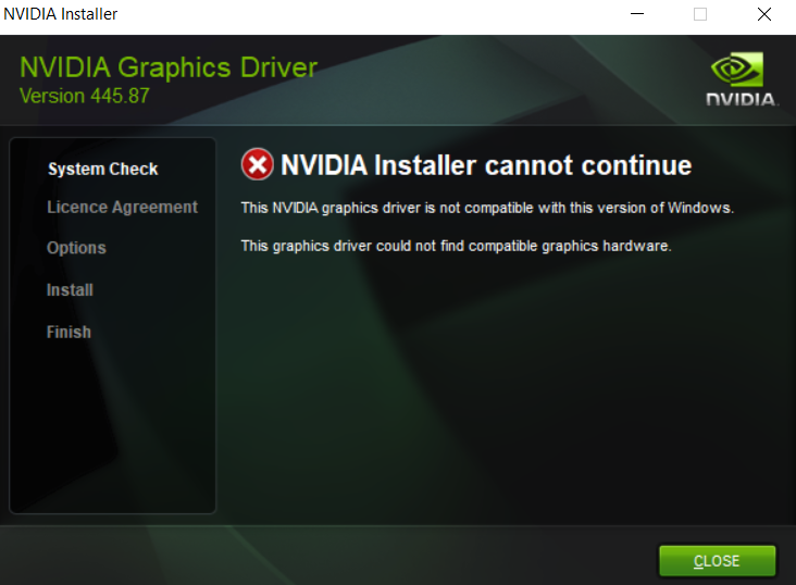

This could be a driver issue? The "latest drivers" in my geforce experience are showing a different version number to the download file?
IT shows version 442.53 and the downloaded file says version 445.87
hezzlington
this is driving me insane. i cant install the damn driver! My windows is all up to date so no idea why its not compatible
Is that even a real driver?! I cant find any reference to it in previous driver updates...? Really confusing.

Right, so I've managed to update my drivers (I think...)
I had to copy and paste the new driver files onto desktop and then modify a .inf file to match my GPUs hardware ID or something like that, but it allowed me to bypass the compatibiltility issue and update at least. Prior to this, I did an OS re-boot which deleted all my games...
