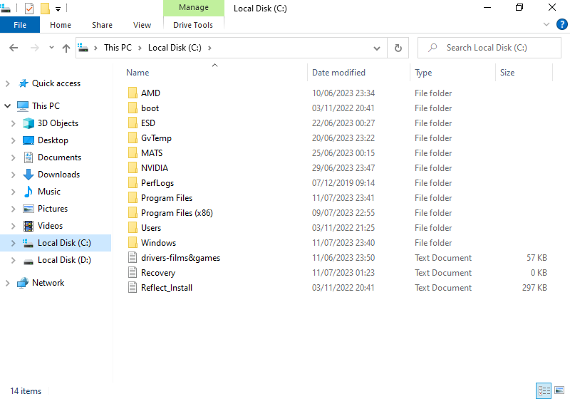

Can you use File Explorer to display the root of both your C and D drives please?
And please confirm that you've uninstalled both COMODO and Malwarebytes.

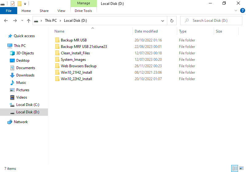

I have attached screenshots of the root of my System/boot drive C and drive D.
Both Comodo Internet Security and Malwarebytes are uninstalled.

Clearly it wasn't, there is no Windows folder on your D: drive.
Please run the sfc /scannow command and then reboot.
You said that the BSOD happened when you ran Malwarebytes. I suspect that COMODO and Malwarebytes were getting in each other's way and that's why you had the BSOD (yes, software can sometimes cause a 0x124 BSOD).
Out of interest, what is in the following folders on your D: drive...
  • Clean_Install_Files
  • Win10_21H2_Install
  • Wind10_22H2_Install
Why do you need to keep these folders?
If you continue to get problems unplug the D: drive and see whether the problems cease. It appears from your log file message above that Windows thinks it's using the D:drive as well.
Should you decide at some point to reinstall Windows (and I'm not yet suggesting that you should) please disconnect the D: drive whilst you do the install.

The Win10_21H2_Install and Win10_22H2 folders on my D drive contain any new program versions available at the time that I use, e.g. web browsers, office applications.
The Clean_Install_Files contains any files that I might need to copy back to the C drive, e.g. files that I have downloaded but don't need to be stored on my C drive.

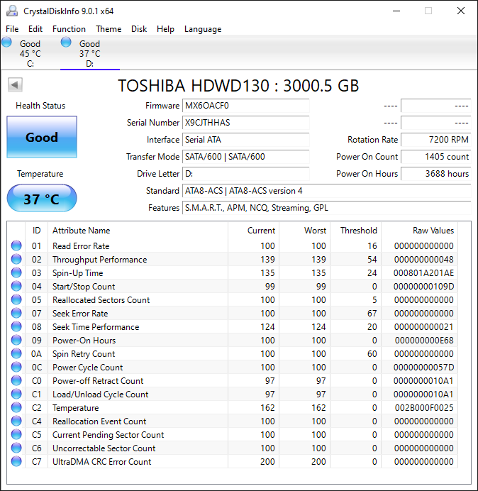

Just out of interest I did run Crystal Disk Info and I have attached screenshots of the C and D drives.
I don't understand what you mean? Why not just update to new versions when they are available? Or, do you mean this contains the installation files for apps you have installed?
Such as? Directly copying files to and from the system drive could be dangerous. You'd be better of moving your Users folders to the D: drive permanently so that the C: drive isn't polluted.
If/when I need to do a clean install of Windows 10 I will look and see if there are any problems with drive D.
I really would suggest disconnecting the D: drive when/if you reinstall to be certain that the installer can't see or use it.
