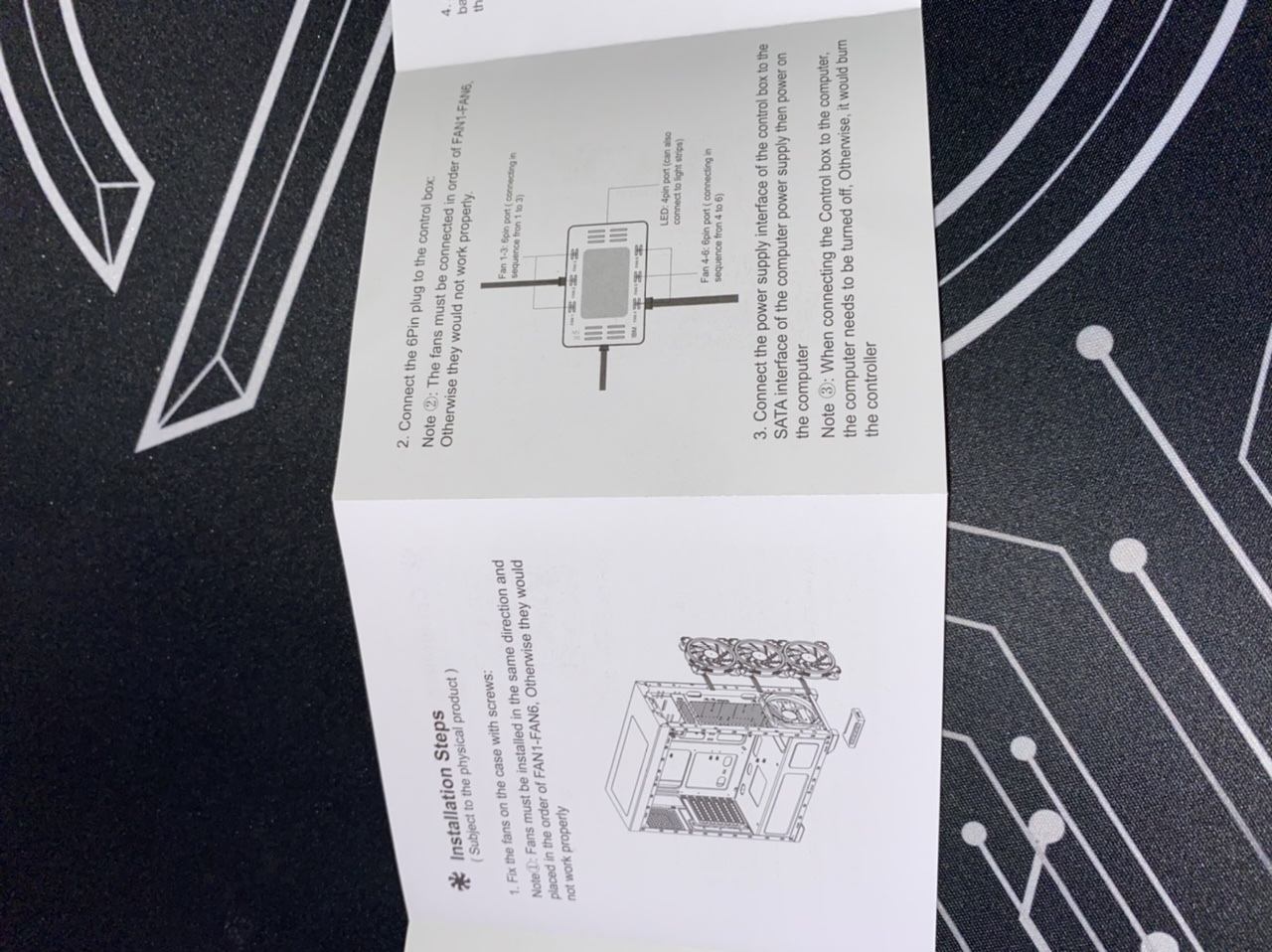

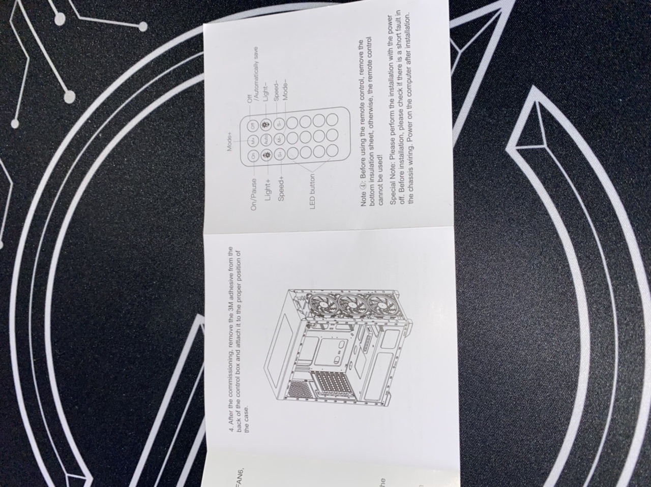

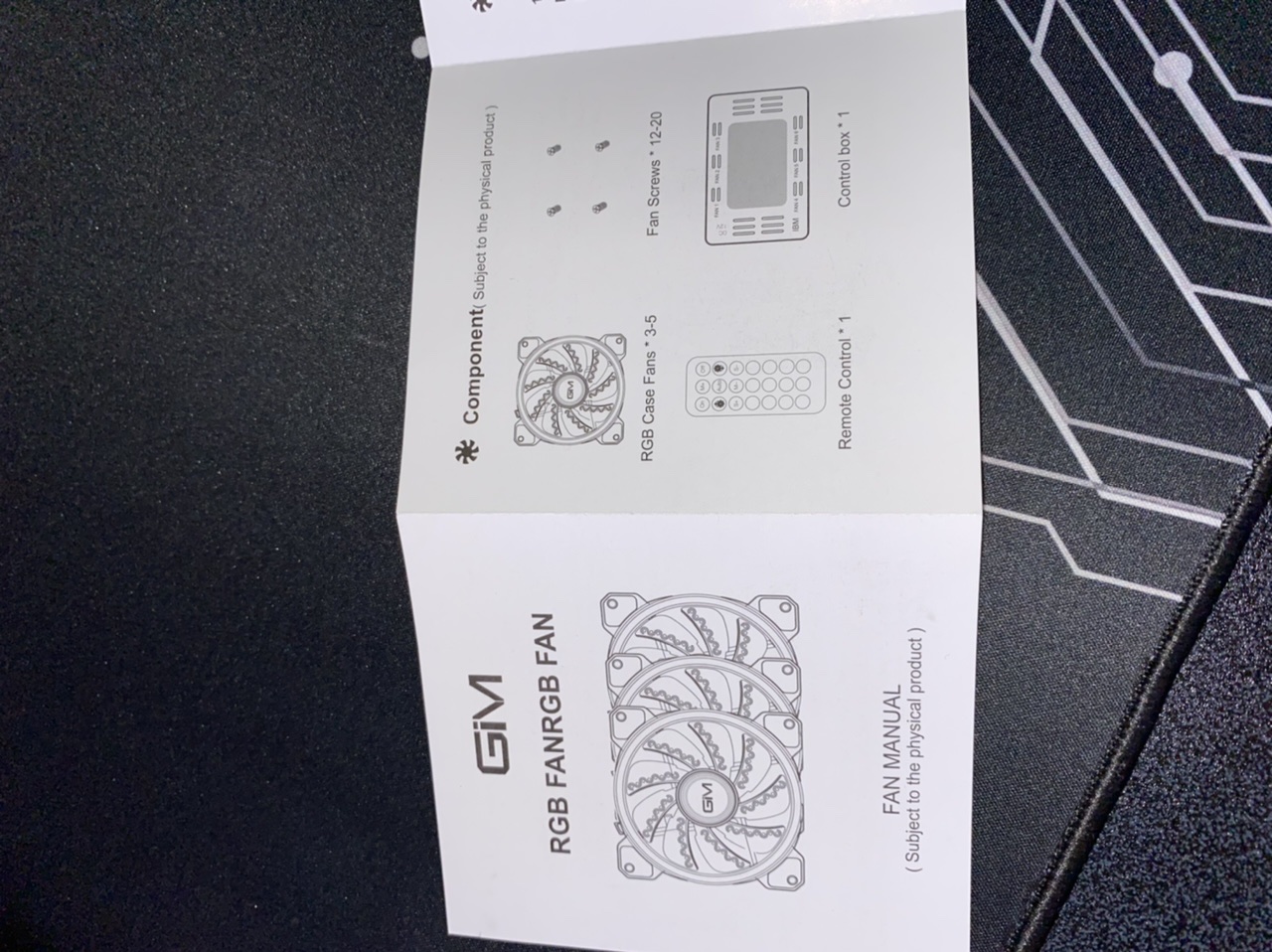

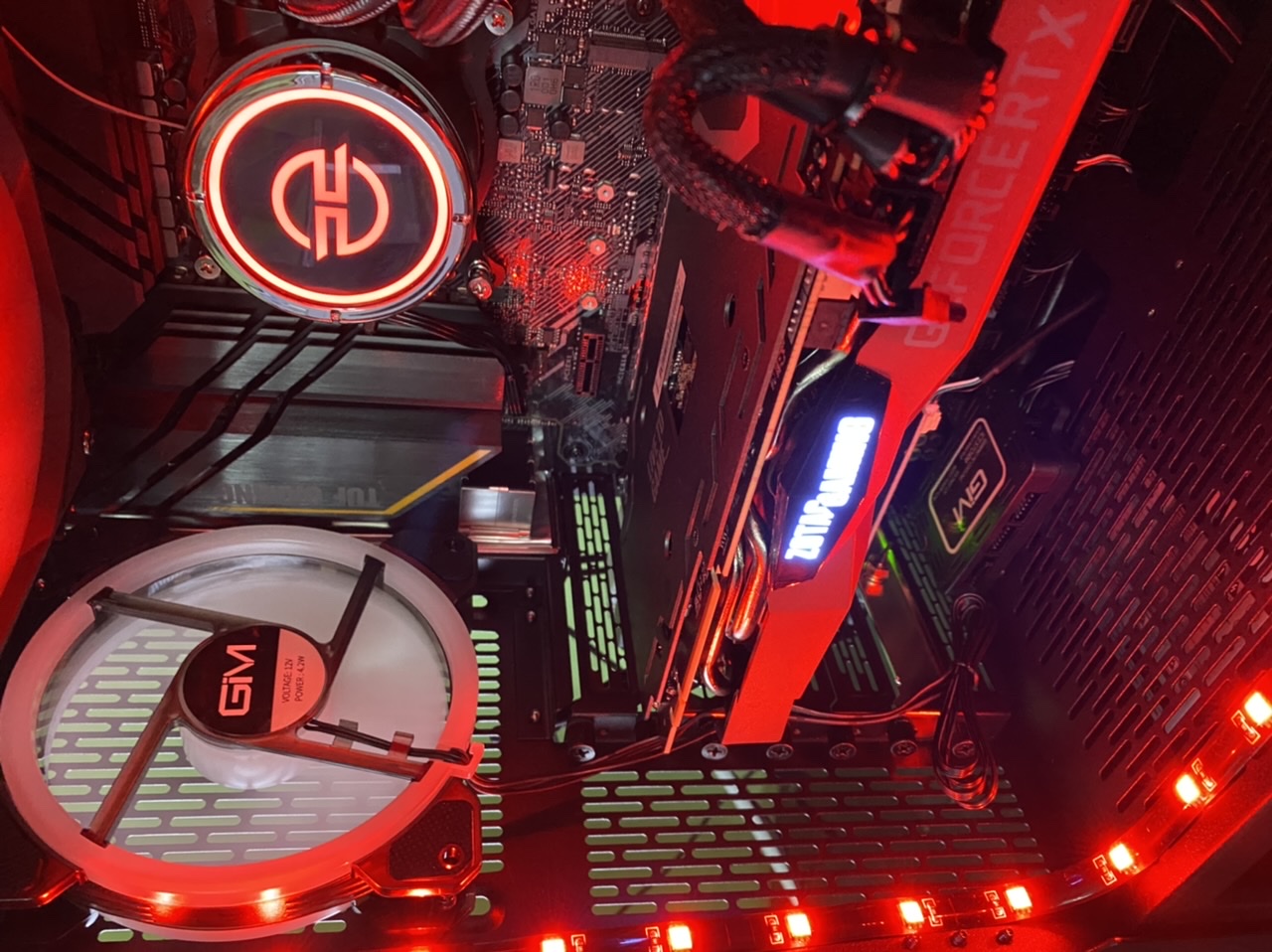

Alright I’ve plugged in my new fan on the back, put it into the power thing for it at the bottom. How do I get the RGB lights to light up as there’s nothing else I need to plug in?
Remote for controls are working as when I press a button it lights up on the remote, but does nothing to the fan
Photo shows the controller box at the bottom and the new fan

@SpyderTracks Will you have any idea? Power box thing has connected to a SATA cable to the PSU, and then the fan connects to the box. Fan is spinning, just not getting any lighting from it
TomBerry
Attached here, only using 1 fan so I don’t think plugging into the wrong connector would make a difference?
So it specifically says they need to be connected in the right order so from 1 upwards, so guessing it has to be in number 1?
TomBerry
Damn it I've got it in slot 3, not slot 1...opposite end. Didn't think this would make a difference with lighting if it's only one fan connected. Will get it switched over on my 11pm break lmao thanks
I'm so bloody stupid
My guess is it’s a parallel circuit, so if 1 isn’t populated, it doesn’t complete the circuit to 2 and so on.
