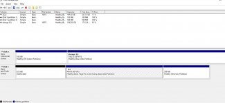

When you moved the OS onto the smaller drive did you run and all the updates including the optional ones and delete all partitions so you've only got one OS on the system
EmmaWilliamson688
i believe it was urself or one of the other awsome guys who advised me on this and afaik i did. This is what the partition is.

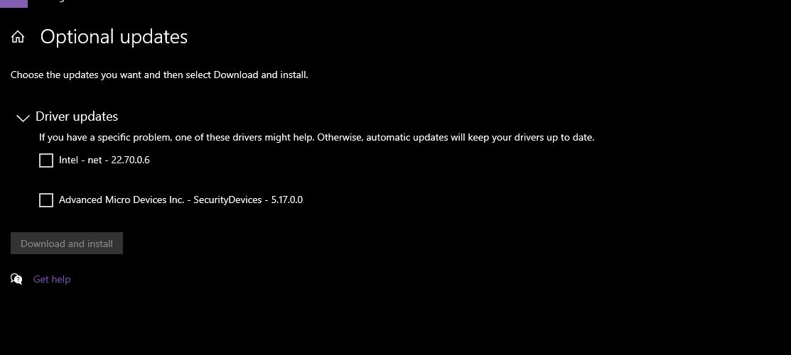

Can you post a screenshot of your windows udpdate page?

windows is up to date but when i click on optional updates it has this, i have no idea if i need them.
install them
Yeah, install the optional drivers.

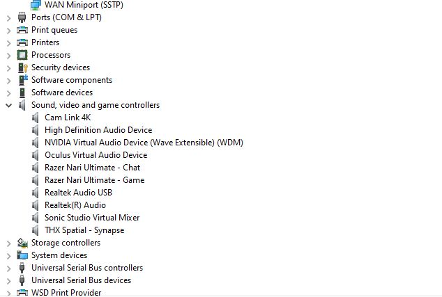

done! ok so il keep an eye on it but something else does bother me , i have asus gpu tweak installed, im pretty sure i dont need this?, i never used it, opened it up and it scared me lol but it does open up automatically on startup. I tried to uninstall it, it just wont , and there is no uninstaller in its folder so im not sure what to do with it. The sound stuff also annoyed me, I had that sonic studio installed, i think it updated with asus software but im not sure because i never used to have it. I uninstalled it through device manager and programs but windows is still adding one in itself. Windows also installs realtek but i thought that my motherboard was not realtek?
Attaching sound info anyway incase its useful , i have disabled the sonic, it keeps making it my default which i dont want. Infact most of the time i use my razer nari headset when gaming OR my benq monitor speakers for playing wow or watching/listening to youtube while i work.

Are you using and do you need that THX audio software? There are a fair few output devices there as well, I'd be tempted to disable the ones you don't use...
