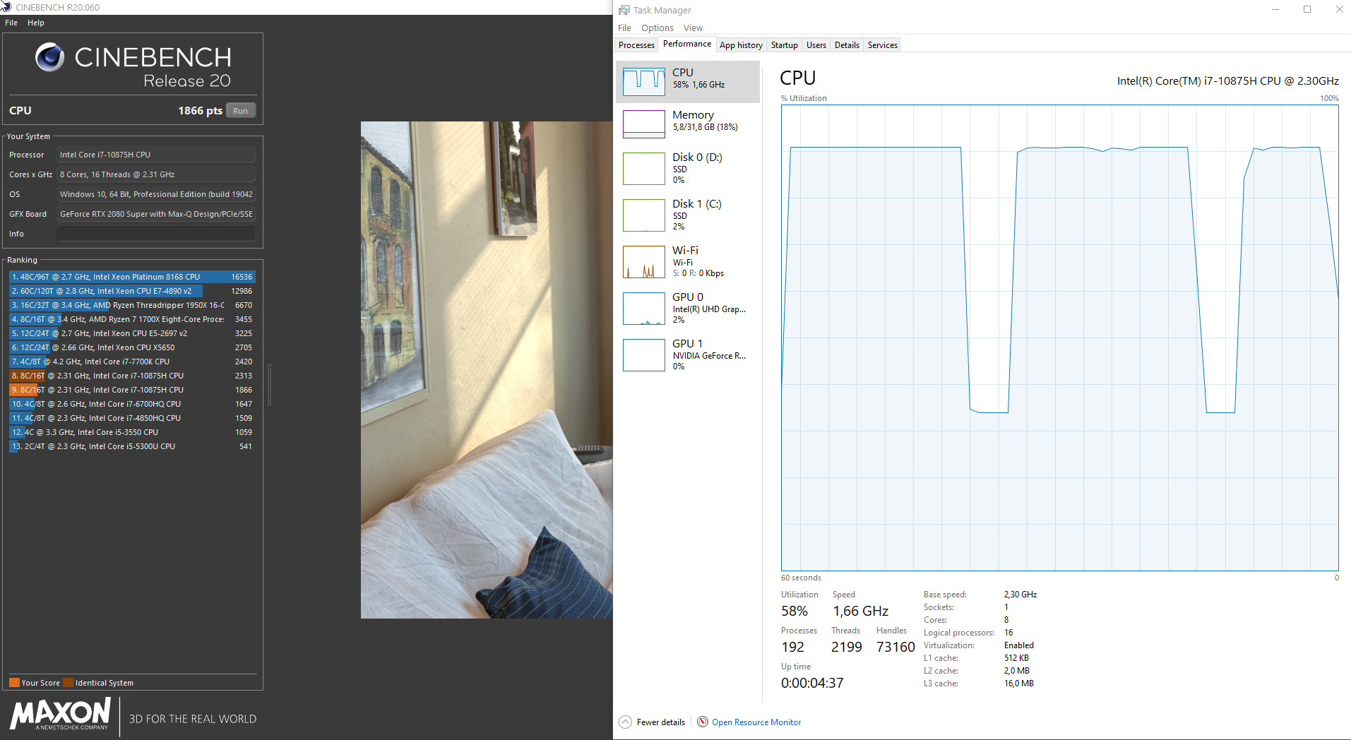

I've put the laptop through more testing and restarted it a couple of times and now I have the exact same problem as @GiuFam !
During a cinebench run I get random drops in the CPU clocks and lower cinebench results: 1866 points.
So yeah the EC update is pretty much useless...

Hi Everyone,
Thank you all for your feedback regarding this. I have given this to TongFang for further review as the beta of this EC did not exhibit this behaviour.

Hi guys,
I've been pressing for further information from TongFang about this issue. It looks like the power output of the battery is what's causing the issues at the deepest level. To quote directly from the manufacturer:
This phenomenon occurs because of the normal setting of our EC: once the current exceeds 6A, the battery may be burned down if the duration is long. To avoid this risk, when the current exceeds 6A, we will reduce all GPIO & Prohot & PL setting & D state, and everything will return to normal after 5 seconds.
This explains why we're seeing drops down to 800MHz on the CPU during heavy loads and a little about the whole system slowdowns on very low battery.
I'm asking for some form of resolution from them regarding perhaps reducing the throttling when current exceeds 6A or alternatively providing better batteries that are able to handle an increased current load.
That's all we have so far unfortunately. I'll relay on any major updates to you guys as and when they come through.
