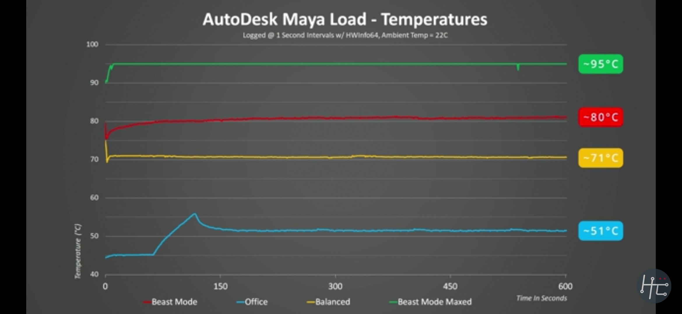

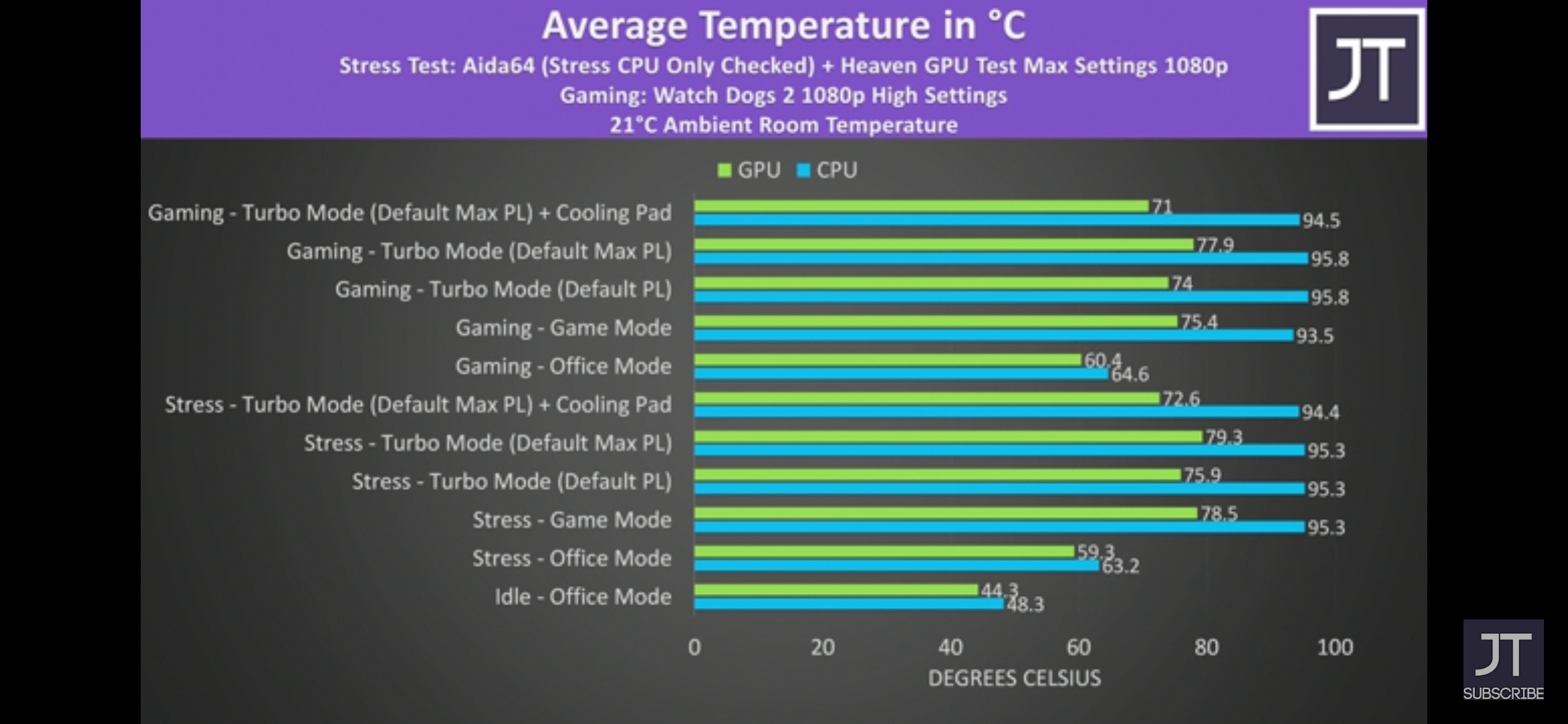

Looking at reviews for the same unit they also reach 95°c in tests so I'm thinking that is the norm and that a repaste might not improve matters much.My unit is pasted with Arctic MX 4 and is only 2 weeks old so dust shouldn't be an issue either.I will however repaste I think with Kryonaut as I used this on my previous Clevo with good reduction from standard paste.
See enclosed pics from Jarrod Tech and Hardware Canucks reviews showing temps at different settings.
As reducing CPU wattage does give me a much reduced temperature i will make some different profiles in Control Center for each scenario to keep my Cpu temps in check but still boost the GPU fully as those temps are fine.
