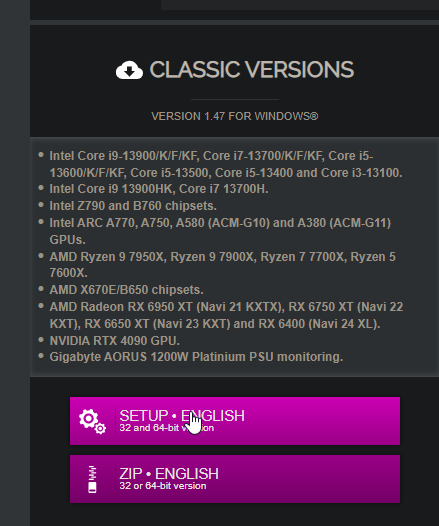

I would use this version, that one doesn't seem to highlight the breaches properly, I'm guessing as it's a trial version rather than the free version
Use the classic version

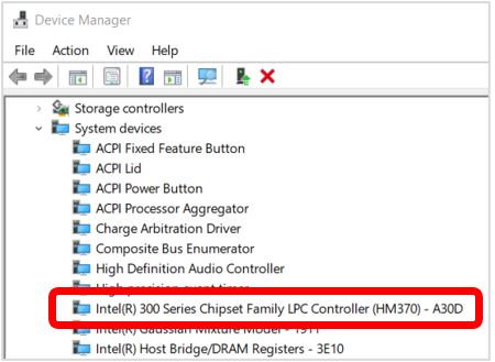

Easiest way would be to open device manager, that should show you what motherboard chipset you have
Then search that chipset number and driver and should be able to find it

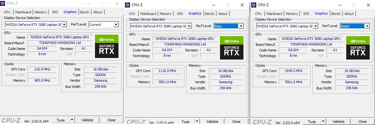

RMA has been requested but I wanted to post an other update: Results from GPUz and CPUz
Although I am starting to get a bit out of my element there seems to be something very wrong with the GPU currently set clock speeds. How does this happen and is there a way to correct it (if it isn't a hardware fault).
That's the thing, this is usually related to the PL values being reset by control center if it's an unsupported windows version (Windows 11), this is the same behaviour were seeing in that scenario where someone updates while having a Windows 10 version of control center installed and it causes issues.
The symptoms fit but you've not updated to windows 11, so this appears to be a new issue.

Yeah, the first thing that caught my attention was the GPU clock speeds - they absolutely should not be that low except maybe when idle, and they ARE causing your performance issues.
Earlier this year I had a similar issue (with Windows 10) where the clock rates would get stuck at their lowest, and the only way to fix them would be to flash the BIOS. I must have flashed the bios 3 or 4 times between February and May, then for some reason the problem didn't come up anymore (I don't know if this is just luck or if a Window update fixed it for good).
