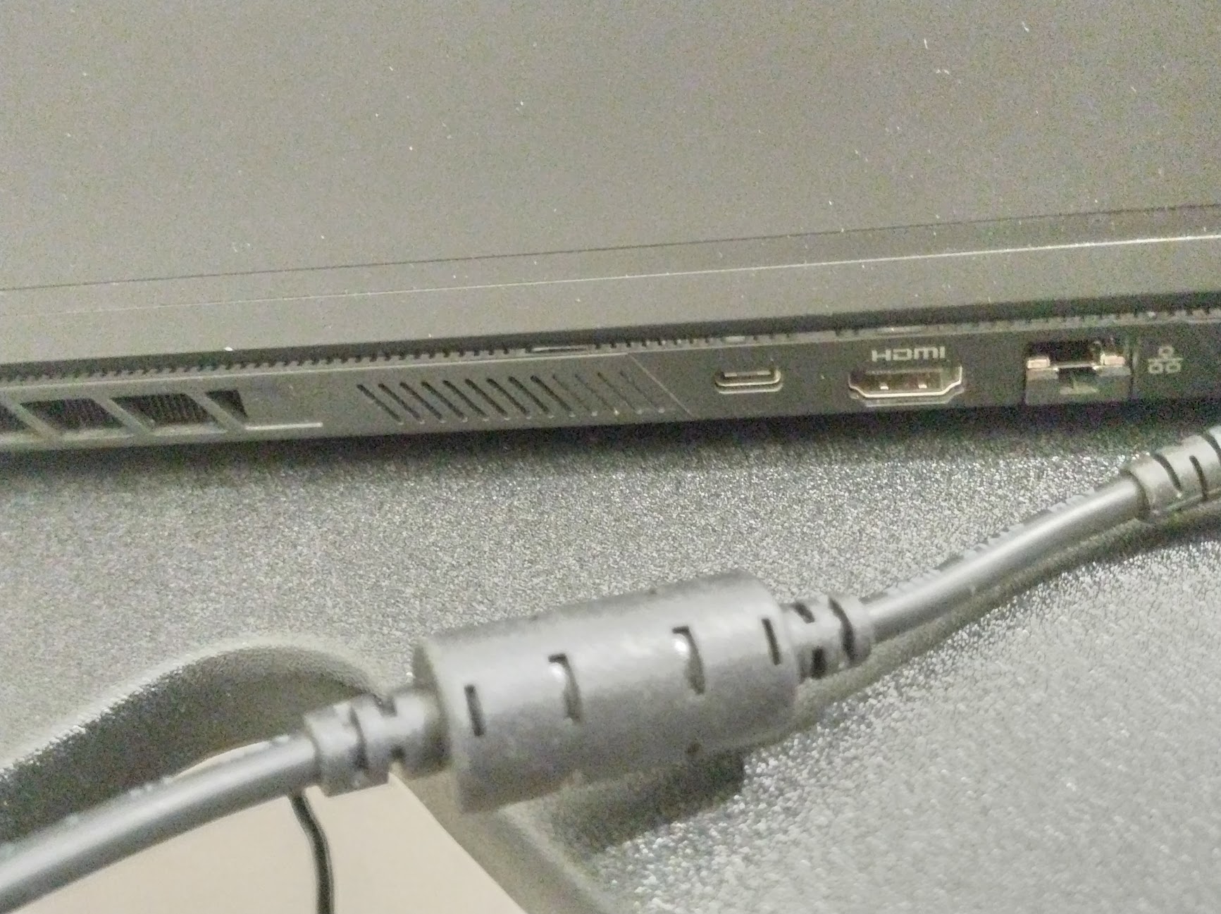

Is it definitely a USB C port though? Can you take a photo of the port without anything plugged in?
It's this port here
It was definitely working in that port yesterday 😅
Ok, I was getting confused because you said you'd made sure the Thunderbolt drivers were up to date, that has nothing to do with a USB port.
This is long winded, but sometimes can work, it's basically fully resetting and draining the charge on the motherboard.
- Turn off your laptop, unplug the power cable, unplug any USB-C.
- Press the power button for 30 seconds
- Reboot with the power.

Thank you :) that did it! all back up and running :)
