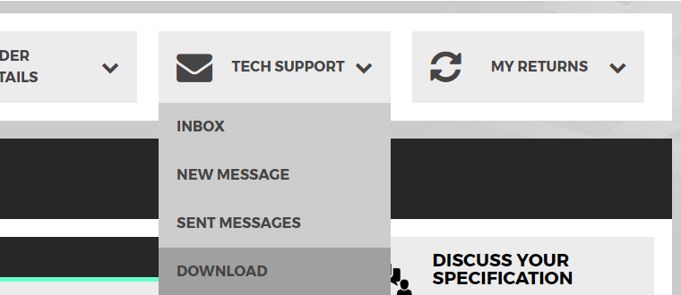

If you bought your laptop with windows installed, then you will have the control center (or gaming center, it's either one or the other) already installed. If not, login into your account on PCS' main website, go to the downloads section and there you will find the files to install the control / gaming center.
In my case, it's called "06_ControlCenter_W10.zip" , but it can be slightly different on yours. Once you have the tool installed and running, you can switch between the different power profiles, "quiet" (also sometimes called "office") being the one that will make your laptop run.... well, quieter. If that is still not quiet enough (I doubt it), you can go to the fan control part of the tool and create your custom fan curve, according to your needs.
Just keep in mind that whenever you need more processing power (like gaming, editing, etc), you will need to change the profile to entertainment (or gaming) mode, as quiet/office will make your CPU a bit slower, but still powerful enough for most daily normal tasks (browsing, streaming, music).
