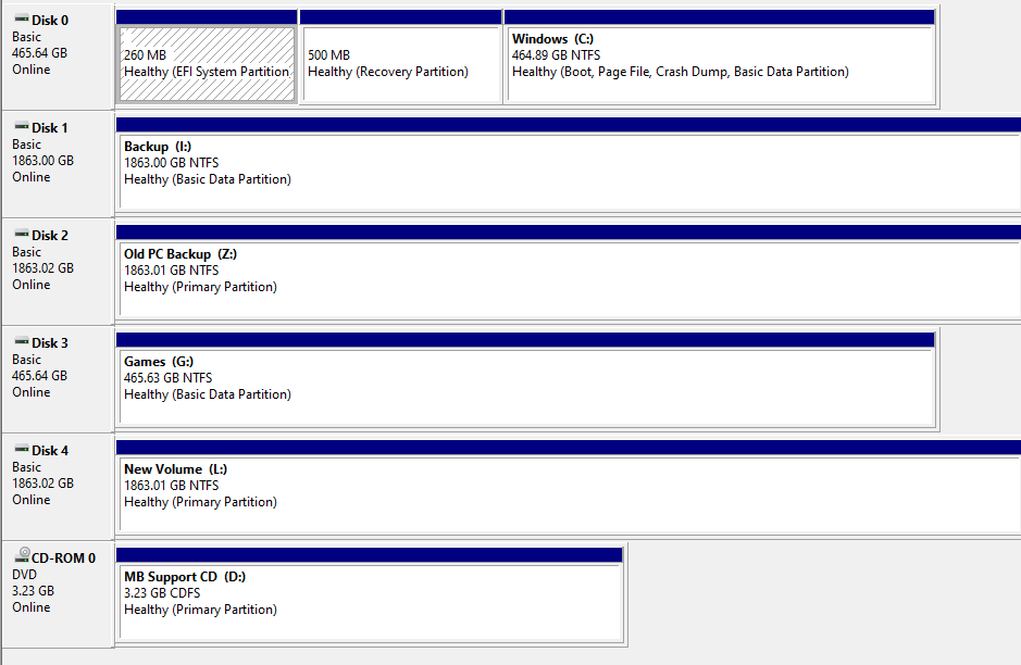

How full is HarddiskVolume4? If you open Disk Management (right-click on the start icon at bottom left and select Disk Management from the menu) HarddiskVolume4 will be listed as Disk 4 in the graphical display in the lower pane there.
macjim
My current disk setup
Disk 0 - 216 GB free of 464 GB - Firecuda SSD (PCS orig)
Disk 1 - 471 GB free of 1.81 TB - Seagate Baracuda HDD (Internal) ( Added from old PC)
Disk 2 - 251 GB free of 1.81 TB - Seagate Baracuda HDD (Internal) ( Added from old PC)
Disk 3 - 101 GB free of 465 GB - Samsung 850 EVO SSD ( Added from old PC)
Disk 4 - 304 GB free of 1.81 GB - Seagate Baracuda HDD, disk is from Old PC but no slots left on new PC - it sits in a USB3 docking station

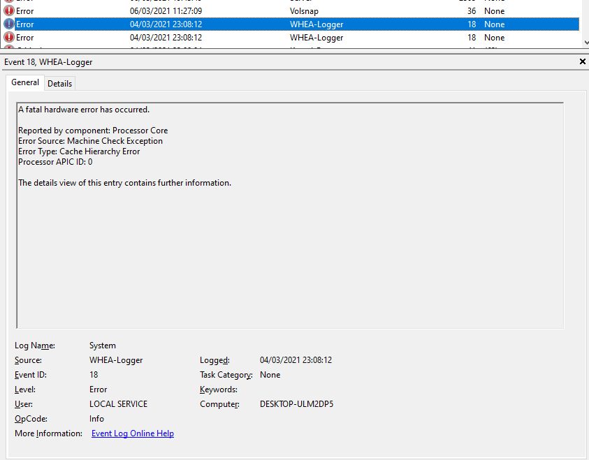

The kernel dump is a SYSTEM_SERVICE_EXCEPTION stop code, which is almost always a driver. In this case the dump is very (unequivocally even) clear that the driver in question is ladfGSS.sys, which is a Logitech driver.
In my experience Logitech make great hardware and simply awful software. I'm not sure what Logitech product that driver is for, though it seems to be related to a Logitech headset? If there is any way to run your Logitech devices using the built-in Windows drivers you'll find it much more stable and reliable.
I can also see several Symantec drivers in the dump. What Symantec product are you running? It doesn't look like Norton? Symantec don't have a particularly good reputation (like Logitech really) and unless you really need this product I would uninstall it.
In your System log there are two WHEA failures. WHEA is the Windows Hardware Error Architecture and these report a hardware issue. The error they are reporting is identical to the error that those suffering from the AMD and 4 RAM sticks issue see.
I really would contact PCS and see whether the updated BIOS addresses this issue.

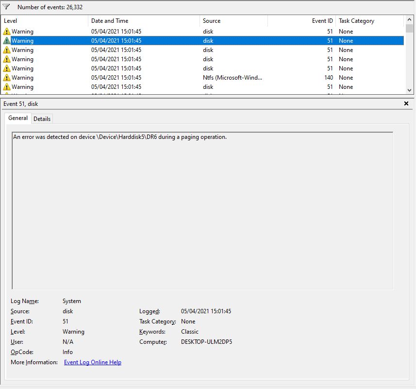

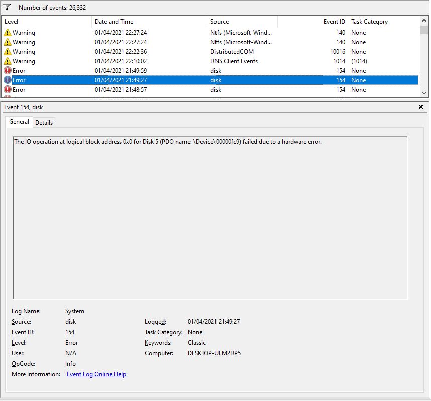

Can you upload the system and application logs please? The error 41 just indicates that Windows didn't shutdown properly, it's got nothing at all to do with power. It really just means "the kernel detected that the power went off unexpectedly", nothing else.
https://www.pcspecialist.co.uk/forums/threads/when-youre-seeking-help-with-a-bsod.71885/#post-568901

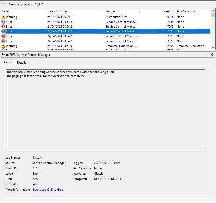

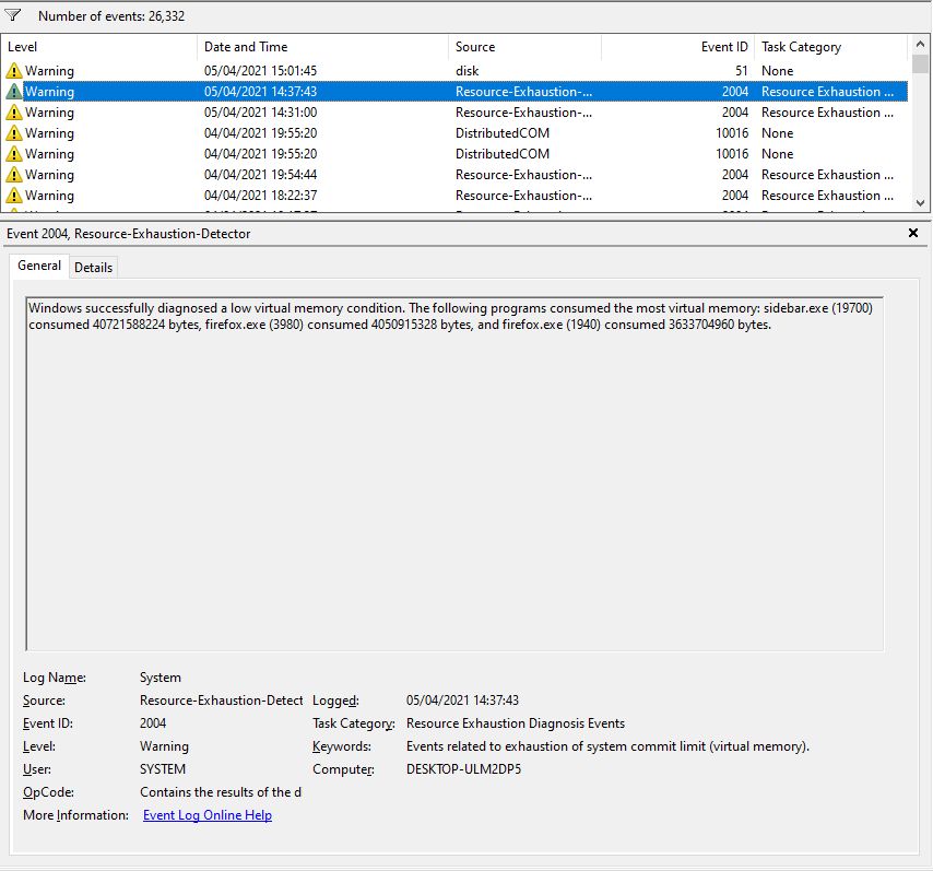

It looks like you have a drive failure with whatever device is Disk 5. There is a slew of errors for this disk like this one....
That may be the root cause of a virtual memory shortage, it seems your paging file is too small...
I suggest you run a chkdsk on whichever drive is Drive 5 (use Disk Management to find out). If it's an SSD use chkdsk /f and if it's an HDD use chkdsk /r).
Also set your paging file size to be system managed.
macjim
Ah, that's my K: drive - a 32Gb Sandisk Thrumb drive.
I have a KVM which I use to share my Mouse, Keyboard & this drive with my Desktop(PCS) & my work laptop.
I assume when I switch to the laptop using the KVM, the drive goes missing in the PC system & that's why it complains.

Paging file is 28.7 GB, managed by the system e.g.
