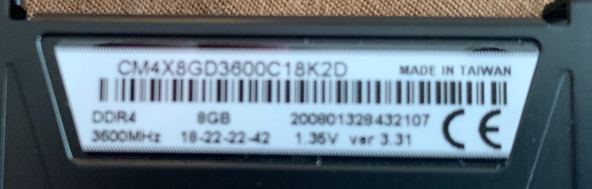

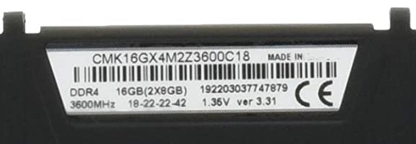

I added another 16GB of 2x8GB, DDR4, 3600 MHz, 1.35V, same CAS Latency 18-22-22-42
Slot 1 - CMK16GX4M2Z3600C18
Slot 2 - CMK16GX4M2Z3600C18
Slot 3 - CM4X8GD3600C18K2D
Slot 4 - CM4X8GD3600C18K2D
Slot 3,4 are the PCS supplied RAM
PCS Original
New(Amazon)

The RAM does report back on Memtest86 as different CMK16GX4M2Z3600C18 (Amazon) & CM4X8GD3600C18K2D ( PCS original)
When you go to Corsair's web page, it finds CMK16GX4M2Z3600C18, but not CM4X8GD3600C18K2D.
The memory does appear identical in appearance and specs for access & Voltage, Speed, etc.
Spookily enough when I pasted CM4X8GD3600C18K2D into google, this popped up https://www.pcspecialist.co.uk/forums/threads/faulty-ram.75252/ - It appears this is not an uncommon e.g. the names do not to match
After all Passmark website finds CM4X8GD3600C18K2D(PCS) as Corsair memory, but not CMK16GX4M2Z3600C18(Amazon) :rolleyes:

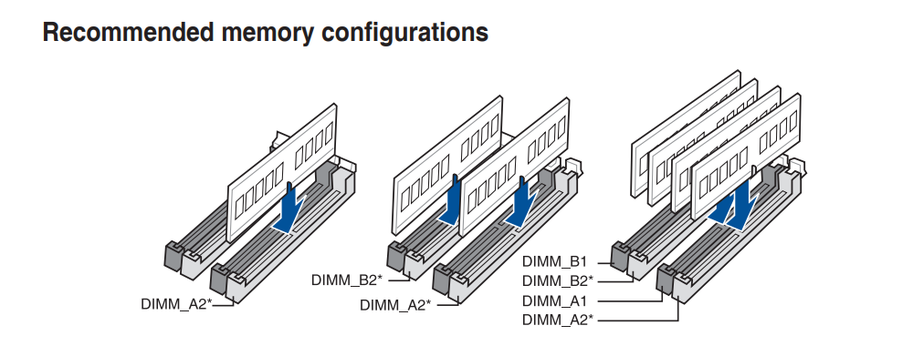

NoddyPirate
I know this is probably a silly question - so really just for my own sake - I assume you have the two remaining sticks in the correct slots for a two stick config?
macjim
Yes, in slot 2/4:
wmic memorychip get devicelocator, capacity, speed
Capacity DeviceLocator Speed
8589934592 DIMM_A2 3600
8589934592 DIMM_B2 3600
