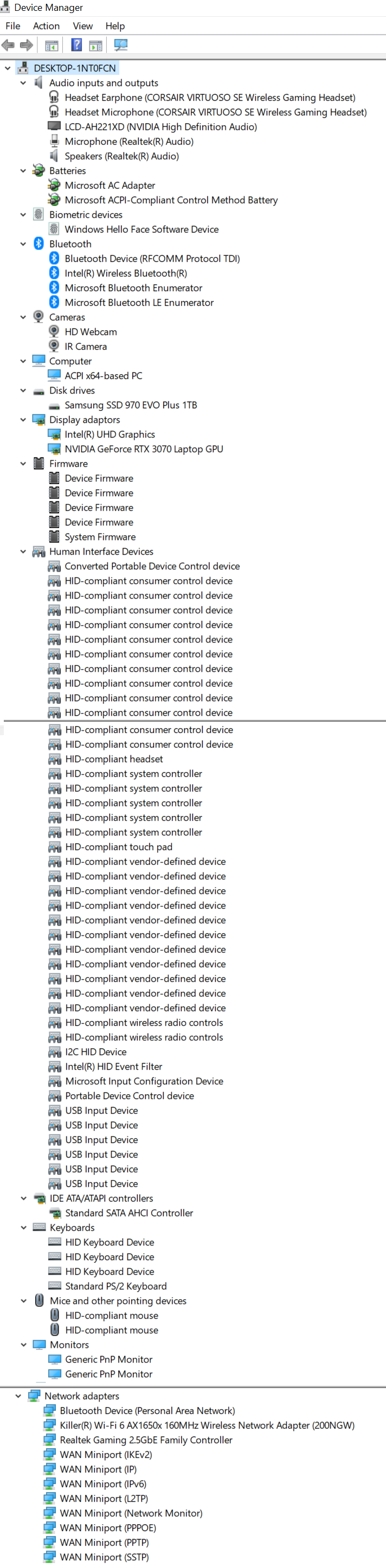

Also here is a screenshot of device manager, I think this is what you wanted?

connmal
It looks like I didnt have my chip set drivers. Should I do a windows reinstall again and install all these properly? I think you're right I buggered up the driver installation when I reinstalled windows
barlew
I would start from scratch. Especially as you installed that Driver fix. You don't know what it's done.

And this confirms it. The little warning symbols are devices which haven't been installed. I think base system device is usually the chipstt driver.

As above, none of the chipset drivers are installed which will cause no end of issues.
Wipe drive entirely
Install Win 10
Install chipset drivers

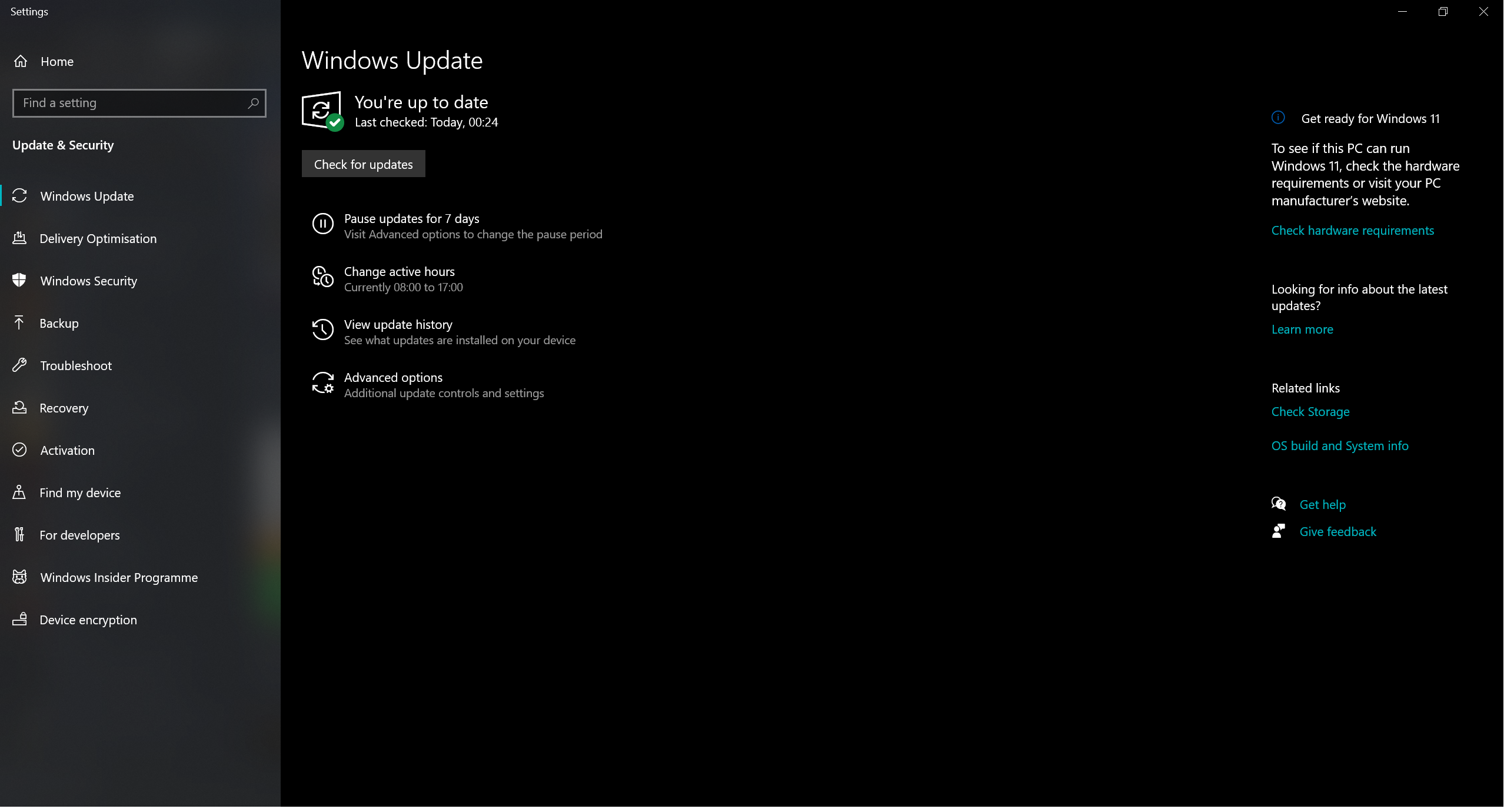

Could you take a screenshot of your Windows update page?

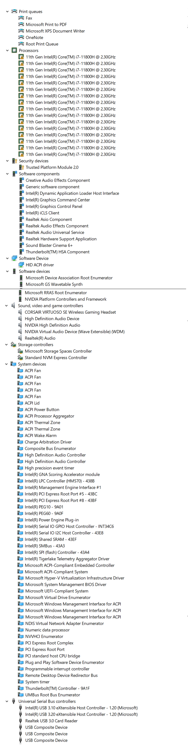

Sourced all drivers from pc specialist site. And it seems like all devices are accounted for on the device manager. Here is a screen shot. Also with the windows update page
I have never seen warning symbols against the CPU in device manager like that. And each time you run Fire Strike it throws warnings about your GPU.
*edit* - What does information box say when you double click on one of the CPU icons with the warning?
