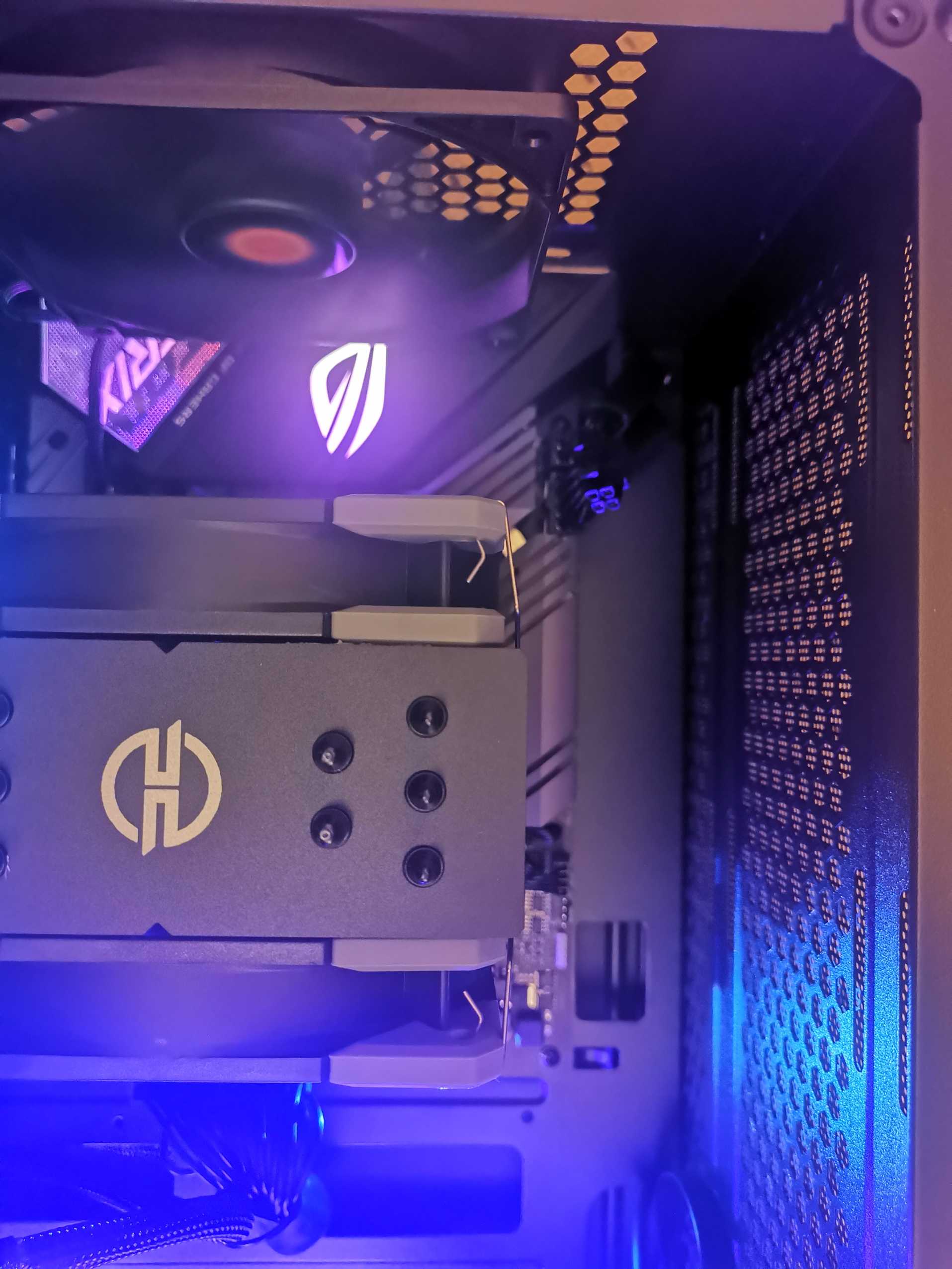

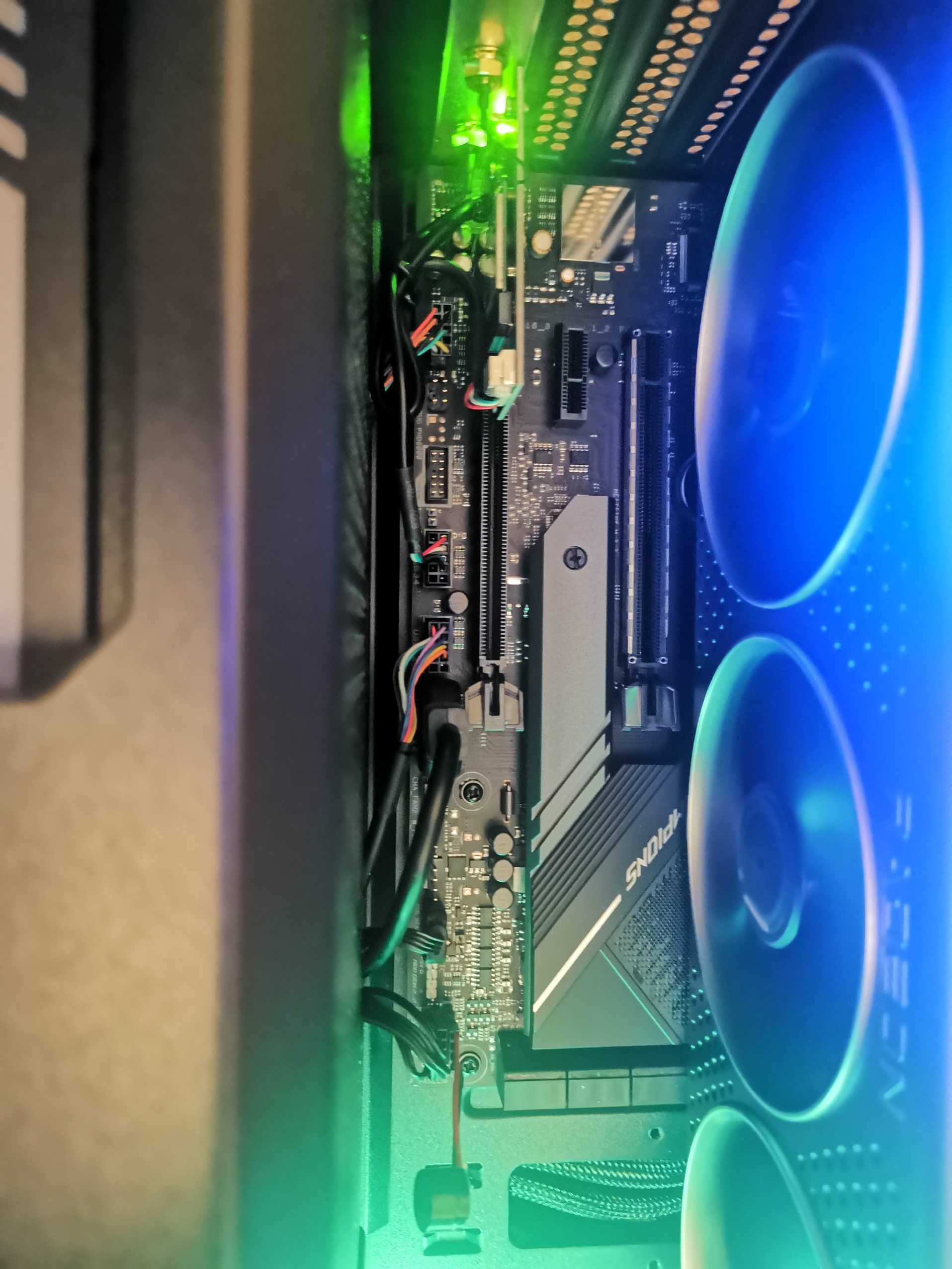

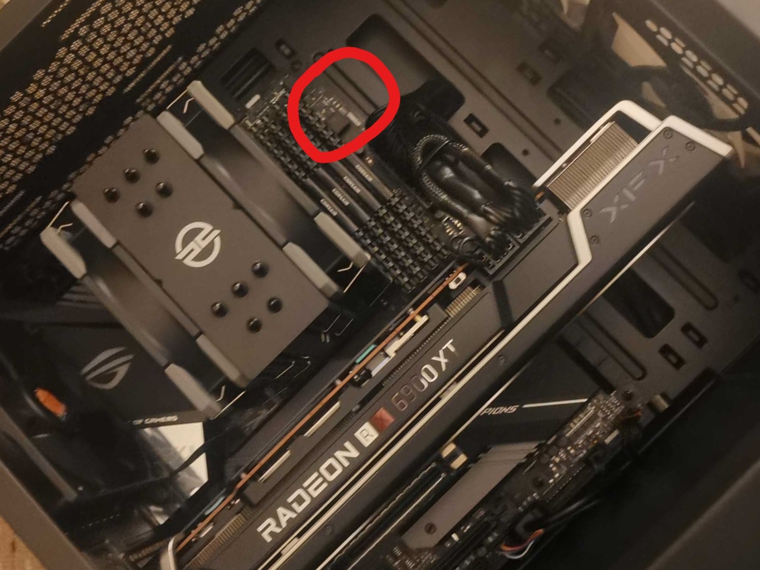

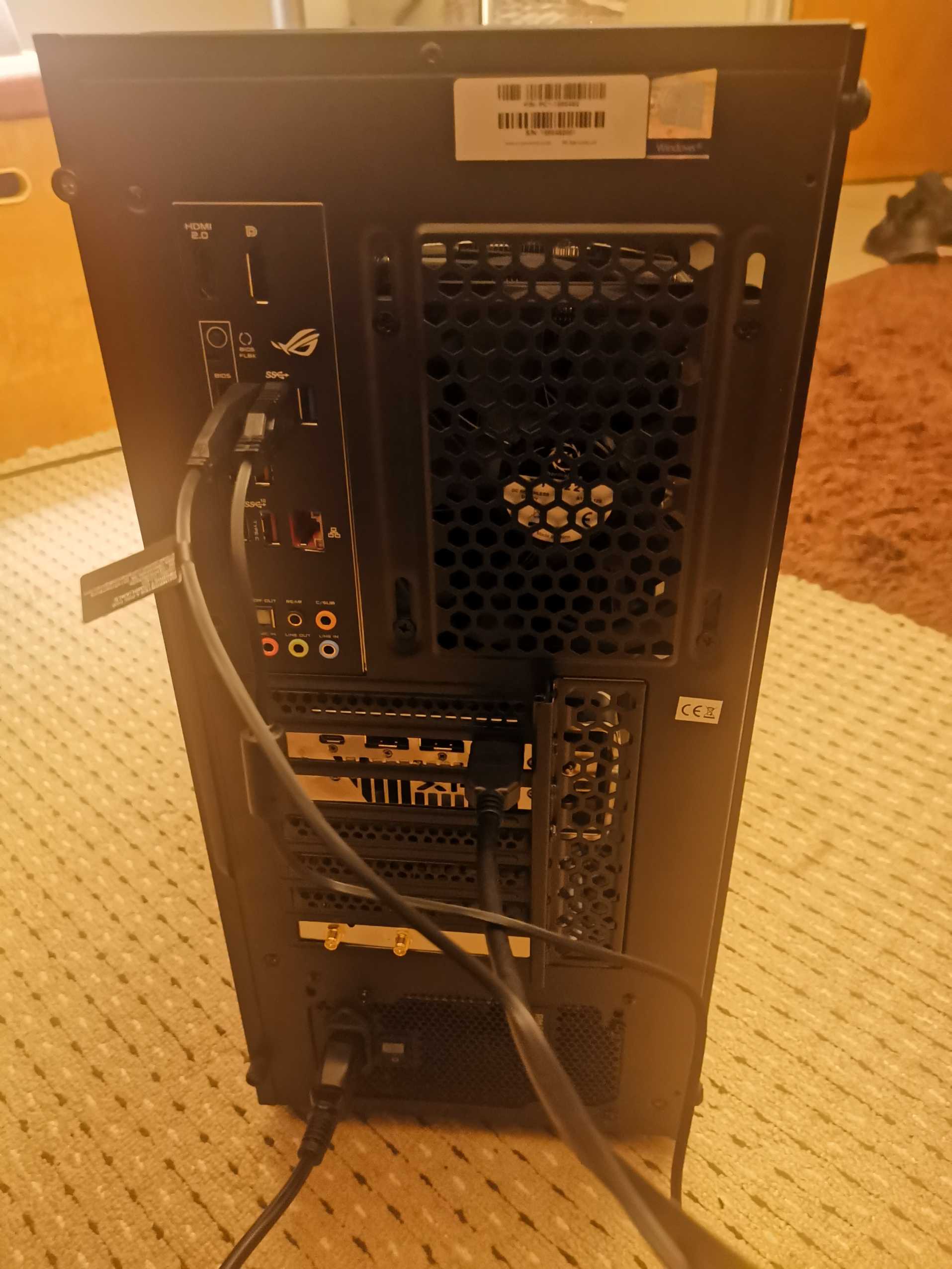

I attached some pics for you. Top left of the chassi - some dangling wire. Not sure if that needs to be in somewhere.

ChaAli
I'm sorry - but im real bad with wiring. I have no prior experience in building. I can do the basic stuff or whats basic to me say.
So top left - I have two seperate wires going in. I assume the thing hanging out is the splitter.
Sorry if im talking rubbish - but i think that's what you are referring to.
A splitter is just that, it's one cable that leads to 2 rather than 2 individual cables.
It's fine if it's 2 cables with just 1 part of the splitter in each port, but if it's only a single cable with both ends of the splitter plugged in then that's your problem.
