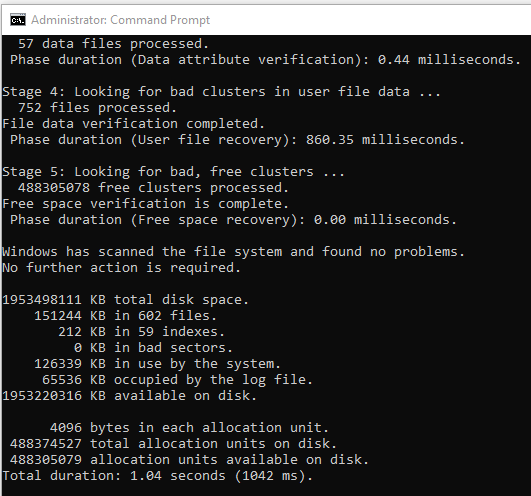

Unfortunately that was on the wrong drive, that's been done on the 500Gb Samsung which I presume is your C drive.
You need to do it on your 2TB HDD drive.
NoddyPirate
But I specified D 🤨
What I run was chkdsk D: /r
I think you’re OK?
4096 bytes per unit - 488,374,527 units - makes 2 by 10^12 bytes = 2 TB.
I think you’ve done it on the correct 2TB HDD.
(EDIT - actually it’s even easier than that - your screenshot says 1.9 billion kB total space - so you’re good!)
I think you’re OK?
Yeah size on disk is 1953220316 KB which is 1.953220316 TB approx
My bad, I was reading through too quickly and read the clusters instead of the disk size, sorry about that!
That's more positive then, the physical drive is fully intact.
Try reseating the connectors. The fact it also passed a crystal disk scan, I wonder if the motherboard is getting a false positive somewhere. I would still raise it with PCS either way though just in case.

The SMART data doesn't give me any cause for concern. There's nothing in there that would indicate imminent device failure. Are you sure that's the drive the SMART error was referencing?
The chkdsk /r also shows no cause for concern either. :)

It was definitely on the 2TB HDD also....
I turned off last night after running chkdsk, this morning I re-connected the SATA cables and I booted the machine 3 times...in all 3 the boot went fine. As NoddyPilot has suggested, I will leave DiskInfo installed and run periodically for a while - even if no message shows up after booting. I will also l get in touch with PCS as you pointed out.
Yeah, the message was very clear to state that the problem was in the SATAG6_6. The fact that neither the software or the command found any problem I will take it as a good sign.
