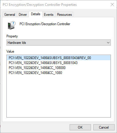

So this is what they asked me to send (I could find this under Device Manager) and after I sent this they replied saying my chipset needed updating:
This was basically showing up as some kind of mystery device and was flagged in Device Manager for having no driver. This was after a clean install of Windows with all updates installed.
They sent me a link to my motherboards website (in my case I have a ROG Strix x570-f) and I was able to download my driver from there.

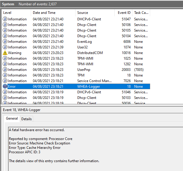

So I've just had another unexpected crash while using Netflix in Firefox. This is with the new chipset drivers installed. Event viewer brings up the same error message.

Not to pour cold water on your troubleshooting, but that looks like the processor cache error we were getting with 4 x 3600MHz RAM cards in an AMD build. I'd need the kernel dump to confirm though.

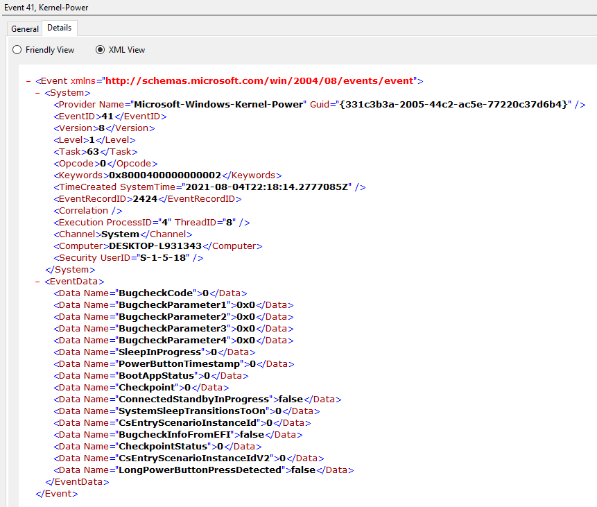

I'm not sure if the following screenshot is of any help in relation to confirming that?
That is the PCI encryption/decryption device, it's driver is indeed part of the chipset driver package. TBH I'm puzzled as to how that driver could have been missing in the first place, although as has been mentioned, we know that Windows Update doesn't currently seem to be installing the best AMD chipset drivers....
WHEA is the Windows Hardware Error Architecture and that is triggered when there is a hardware fault, but the logs tell you very little about the error. I'd need to see the kernel dump which should have been written, it will be in the file C:\Windows\Memory.dmp. Please upload that to the cloud somewhere with a link to it here.
The 41 error is unimportant, it just tells you that Windows wasn't shut down properly. It's called Kernel Power because it indicates that the power was disconnected before the kernel had shutdown.
