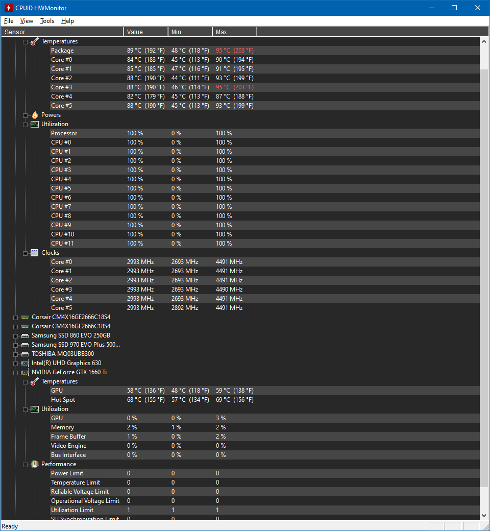

I did a fresh install, for Windows 10 21H2 and even installed the preview update.
I also installed the Gaming Centre, and put it in "Game" mode.
I ran prime 95 for 10 minutes, I pressed Ctrl+Print but it only captured the HWMonitor window (attached), I also took a photo in case the screenshot did not work, it is here: https://drive.google.com/file/d/17JC8jpD7Mri-UNlVz0JZGb0_Pp7qFLP9/view?usp=sharing
Then I ran FurMark and recorded a .gif (turned out too large) which shows the Power Limit triggering, the .gif is here https://drive.google.com/file/d/19UvwZpvKDJNtFXurpjCK9JCqaIJ2ZEZH/view?usp=sharing
