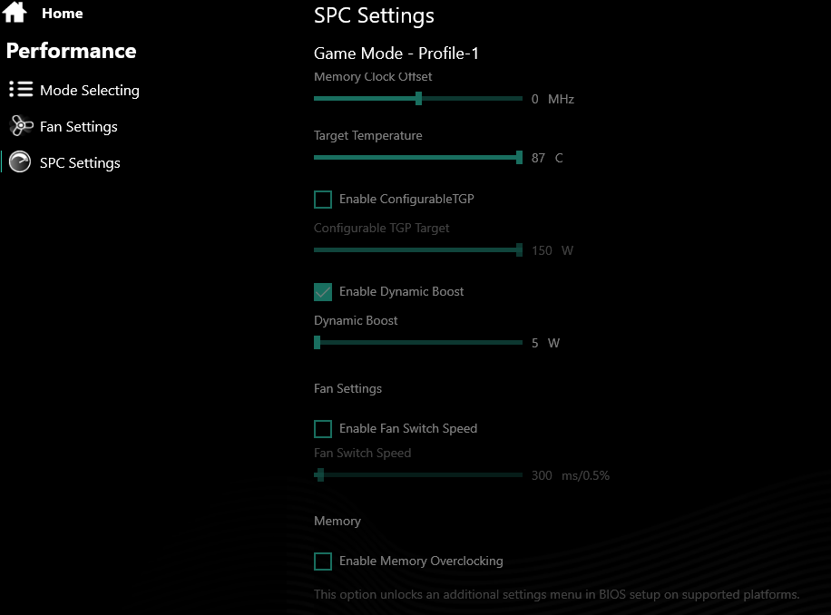

It is the power allowance setting for the GPU . You should have it in your Control Center , usually at the Performance icon .
I’ve never touched settings on Control Center, only switched thought Office and Game mode, the standard profiles...and never Tried the Power Mode

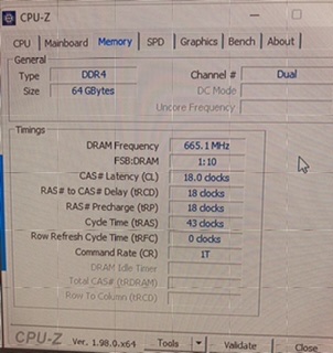

UPDATE: concerning my RAM problem, I downloaded CPU-Z and this is The values for my RAM (665.1 MHz):

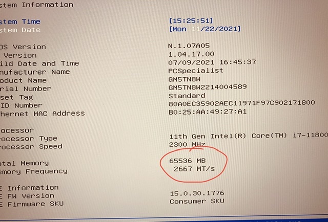

And it all seems weirder when I check my BIOS, displaying The following values:
So...it seems that my BIOS displays my RAM with the correct mhz value of 2.667 MHz, while in Windows 11 my RAM runs at 665x2= 1330 MHz 🧐
I really do not understand what is my problem...hardware? Software? BIOS? It’s kinda mistery! Please help me to solve it! 😰😰😰

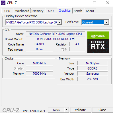

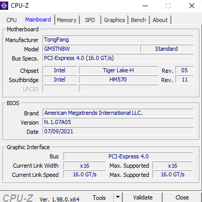

Notebook Recoil 15,6 - Intel® Core™ i7 11800H octa-core, 64GB RAM DDR4 SODIMM Corsair 2666 MHz, GPU GeForce RTX 3080 16 GB, SSD SAMSUNG 970 EVO PLUS M.2 500 GB + SSD M.2 NVMe PCIe da 2 TB INTEL® 670p, SO Win 11 Home 64 bit - Monitor LG 27GP850 UltraGear.

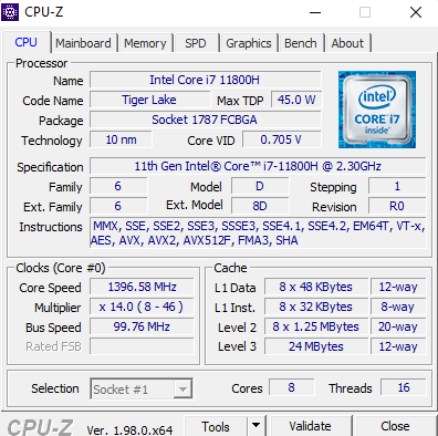

For more info, here u r the CPU-Z infos on my system:

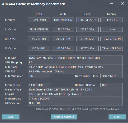

I did also some test with AIDA64 (Trial), with energy on Maximum Performance, as it follows:
I hope it helps to give u a better idea on my specs...and help me to find a solution...since I wrote 2 days ago to PCSpecialist support, through my account, but they never answered me! :(

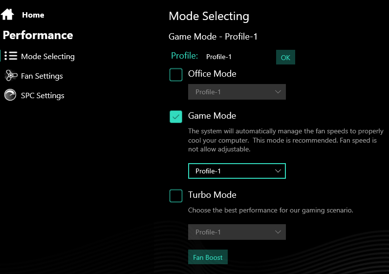

Could you post a screen of that control center configuration? Just wanted to double-check if I understood this correctly.
Here u r my control center options. Please note that:
- I never touched the settings of any of the pre-setted profiles (all default)
- With ALL profiles (Office, Game and Turbo) the RAM always go on 1333 MHz frequency (i.e. 665.1 x 2, checked with CPU-Z)
and the settings of Game Mode profile I use for benchmarks:
View attachment 30674 View attachment 30675

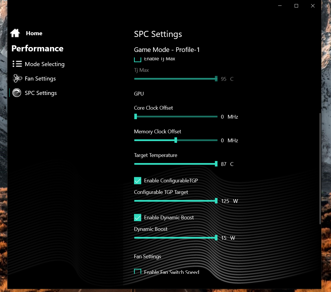

KriSta
The settings I`m using is shown in the screenshot below . As you can see i`ve enabled the full performance and power allowance for my GPU .
KriSta
Mhhh I Guess that, if I copy this settings, my temperatures, already high on my system, will slyrocket to meltdown :(
I would also suggest in order to reduce the heat on your CPU , lower PL1 to 35w and set PL2 to 55watt . This will make the CPU to use up to 35 watt power nominal and 55 watt boost ( turbo ) as I`ve understood the settings . This will ge some room for enabling more power to the GPU without melting the laptop.
That's not a fix though, that's just nerfing performance. I would suggest you want to address the cooling issues rather than masking them.
