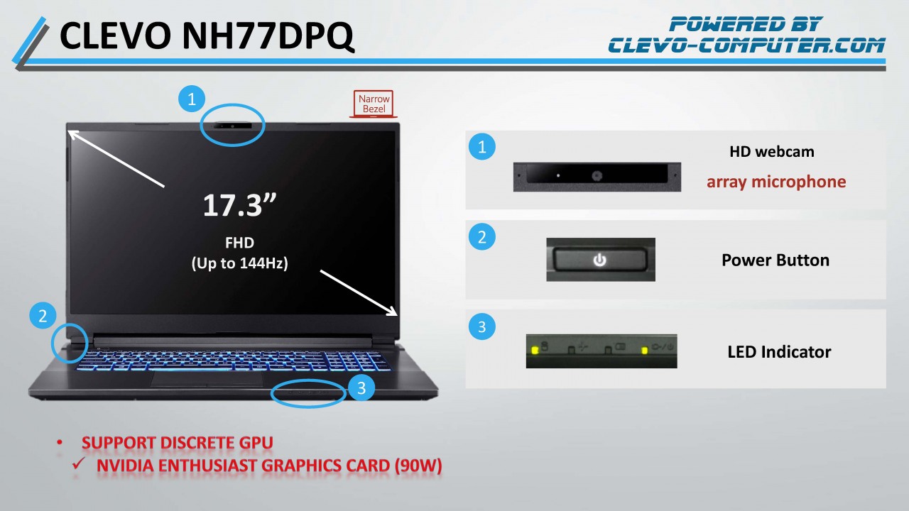

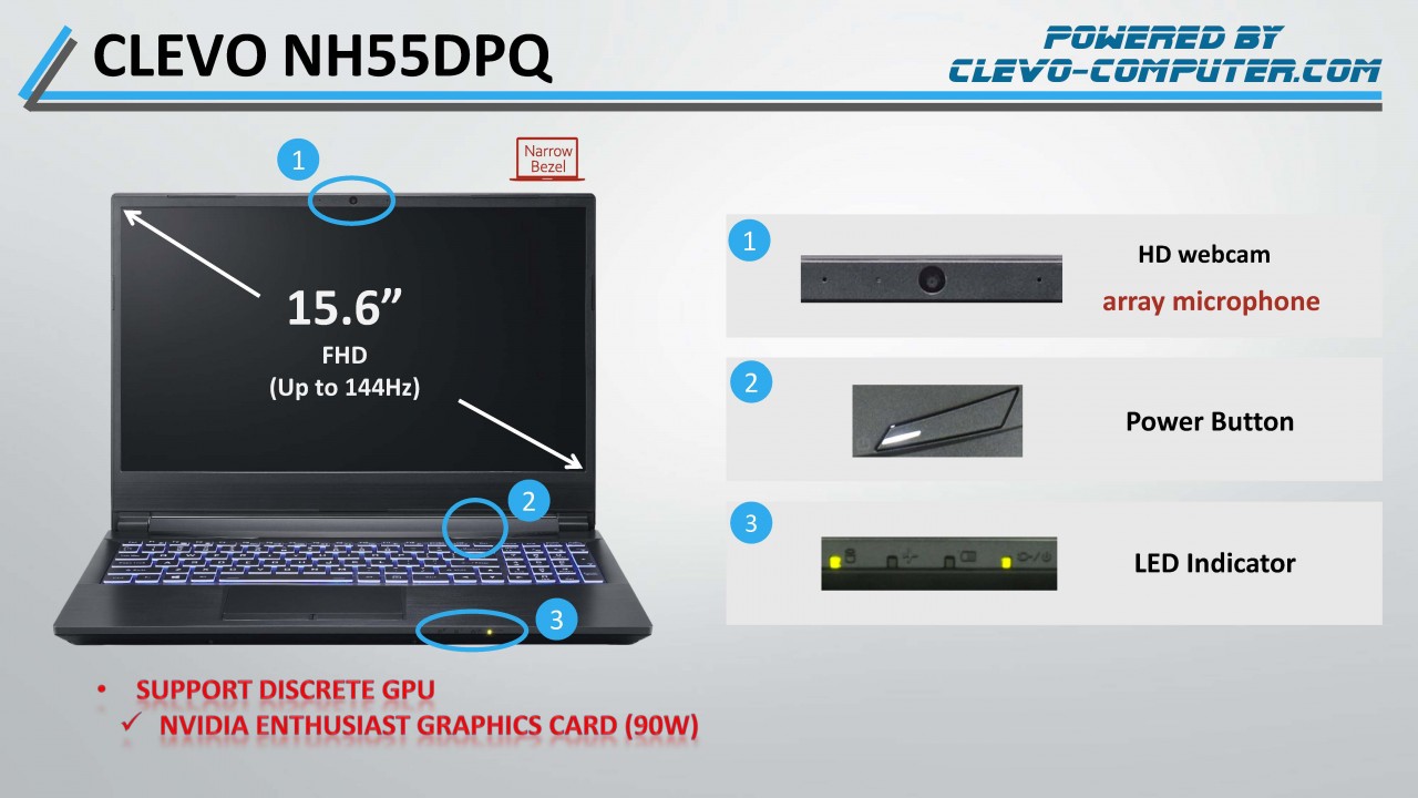

I found these on clevo-computers.com for both the 15" and the 17" barebones. Looks like they are both 90w
CLEVO-NH55DPQ-FHD-15-6-IPS-144Hz-INTEL-CORE-i7-10870H-NVIDIA-RTX-3060-SPECIFICATIONS-DESIGN-PO...jpg
CLEVO-NH77DPQ-FHD-17-3-IPS-144Hz-INTEL-CORE-i7-10870H-NVIDIA-RTX-3060-SPECIFICATIONS-DESIGN-PO...jpg
Macco26
Expert
Deinitely they are 90W + max 15W Dynamic Boost 2.0, totallying up to 105W, whenever the GPU is in the need, AND the CPU power is below 35W.
