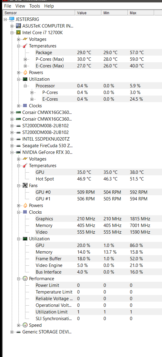

Installed HWMonitor and took screenshots of the results
First is after 5 minutes idle with just Firefox open.

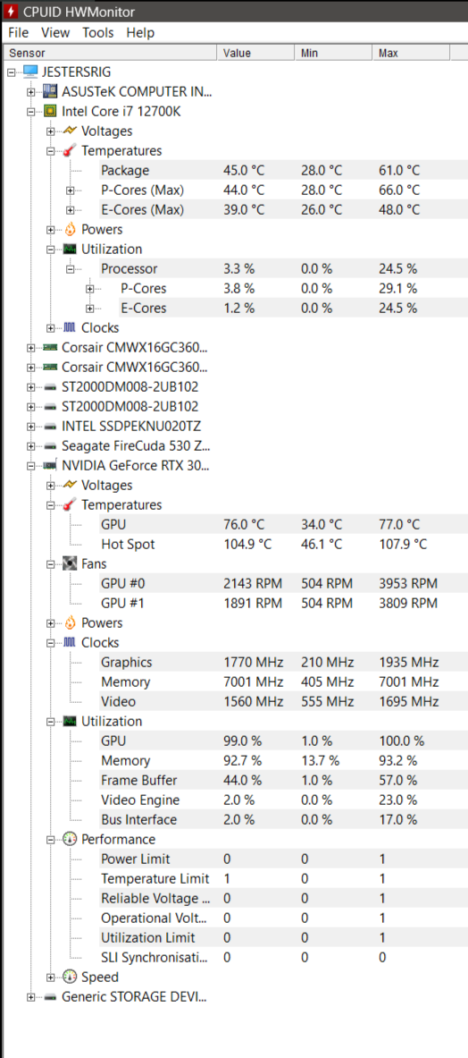

Second is with Assassins Creed Valhalla (just because it's the latest game I bought) running @1440p per the settings from DeForce Experience, after 5 minutes.

Yeah, it's definitely the GPU IMO. How long have you had the build? Is it still within warranty? I would contact PCS regarding it as the GPU would likely be within warranty on its own, even possibly outside over the overall warranty.
It's possibly just down to the TIM on the GPU chip, but this isn't something you would typically need to maintain so seems like an issue to me.
