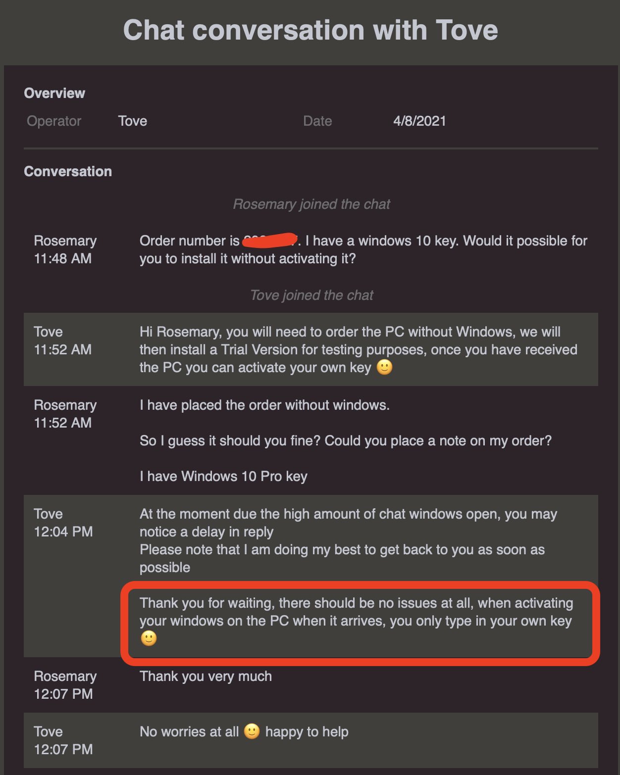

I'm fully capable of installing and reinstalling the OS myself. I have built custom PCs myself from scratch and the installed OS. I read the information on the website as @NoddyPirate quoted. It's after that I chatted with them. See attached below. I'm frustrated that when I asked PCS to confirm confirmed it was a test OS but asked me to activate it without any reinstallations.

PCS replied ' it is a full standard version of windows just like if anyone downloaded windows and installed it without activating it. All putting your key in does is activate it. You don’t need to re-install etc'

OK. Interesting reply really - they didn’t install the Pro version which is what you told them you wanted. So you’ve got an upgraded Pro from Home rather than a clean Pro install.
I think we would all recommend a clean install regardless.
But if you’re happy then life is good.
