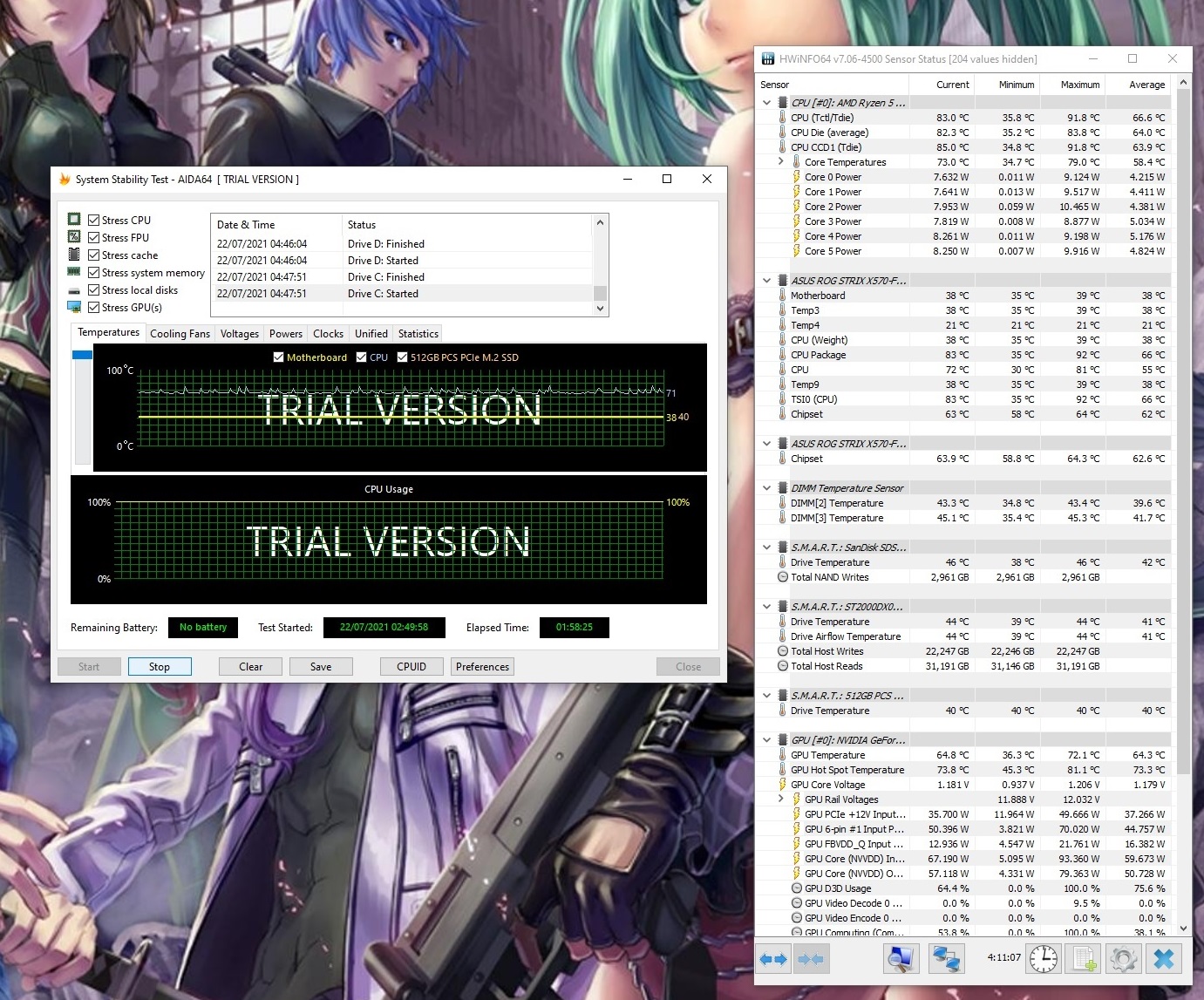

I've added an attachment to this showing temperatures during a stress test over a long period. As I had no issues with it shutting down in this time, I will look into what you suggested regardless, it may still be an issue some way or another.
Thanks very much

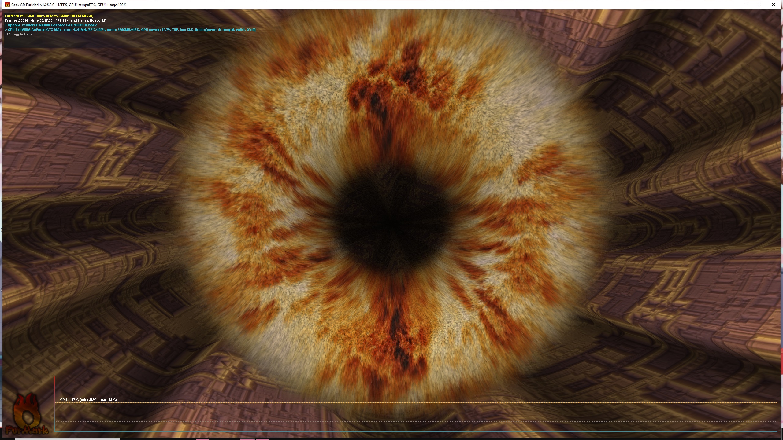

Furmark did not cause a system shut down, the same as the other test also did not cause a shut down. Both tests were done with the case put back together so it seems as though overheating isn't the issue.
I have added results of Furmark in an image attachment.
