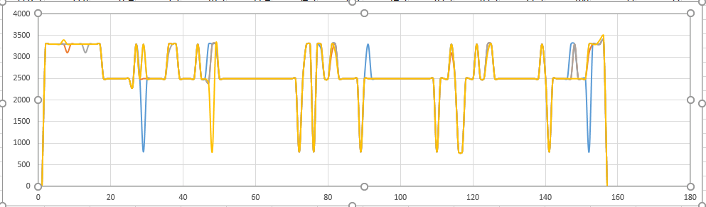

I ran the game and logged the cpu frequency. Couldn't log the FPS of the game with it. It shows the frequency drop. Don't know why. I run aida64 and it says 100% there.

okay i monitored the CPU frequency. And indeed the CPU is the problem. When i start crysis 3, the CPU is at 3.2 Ghz but while playing game during the FPS drops, the CPU frequency drops to 2.4 Ghz and 700Mhz. The temps are fine. When I run aida64 it says 1% throttle due to over heating. Any idea why it is doing this?
