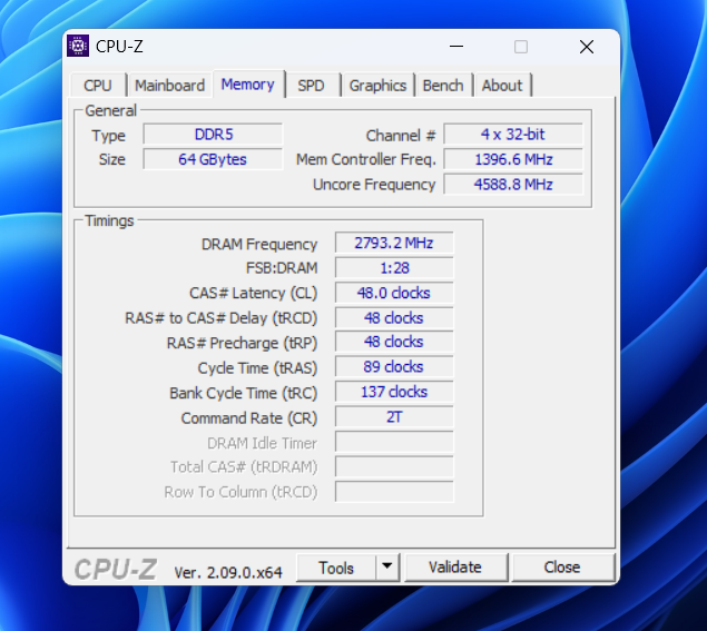

Thanks Paul, I have just changed the RAM and I don't know if the frequency is as it should be. I'll attach photo from CPU-Z.
I have installed the second SSD once I bought the machine.

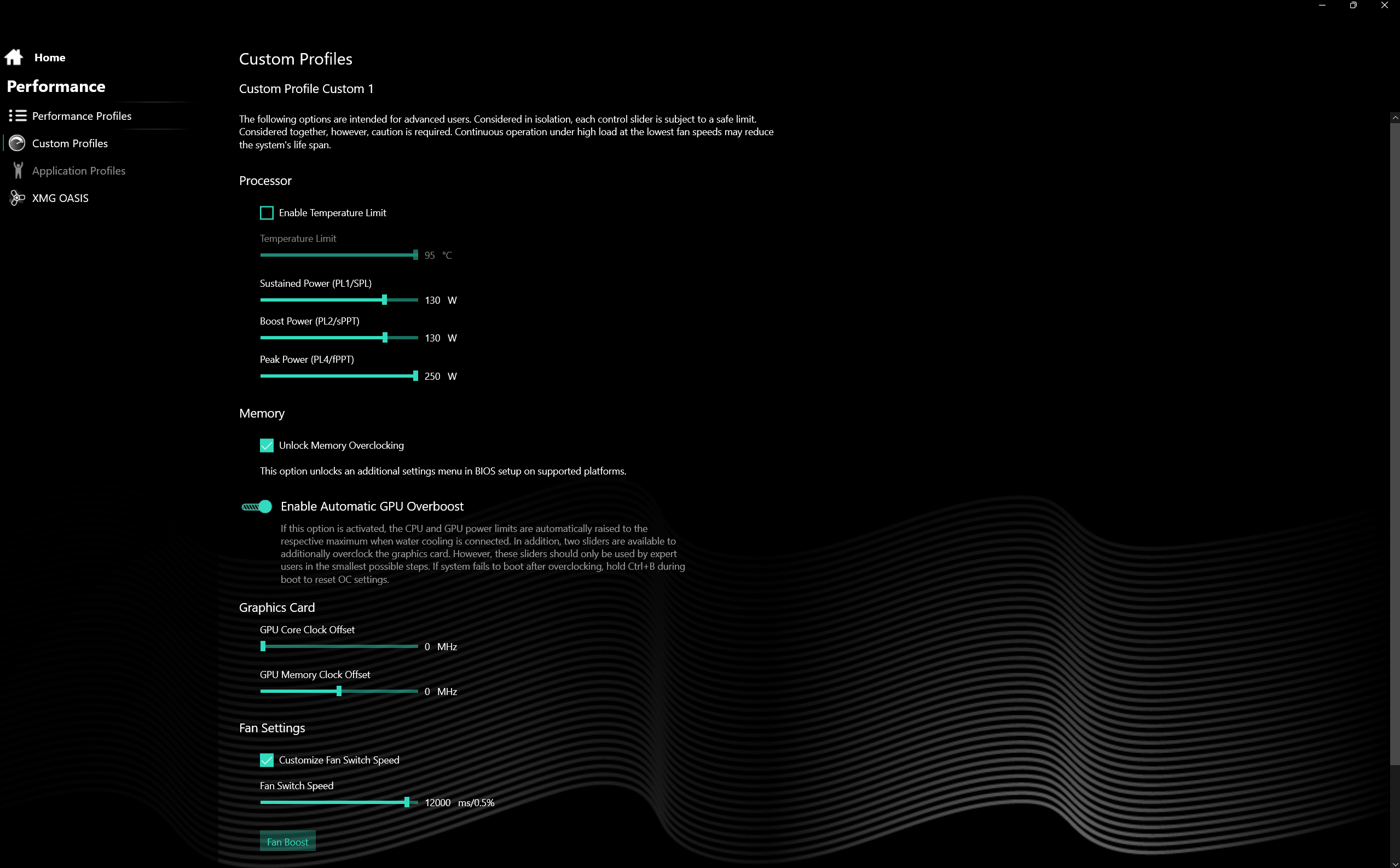

liverpoolchety__
That's the initial release, I believe.
Ask PCS if they have a newer version; otherwise, install that one.
Once installed, you will need to run several tests to find the best balance of performance and temperature, adjusting the power limits based on your requirements.
Those are the only settings I have in the control center app.
Maybe I have to tweak something in the BIOS?

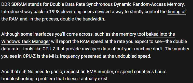

It's explained here: https://www.howtogeek.com/801842/why-is-my-ram-reporting-half-its-speed/
Put simply, it's reporting the correct frequency. DDR means Double Data Rate which means there are 2 transfers for every clock cycle (one for the uptick and another for the downtick), which in your case gives a RAM speed of 5586, just shy of 5600.
If I'm not mistaken, Control Center settings will be saved in the BIOS. Am I correct, @SpyderTracks ?
PL1/PL2/PL4 values are insane, no surprise about thermal throttling :LOL:
Try something like this to begin:
Enable Temp Limit - 85c (or anything below 90c)
PL1 55, PL2 60-63, PL4 115 (even lower)
Deactivate - Enable Automatic GPU Overboost
Fan Switch Speed - much lower than that
Considering that @Paul1964 has your very same laptop, he could suggest more suitable PLs than me :LOL:
Download some stress test software (e.g., Prime 95, AIDA64, Cinebench, OCCT, Furmark) and monitoring software (e.g., HWiNFO/HWMonitor) and run them for at least 10 minutes while reviewing CPU/GPU values. Then adjust according to the results.
