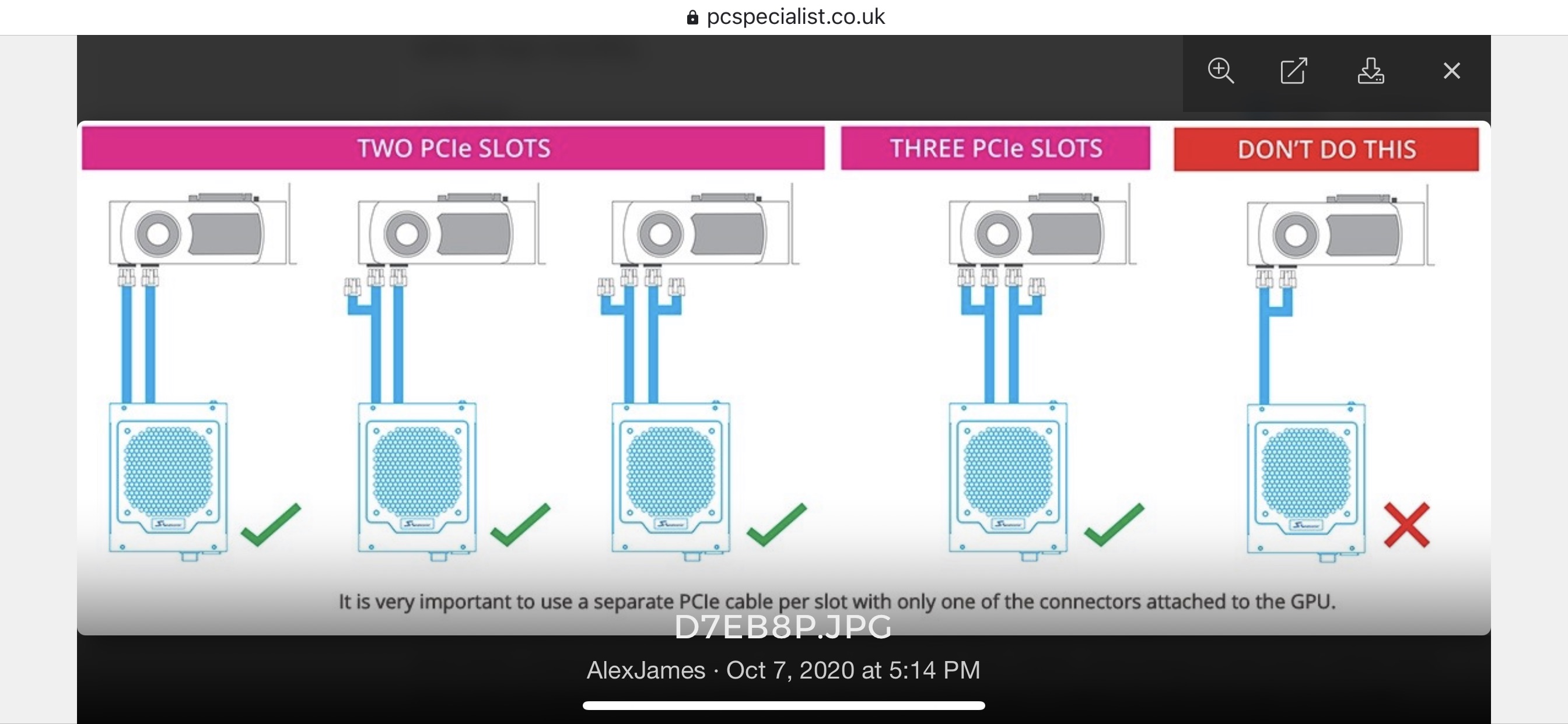

Anyone tell me if this is powered correctly please? Thank you

Ooo, nice, very good choice if a little over the top.
So you should have spare cables in the welcome box. Is the PSU accessible or is there a shroud over it?

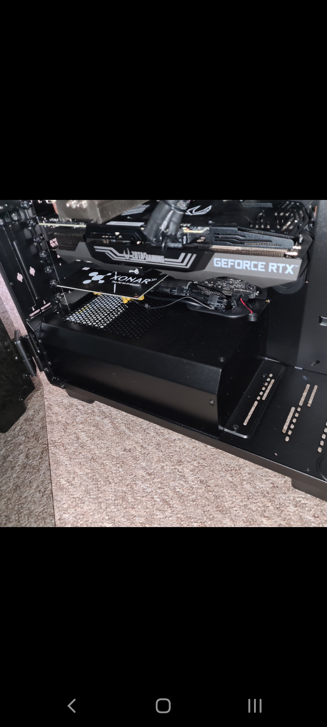

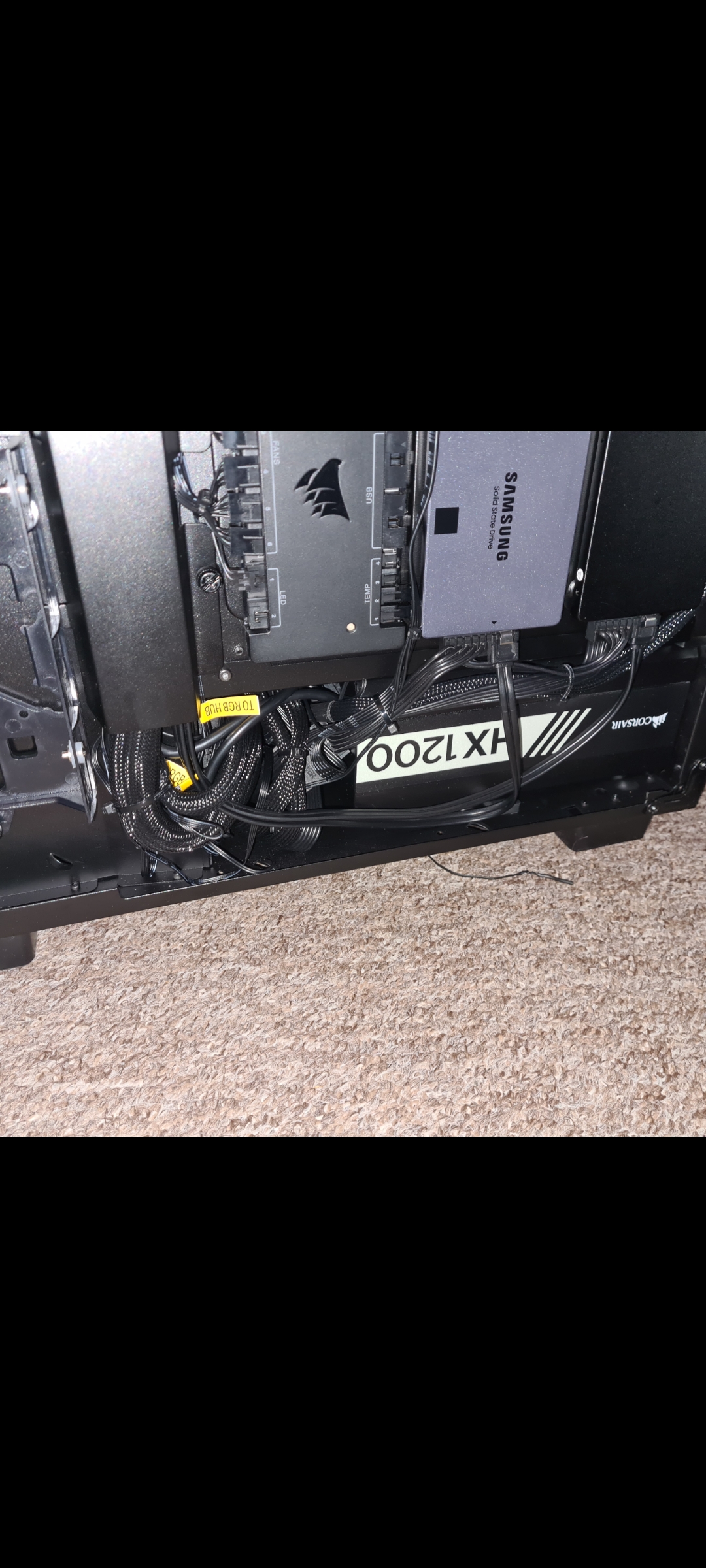

Haha thanks, I had future proofing in mind when I picked the parts 🤣 its slightly accessible from the back but yeah it looks like it has the shroud over it on the front side

Ok, it’s going to be a bit fiddly to get the second PCIe cable into the PSU, the easiest way will be to remove the shroud unfortunately. Then you wanna plug on end into the PCIe output on the PSU, sort out basic cable management and feed it into the main compartment so it just about reaches the PSU. I’d leave the cable exposing side off til the very end otherwise you might find you want to tweak the cable management as a last thing.

Thanks for the help its really appreciated, ill post an update later today with how I get on with it, seems fiddly but straightforward enough 🤣 can I just unplug the daisy chained part of the first cable and plug the second cable in and not worry about the dasiy chained bits? Thanks 😊
Yeah, just leave the secondary daisy bits free, you may even have 2 PCIe PSU cables without the daisy chain extras, not sure.
