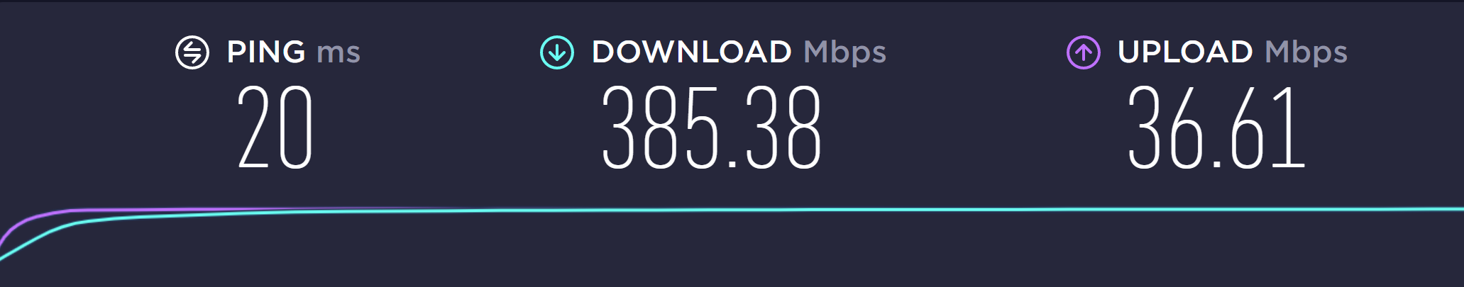

So i moved the pc and plugged it direct to the router using an ethernet cable
Ethernet - 385Mbps
wifi - 22Mbps

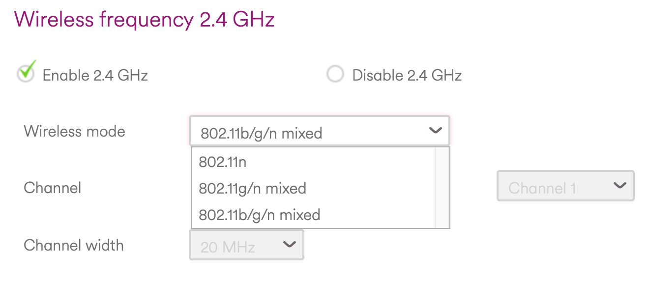

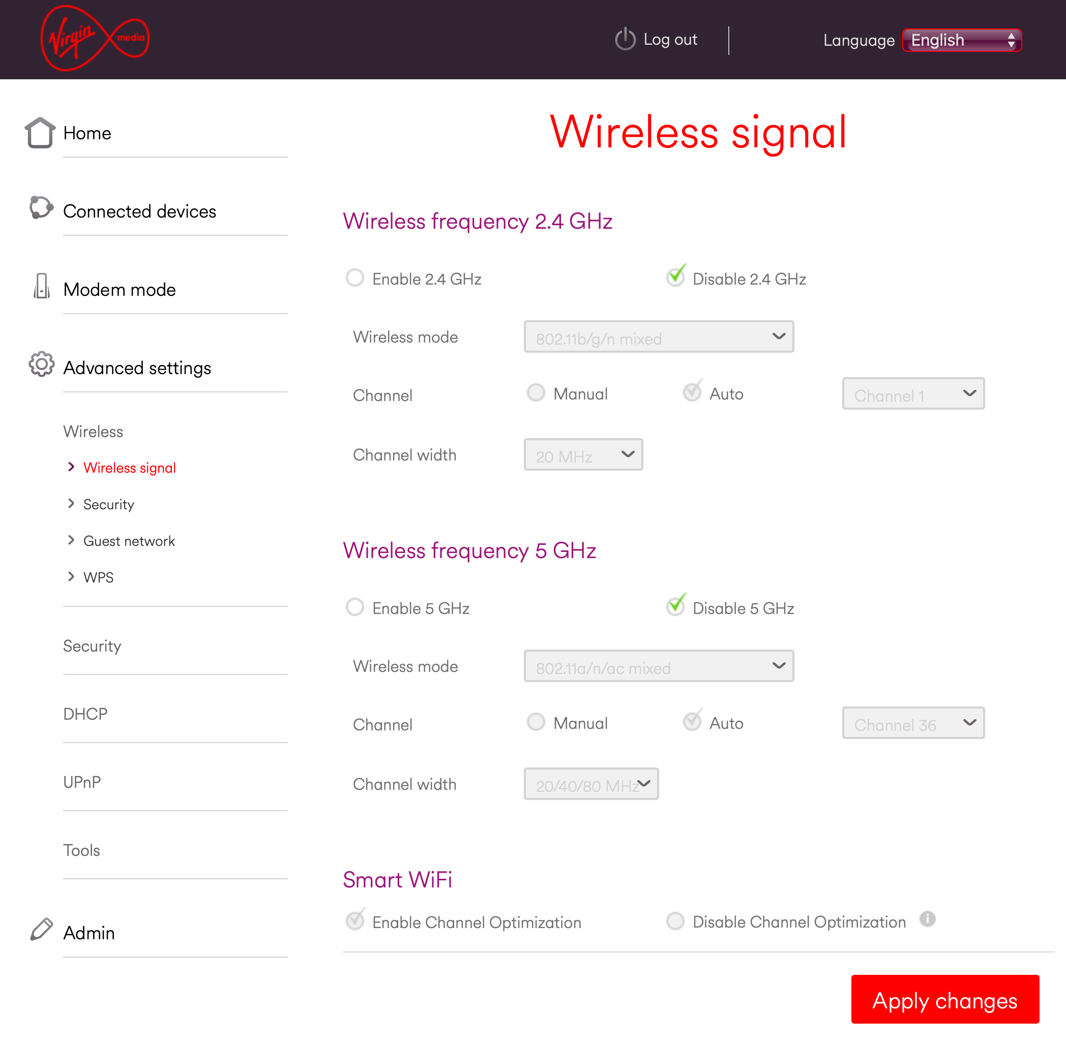

This is the wireless page from my Hub 3.0 (my wireless is disabled as I use power line wifi sockets around the house). I get about 80% of my wired speed via I'm connected via wifi.
2.4ghz set at 802.11b/g/n by default
5ghz seit at 802.11a/n/ac by default
Can you check your settings via [Advanced Settings] > [Wireless] > [Wireless Signal] to see if anything has been changed from default (and also to see if the channel optimisation has been disabled - which is used to find the clearest channel for your wifi signal to avoid interference from other devices).
