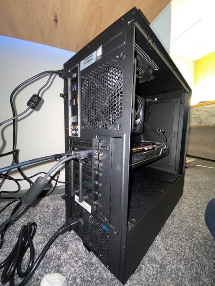

Can you upload a picture of the back of the pc with all the wires connected?
Mitchtenn96
Here you go

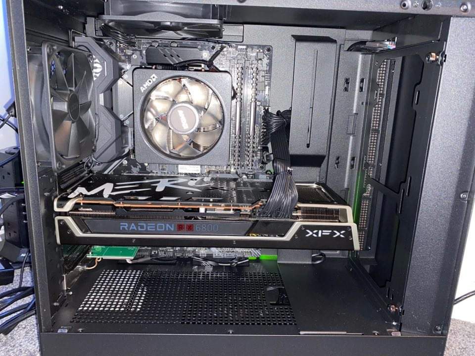

First things first, can you take a photo of the cables that go into the side of the GPU inside the case?
Need to know if it's 2 individual cables, or a splitter connecting to both ports.

Haha no worries 😂 & here you go

Judging by the cable ties it is 2 individual cables
To me it looks like a splitter as I can only see one cable running towards the gpu, looks like they’ve just tied up the splitter portion of it?

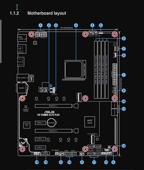

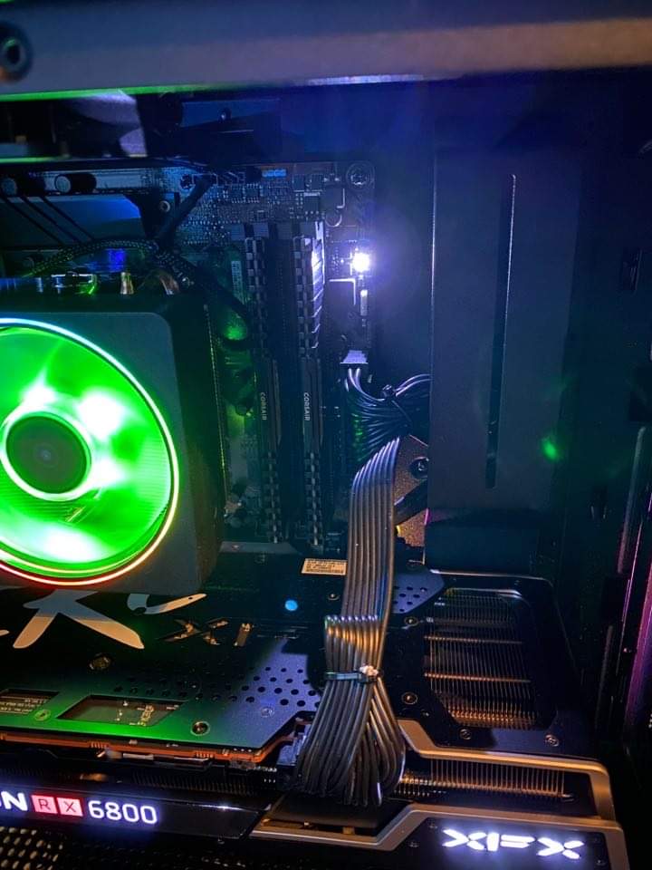

Ok, when you have it powered on, are there any lights lit at point 7 in the top right on this diagram? If so, what colours and which ones?
Mitchtenn96
That looks like this section to me, correct me if I’m wrong. Atm only the vga light is lit white. Although earlier the boot light was lit in a green I believe, and I’ve noticed at times the cpu light flash red for a second and then go off again.

It does appear to be primarily GPU related then.
I would try uninstalling the GPU fully and then slotting it back in just as a final check, but it's very possible the card is dead and needs swapping out.
If you're ok doing that (it's very easy), then you have the possibility of RMA'ing just the GPU rather than the whole machine. In that instance, it's very possible PCS will just be able to post you a replacement GPU for next day.
If you have to send the whole thing back, it's a pain and can take a while.
