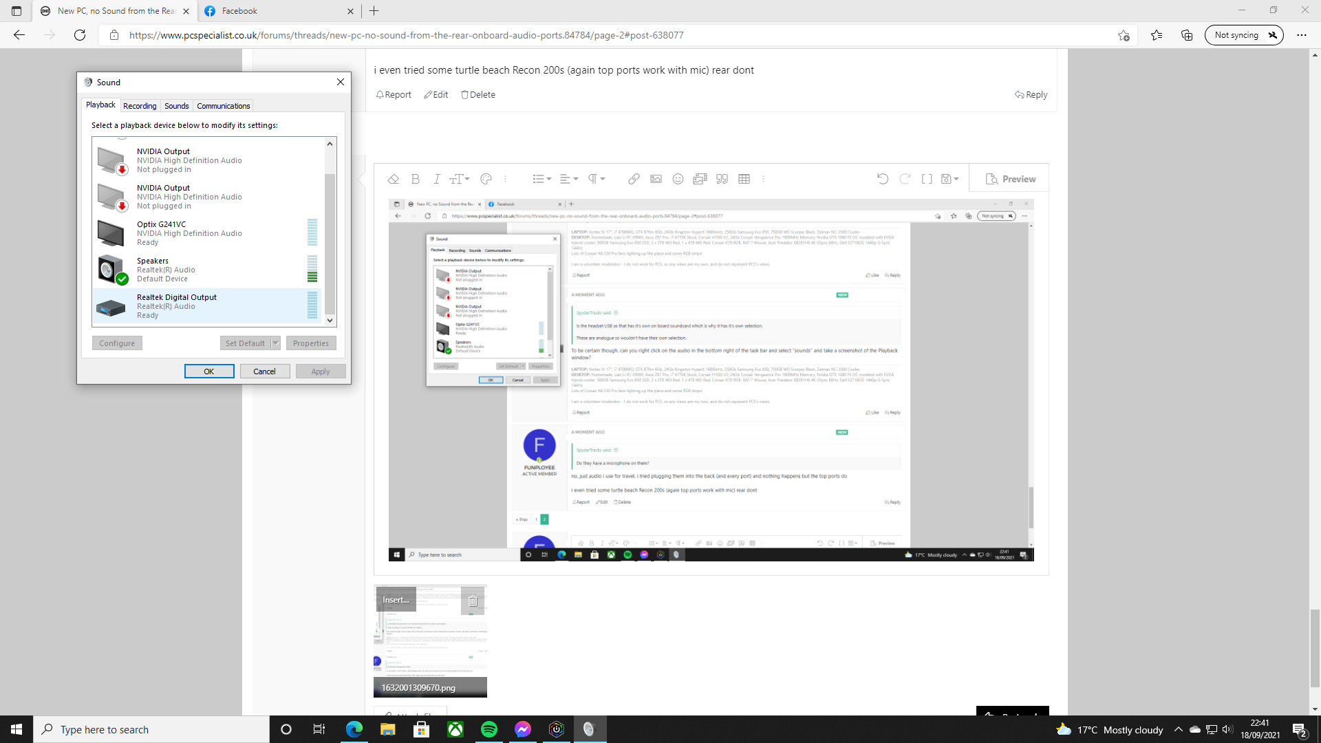

i even tried some turtle beach Recon 200s (again top ports work with mic) rear dont
Again, they wouldn't work out the back without a splitter, so we can't use those to troubleshoot.
You can see the audio is definitely playing out of the realtek channel.
I guess it's possible that it's a failed port on the motherboard, but I've literally never ever heard of that happening before.

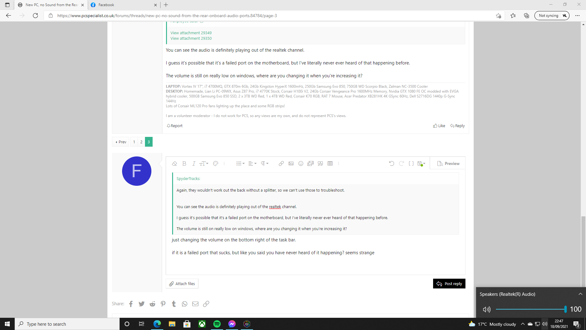

The volume is still on really low on windows, where are you changing it when you're increasing it?

just changing the volume on the bottom right of the task bar. right now I have put it back to max (see Screenshot) still nothing
if it is a failed port that sucks, but like you said you have never heard of it happening? seems strange
