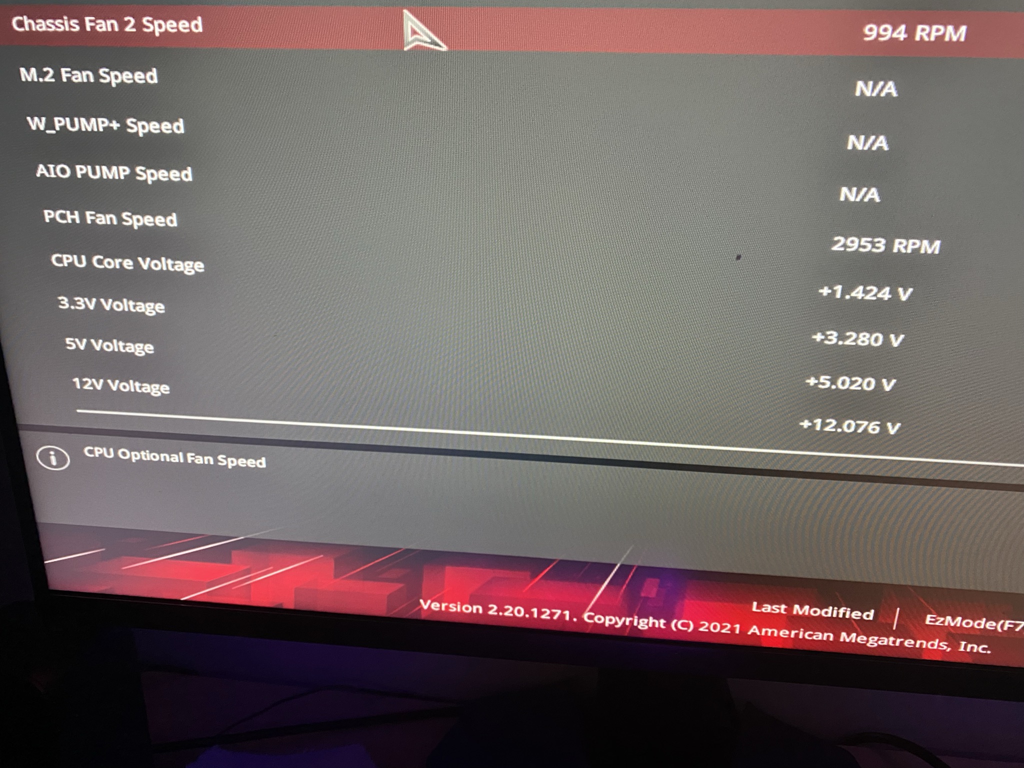

Help pls.
So basically I was sitting idle on chrome and heard a windows disconnection sound , I turned over and looked at the pc and the AIO pump LED was miss matched. I then loaded up ICUE and saw the pump when down to like 0 for a second but then it went back to normal rpm however LED still was not the same and was not responding to any colour changes. I then tried doing the firmware update for the icue h150i xt ICUE that was showing but it took too long and failed and aio fans when to 100 % load during the update and stayed at that speed. So I decided to restart the PC , where then I received the error. I then checked the pump info which showed that error , i then loaded into windows where then I heard the windows disconnection sound again but this time the pump info was not shown on ICUE at all and AIO fans were on 100 %.
My assumption its something do to with firmware of the pump and windows so how do I fix it?
Thanks for any help
avenge_420
Hi I fixed the issue regarding this failed update of the pump and everything with it and wanted to write here the fix if anyone has a similar radiator issue in the future. Apparently its always recommended to go into safe mode of windows when updating using ICUE. The video and the link for the hex file for fixing the specific model for my case.
