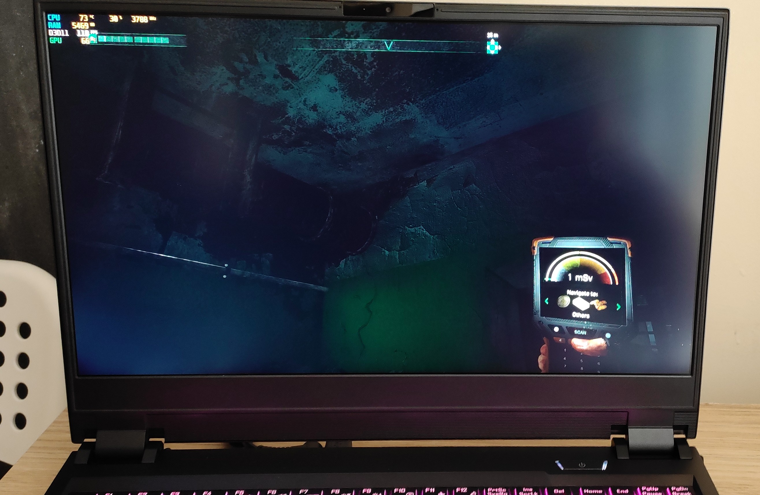

hmm this one is quiet visible unfortunately in the daylight as well i dont mind the small bleeding but in this left bottom corner is too much :/ (the rest is glow)

agreed, if it's so visible in daylight then I think you have grounds to ask for a replacement screen.

other than that Im really happy with it but I will email pcs regarding this black bleed
If you’re at all unhappy with it then raise it with PCS, don’t settle as you’ve paid a lot of money and it needs to be up to par.
I would agree, I think that’s too much. Sometimes the bezel is fitted so it puts too much pressure on the panel and contributes to this, sometimes it just takes an adjustment of the bezel frame to correct, but do raise it with them.

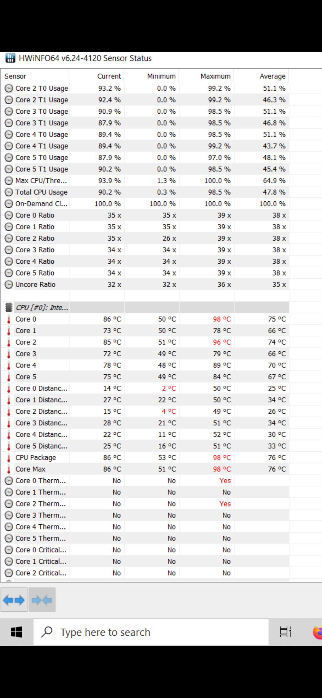

guys unfortunatelly I would have to return this unit not that backlight bleed is pretty bad but cpu temps are unacceptable reaching 98c on stock cpu settings just running cinebench not even gaming and then underclock to 3.8ghz with -141mv gets me around 97-98c as well and laptop is on rubbee stand inch or two from the table, will phone pcs today as they advised me that laptop will need to run some benchmark, gpu is running super cool through
this is pic with stock settjngs and another one with undervolt after light gaming

Probably just needs a repaste which you can do yourself if you feel comfortable?
yea i know but i would expect it to work better to be honest that wouldn't be a problem i could do it myself but because of that back bleeding laptop still would need to go back

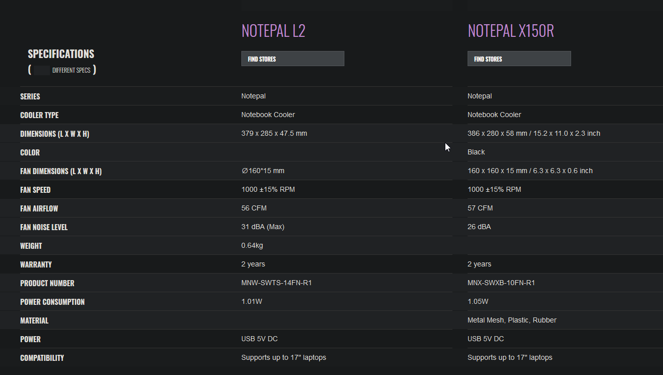

Btw what cooling stand would you recommend? i was looking at a notepal X150R or would nptepal L2 be better option? also for a gaming keyboard i was looking at roccat sura FX or hyperX hx? thanks
The X150R is a tiny bit more powerful in airflow, but significantly quieter, personally I'd go for that.

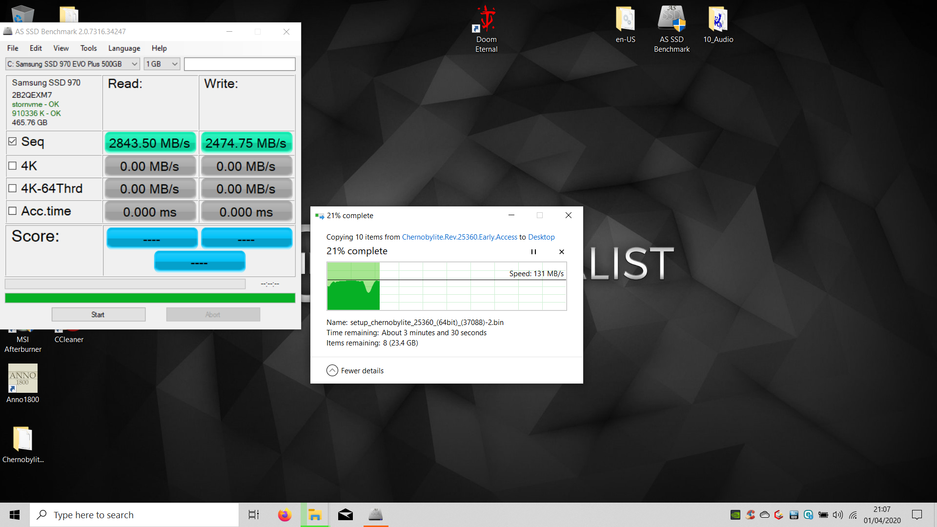

i just have a small problem, my nvme max write and read speed are slower, or benchmark are actually good showing good results? i only updated chipset, center control and nvdia drivers
