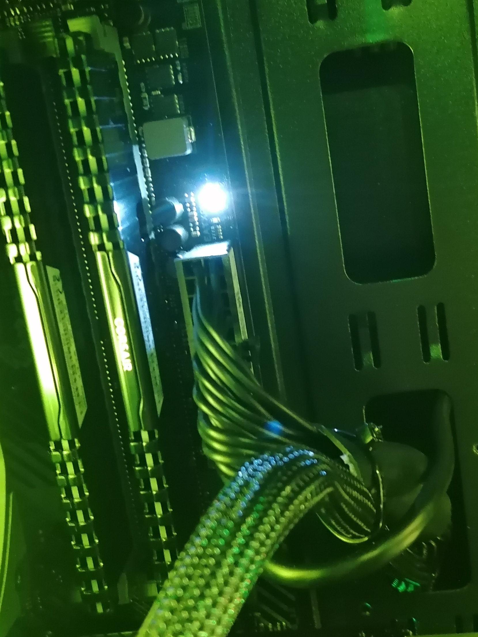

It hasn't been asked yet: On the motherboard, to the right of the RAM sticks, there are 4 LEDs (they are quite small)....are any of them lit when the system is turned on? Just wanted to check that the VGA LED (second one down) is lit...I ask as sometimes flaky RAM can create havoc with systems and can create display issues...if the bottom most light is lit, then it's RAM and so I'd suggest popping the RAM sticks out and then back in again (I'd do that nayway just in case)
There is a white light on next to the RAM...
See the photo below- the white light is right next to that green one, but was too bright to take a photo without the cable in the way.
It's the 3rd LED along, if the green one is the fourth...I think?

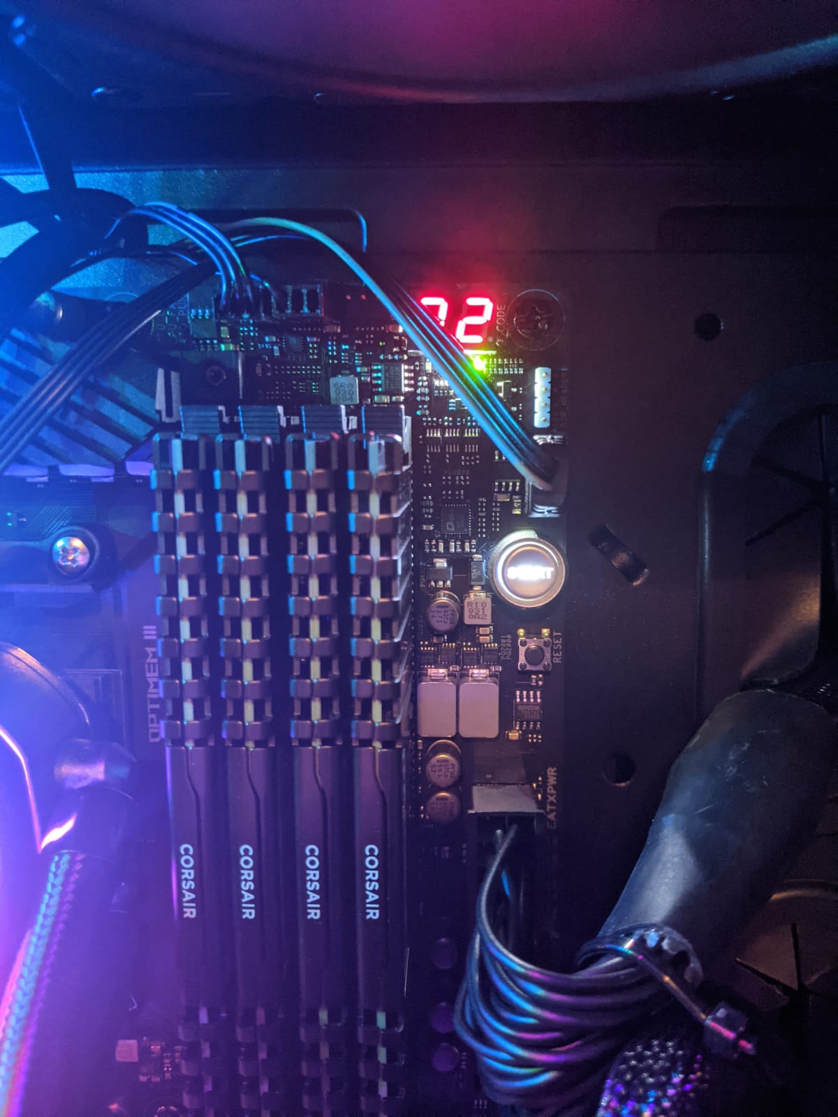

Judging by the picture you posted, that is the Crosshair Hero VIII motherboard? If that is the case, then yours may well be a completely different problem as, while the White LED indicates a VGA issue (graphics), it is also indicating a Boot issue (the green one)...one or the other could be affecting it. I'd suggest starting a new thread as I think yours may require a different solution (not guaranteed but maybe). I would also suggest noting the number in the digital readout just above it as all I can see is the 2 but not the preceding number as this may indicate where the issue lies
Ah ok, thanks that's really helpful. I'll start a new thread. The message is 02, if that helps?

Spent an hour on with tech support just now. They got me to take out all the ram, SSDs, graphics card, even the motherboard battery and I still got the same error (Q code 02 and VGA and boot lights on) and now the PC is off back to Leeds :-(

I do have a white light on but I have no idea which light it is. A green light appeared briefly but it went off after a maybe a second
Shakko
It was indeed the graphics card that was the problem so I'm going to need a new one of those sent out. RAM and all was removed, tried it with the other graphics card from the old PC and it worked fine
