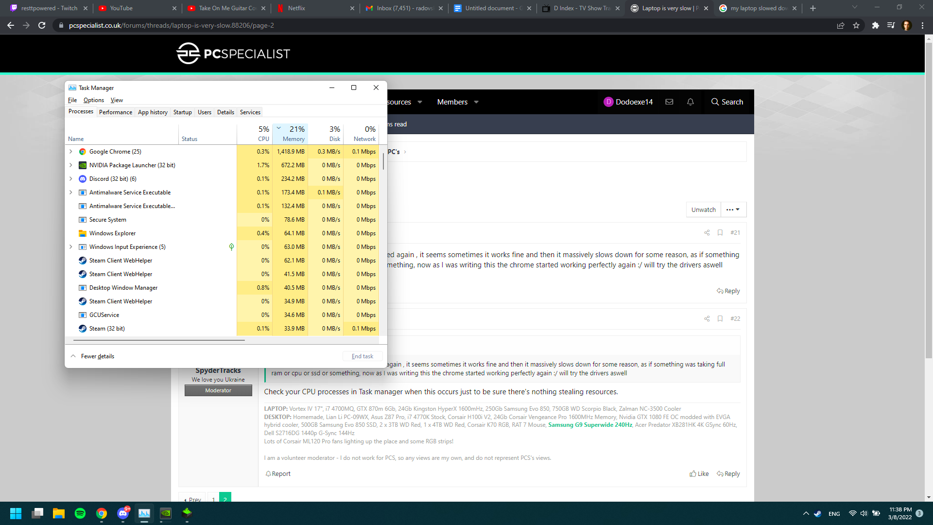

Check your CPU processes in Task manager when this occurs just to be sure there's nothing stealing resources.

Nothing is really jumping up except chrome but its not taking as much, there is also antimalware service executable in top 5 is that something I need?

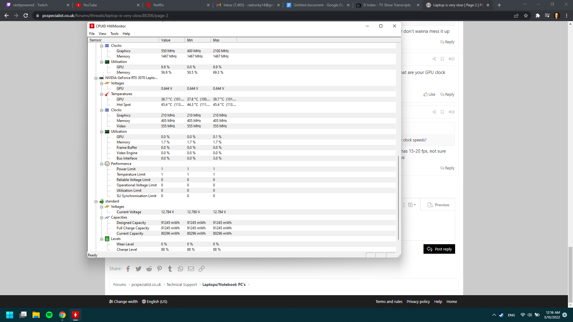

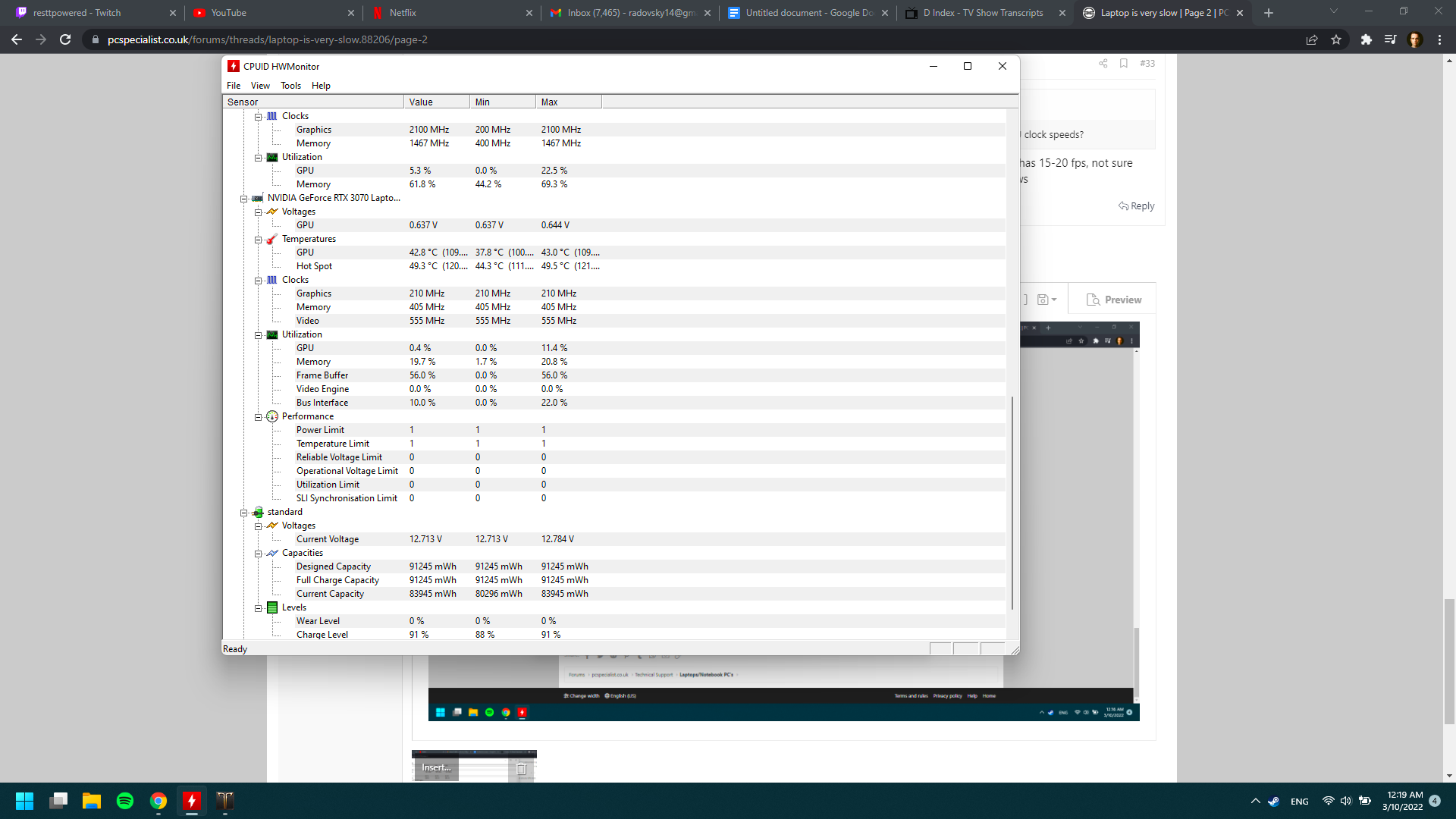

Just out of curiosity, does it get as slow when you're not using the Nvidia GPU exclusively? Also, when you run a game, what are your GPU clock speeds?

Now when I'm not playing a game, chrome, discord etc seems to work fine, only when I play game I guess using nvidia it has 15-20 fps, not sure whats clock speed, also today my whole laptop froze when I was watching a youtube video, still havent reinstalled windows

It is what I meant. It looks like your clock speeds are stuck. Here's what mine look like:

top one is without game bottom after I turn on the game, not sure if this is what you mean

The two screen shots you have posted, to me possibly suggest the game is being run off of your iGPU instead of your Nvidia card. This would explain the poor performance.
