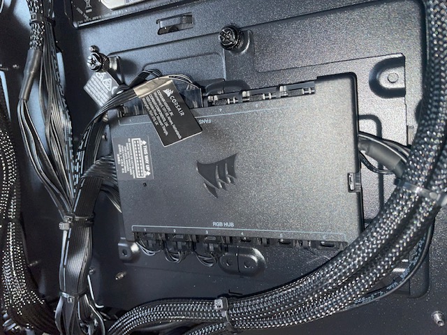

Looking at the commander core, there is a cable missing from temp, cant see anything nearby that could have fallen out.

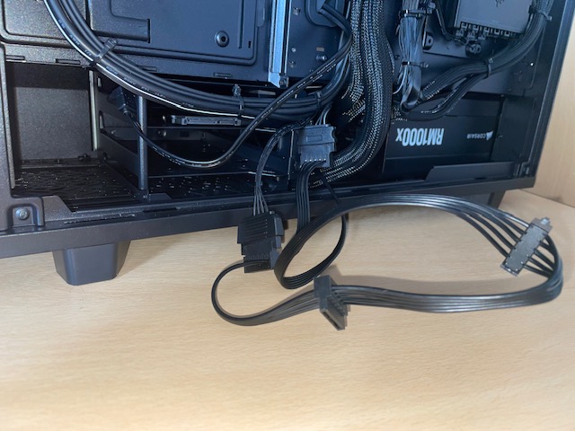

The sata cable that I pulled out i took a picture of too, disconnected both of the things plugged in and reconnected, think they were fine though.

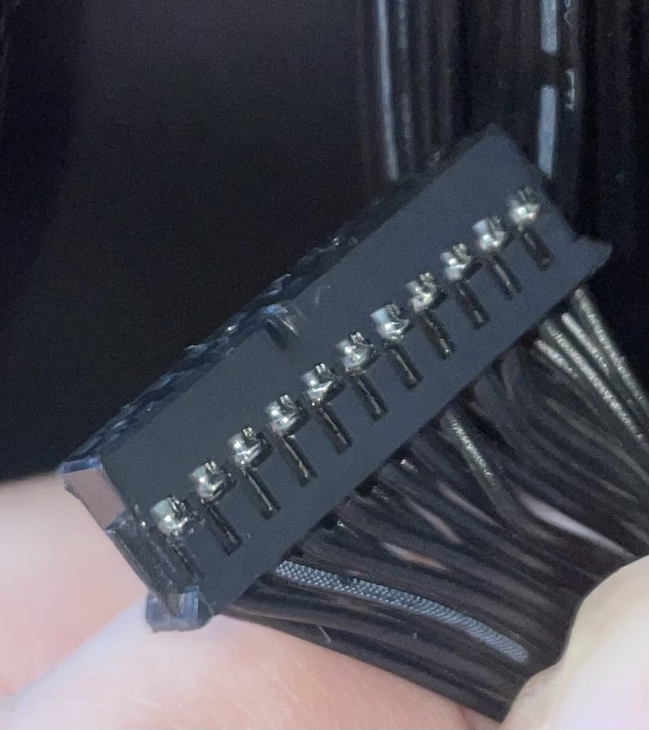

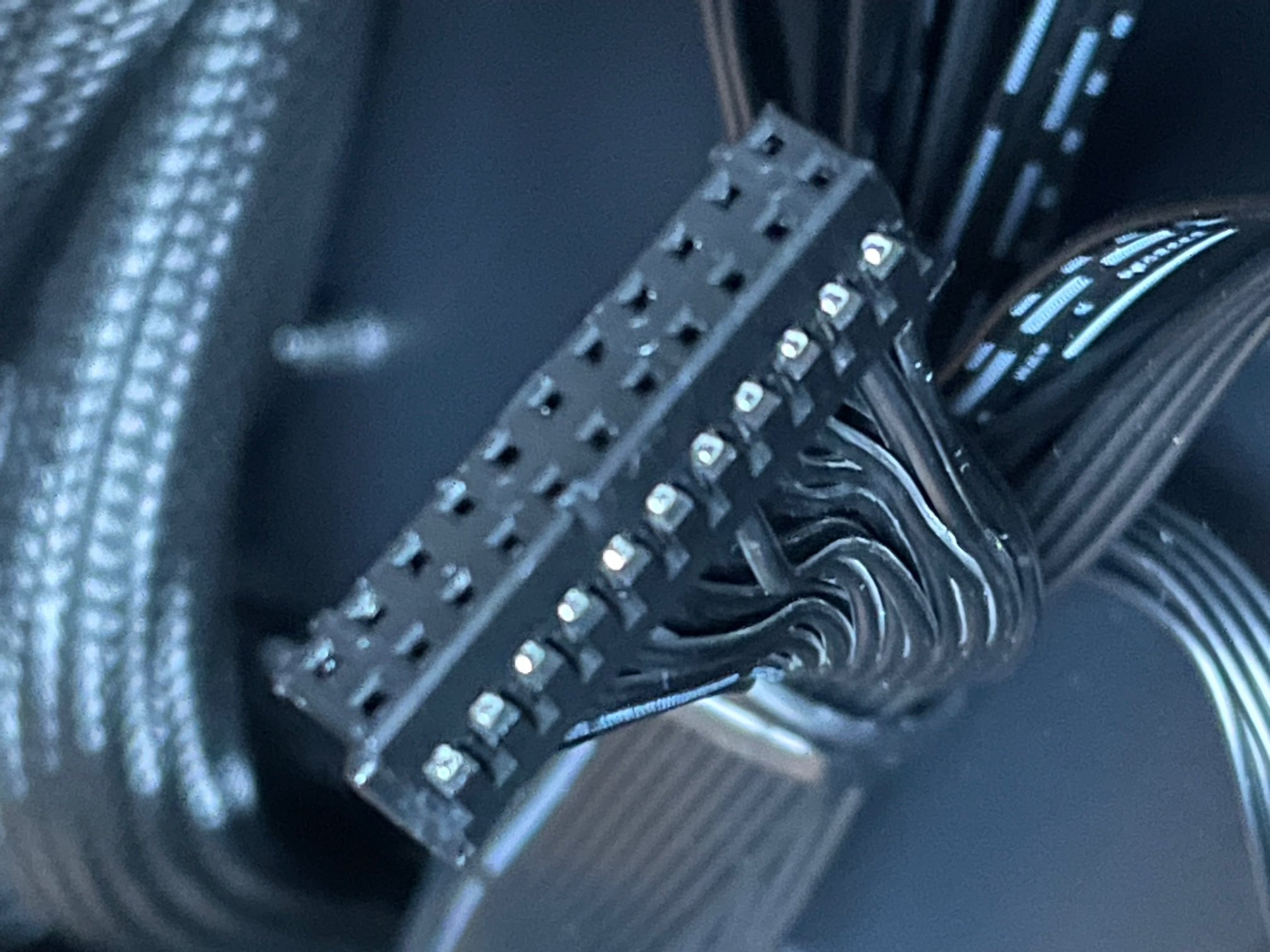

Got the 24 pin out… maybe looks abit damaged to me? If you look in the middle on the side of the silver pins.. What do you think?

Temp will be empty, that's fine. How many items do you have connected to that SATA cable? Just the commander?
Hard to say, photo is a bit out of focus, but I don't see anything immediately obvious

Yup, i used one of the spare ones for my ssd, which i assumed would be fine.

Maybe better angle, you see its dented? I don’t know if thats normal

Think that's just a notch to align the cable with the port on the Commander. If all the connections are secure, then it's a pump failure, so best to contact PCS for an RMA. If the process is same as the Discord user's then they'll send a replacement AIO via courier and you give them the radiator and pump when they deliver. So you won't be without build for long.
